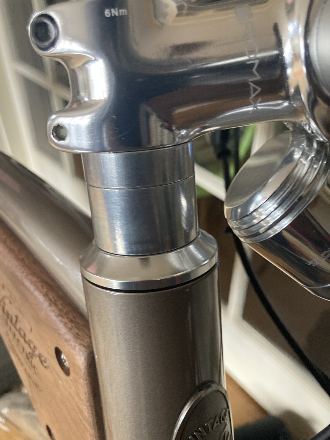

Hello,
I have a Vintage Electric Cafe. I’d like to raise the handlebars by maybe 1.5-2 inches to get in a bit more of an upright position and decrease the reach. I already have the seat forward as far as it will go and the seat is positioned correctly in terms of height (I have long-ish legs and short-ish arms for my overall height of 5’9”).
I am a complete newbie to bike maintenance/upgrades, but I figured out how to raise the handlebars by unscrewing the locking nut on top of the stem. The issue is that that leaves a gap between the bottom of the stem and the top of the tube. That gap strikes me as problematic because it’s unsightly; it will admit water; and it seems potentially dangerous, in that the handlebars might slam down to close that gap.
Both my local bike shop and Vintage said I should get a new stem that’s longer (like this one:
But aren’t there also rings/washers/spacers that could be used on the existing stem to raise it? If so, wouldn’t that be a simpler solution? And how do I find which ones would fit?
Or am I missing something and I really do need to replace the entire stem in order to raise the handlebars?
Thanks for any insights!

You can lower it by cutting the fork steerer and remove the 2 rings, but it's impossible to extend the fork steerer tube without an additional raiser. You can look for foldable adjustable longer stem like this...but it's ugly ! Replace your handlebar ....
I changed handlebars on my Ruffian to relieve back pain. I found a narrower and taller bar so I got the lift I wanted and all the brake hoses and wiring were just fine.
To do exactly what you are asking, the stem riser is your only option... that is unless you want to replace the fork with one with a longer tube.

If I am understanding right, you raised your stem and it is no longer against the spacers????? If that is correct, do not ride the bike!!!!!!!!! Take it to someone that can correctly adjust the headset.
You won’t have enough steerer tube to safely clamp onto if you simply add more spacers beneath the stem. For the sake of your own safety, please take your bike to a mechanic.

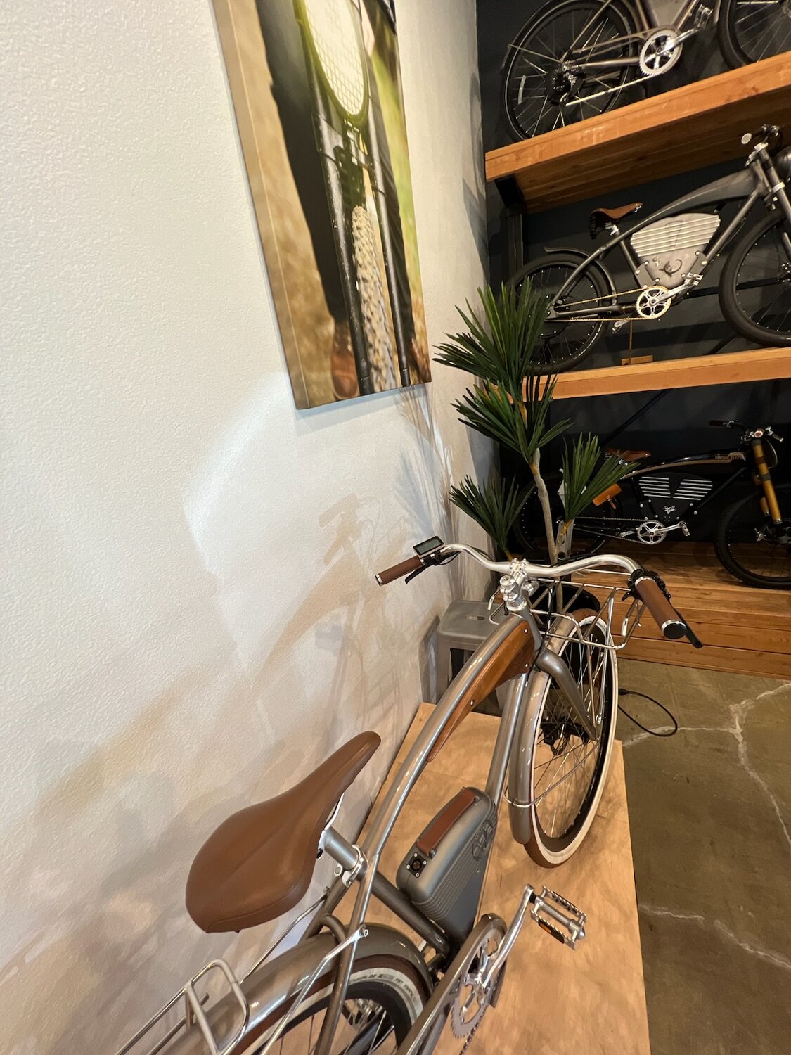

As noted above, I need to raise the handlebar height on my Vintage just a bit in order to decrease the reach/how far forward I need to lean while riding, because the reach and positioning is currently such that it puts significant strain on my lower back. I basically have two options:
1. Get the brake lines and electric cabling extended by a few inches so that the existing flat/straight handlebars can be raised by the corresponding amount. (They have a very small backsweep, but basically are straight).
2. Get the new handlebar that Vintage now has available, which has much more of a backsweep (picture attached).
I lean toward #1, although it’s more complicated than just changing the handlebars. I already have another bike that has swept back Dutch style handlebars that allow me to ride fully upright, so I’m not looking for that from the Vintage bike. But then again, the backsweep and rise of the new Vintage handlebars pictured in the attachment isn’t as dramatic as the Dutch handlebars on my other bike (a LeMond Dutch).
So, I’m struggling with the decision on which way to go. I like the greater steering control and stability that I at least feel on the straighter handlebars, as well as the great ease of riding while standing when necessary going up a hill. But if the more swept back positioning of the new handlebars would be better for my ultimate goals - which are to decrease lower back strain from extended reach - than just raising the existing handlebars, then I’d certainly consider going that route.
Appreciate any insights!

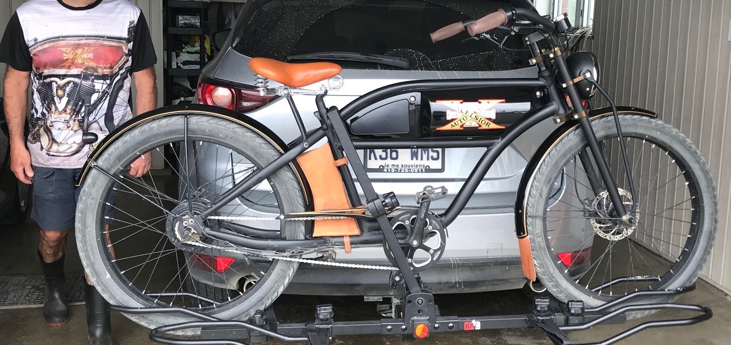

Take a look at those 100+ "true" vintage road motorcycle will help you make your choice.

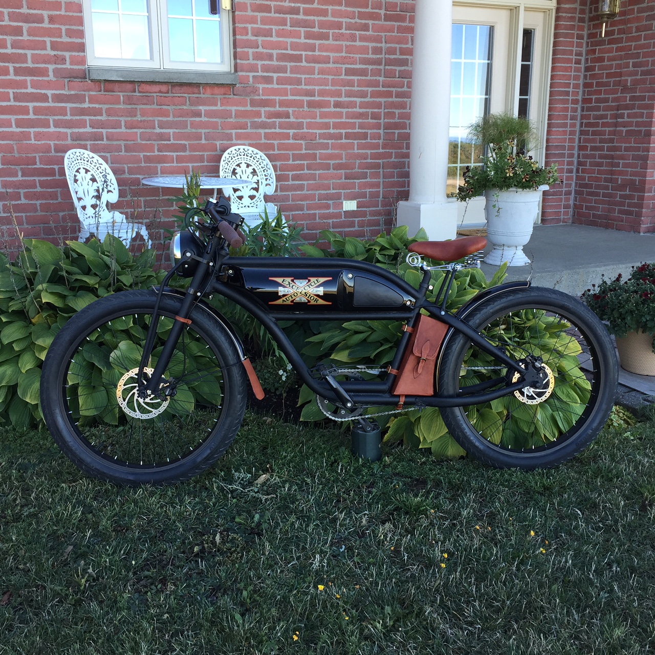

One of my vintage electric bike, before and after. I did it for the same reasons, to save my back.

Bike fit is tough to do without being there in person. What would be best is a picture of you in riding position on the bike, taken from the side. That way we could look at your trunk and shoulder angles. If your back is hurting, you probably have too small a trunk angle and too large a shoulder angle. But, not necessarily.
This is a good article on bike fit.
That said, there's a lot of personal preference involved in handlebar grip location and angle. The backsweep thing, for me anyways, is mostly about wrist angle. See this page. Angling the grips even 10º helps a lot with that - you don't necessarily need a full backsweep.
One (obvious) thing I will point out is that if you move the handlebars higher without moving them closer, you will need to extend your cables no matter how the grip location got changed (stem riser, handlebars with more rise, angled/taller stem).
