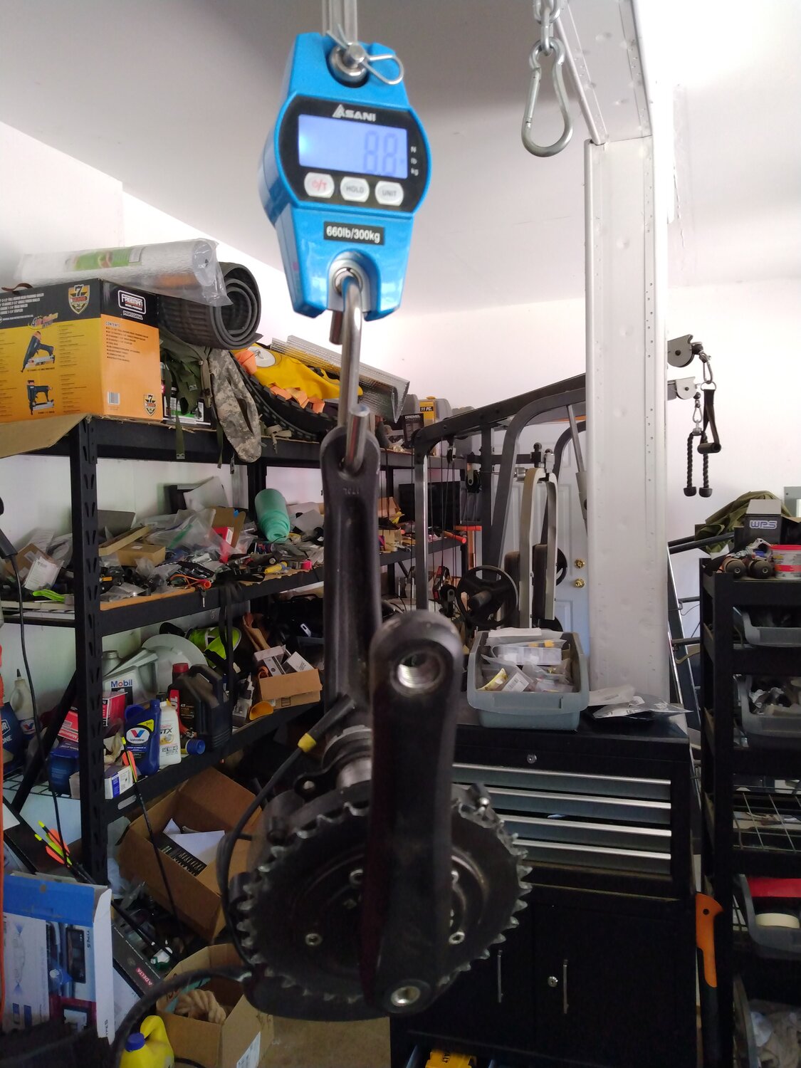

I have 500w 36v and 750w 48v versions of the TSDZ2, which on paper sounds same as Toseven rather than less powerful (?). Both are good performers but the 750w provides significantly more assistance if/when needed. Neither has run hot for me even with long steep climbs. I live on a mountain.
A low power mid drive has good climbing ability thru the gears ... goes anywhere a normal bike/rider can go and has the advantage of keeping the bike light.
That depends on your definition of "light". With chainring and crank arms TSDZ2 weights 8.8#, plus battery (minus weight of crankset/cartridge you remove). Easily 14# added weight to the bike, more with bigger batteries.
If the Toseven is 500W as advertised and doesn't wear out like a Tongsheng, it ought to be a fine motor candidate.
What wore out on yours? I don't remember the miles on mine exactly but I'm pretty sure well over 2000 miles on the 48v version and well over 1000 miles on the 36v. No problems or noticeable wear with either although neither is currently installed because I dislike the weight.
