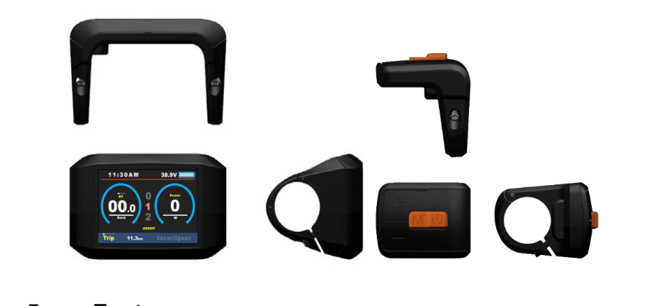

I have a APT TFT 750C display.

On the last page of the 750C display manual, you can see that 5 levels maps to assist levels 2, 4, 6, 8, 9. I'm willing to bet WW didn't bother with any custom programming and you are missing out on the lowest assist level. I say this because they didn't bother with my custom programming request. With 5 levels, you are reaching assist level 9. You cannot access Innotrace level 10 with that display.
I suggest trying 9 levels and see if assist level 1 provides a better leisurely ride.
I have a 750C, chosen for it horizontal layout and very easy to read watt meter. Try it, and observe the wattage used when using PAS 1 both ways. I have never used PAS 5, but my bet would be PAS 5 and 9 should very close to the same.
In any case, you can set it up to your 'druthers pretty easily. I use the 1-5 setup, and even programmed PAS 0 for a very low level of assist as I have no use for it otherwise.
I don't think the 750C has he "ECO" and "Sport" red/green mapping available on it.
