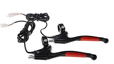

The feature is if the brake lever is broken the motor will not engage. I read the manual and it make no mention of this.
Just wondering if this was common to most ebikes.
Also customer support is not very good for IGO.
I'm assuming this is because it assumes that the brake lever is pulled if the break is broken. for the same reason if you pull the brake it will disengage the motor
It's a side effect not a feature.. It's because the handle goes limp causing it to not stay open which triggers the motor cutoff. But it's not a fail safe because if the break handle is open the whole way then it wont cut off the motor.

Things are more expensive in Canada, I used to buy these from China for under $12 shipped. Look around for something that matches your connectors.
Amazon.ca link
I already replaced them. The point is that the
Amazon.ca link
Alredy done. That is not the point. The bicycles are still under warranty, they are 3 monts old. BTW. the head office for IGO is 10k from my house and they dont even answer the door. It is a good thing I’m good with tools and can fix things but hat happens with people who are not manually inclined?
