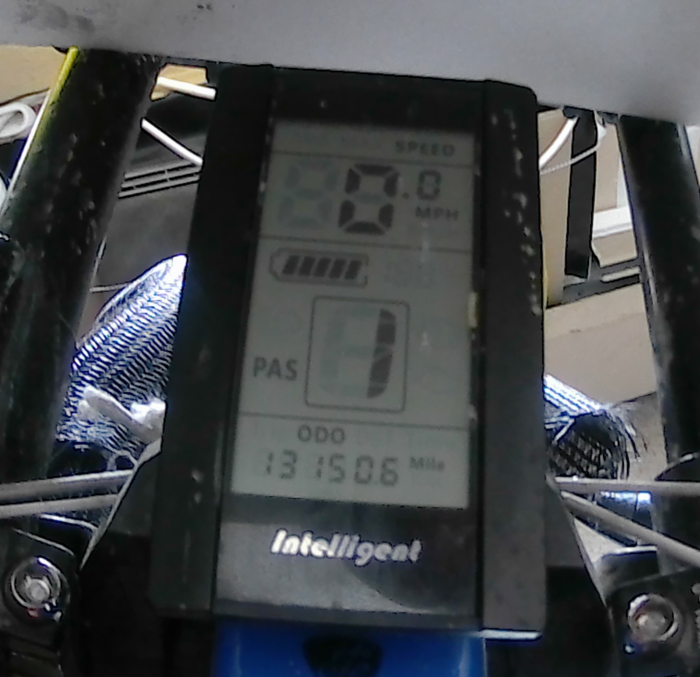

[#13] [M2S] My 2019 R750 at month 31 and mile 13,150.. plus, a battery item..
