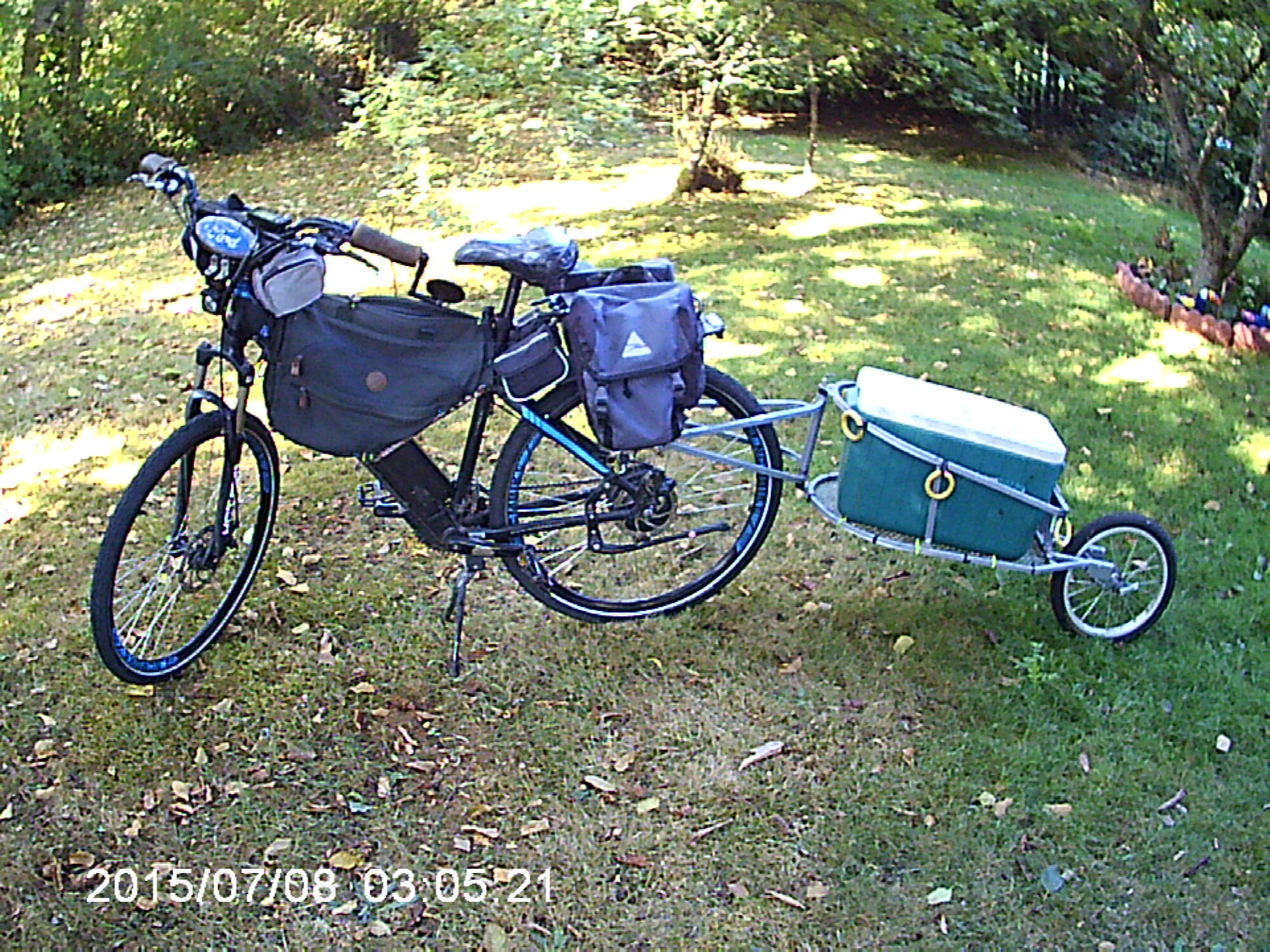

If it´s an axle mount trailer with a duel swing mount, I made mounting pieces attached to stays
above the axle with bolts passed thru titanium strap instead of the nuts for the quick release. I
hate axle mounts of any kind & consider them dangerous. They are also very inconvenient if you
have a tire issue. you need 2 nylock nuts for each bolt, one to lock the bolt to the strap & one
spaced out to accommodate the trailer hitch. PICT0002.jpg P.S. you can also find
20cm x 10mm axles online in ebay or amazon.

Yes, they are meant for axle mount; the one in pic has special mounts I´ve made. Unfortunately
Im having to use the axle mounts on my current project,(hybrid gas/electric bike), because there´s
no other way if I mount the 3 liter fuel reserve.

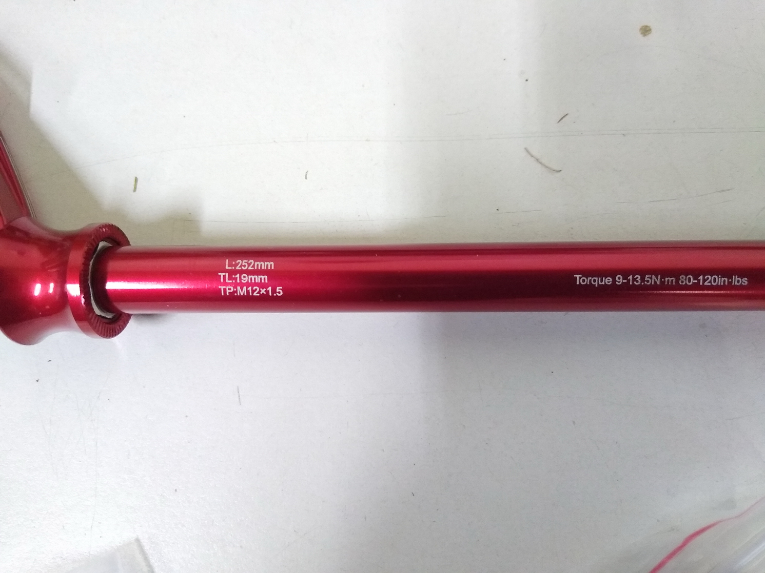

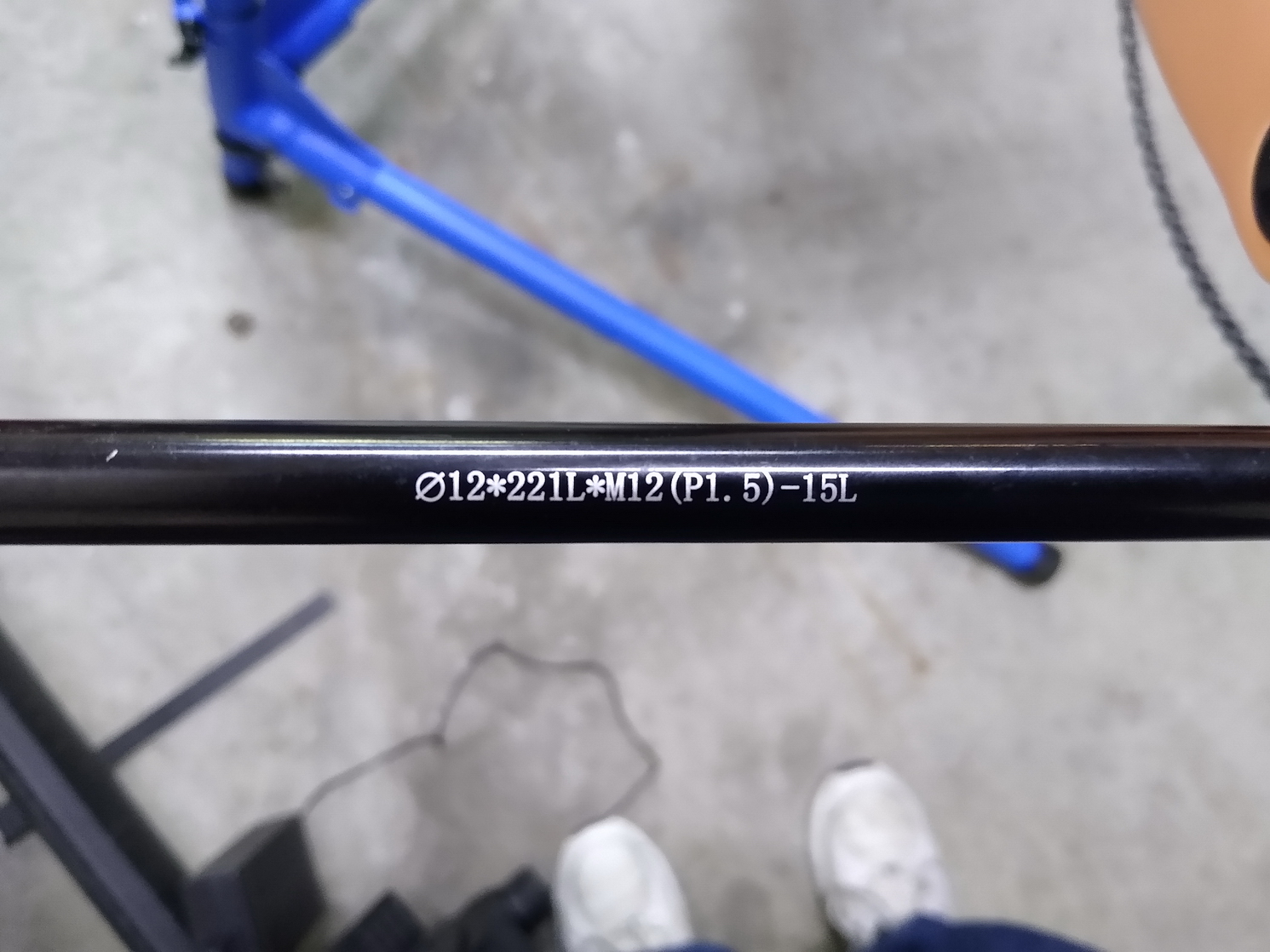

197mm is you hub width, your axle will be longer. The first thing you need to do is pull your current axle out and look at it. Quite often the size is printed right on it:
There you can see the total length, thread length and thread pitch. You can then go to here: https://robertaxleproject.com/?gcli...Rh46X-QQAwwz7D60mxObsZqaYTV1O5BoC814QAvD_BwE#
If the dimensions aren't written on the axle, you can measure them. I think there are instructions on the above site. Look through the kits they have for a compatible axle size. If you aren't finding something you think will work you can send them an email and they can usually help you out if you have the needed dimensions. For my E06, I was able to use one of their existing kits with an axle just slightly too long, simply using a 2mm washer to adjust the axle to the proper length.
