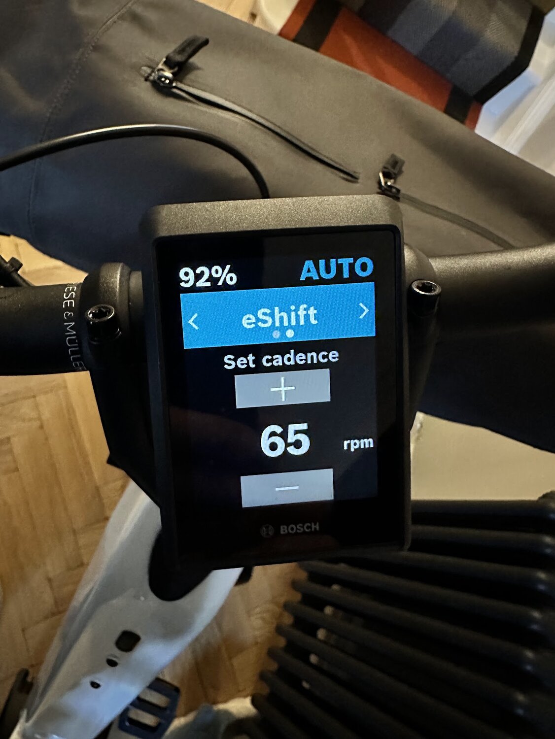

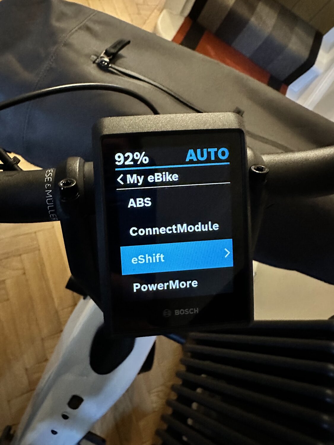

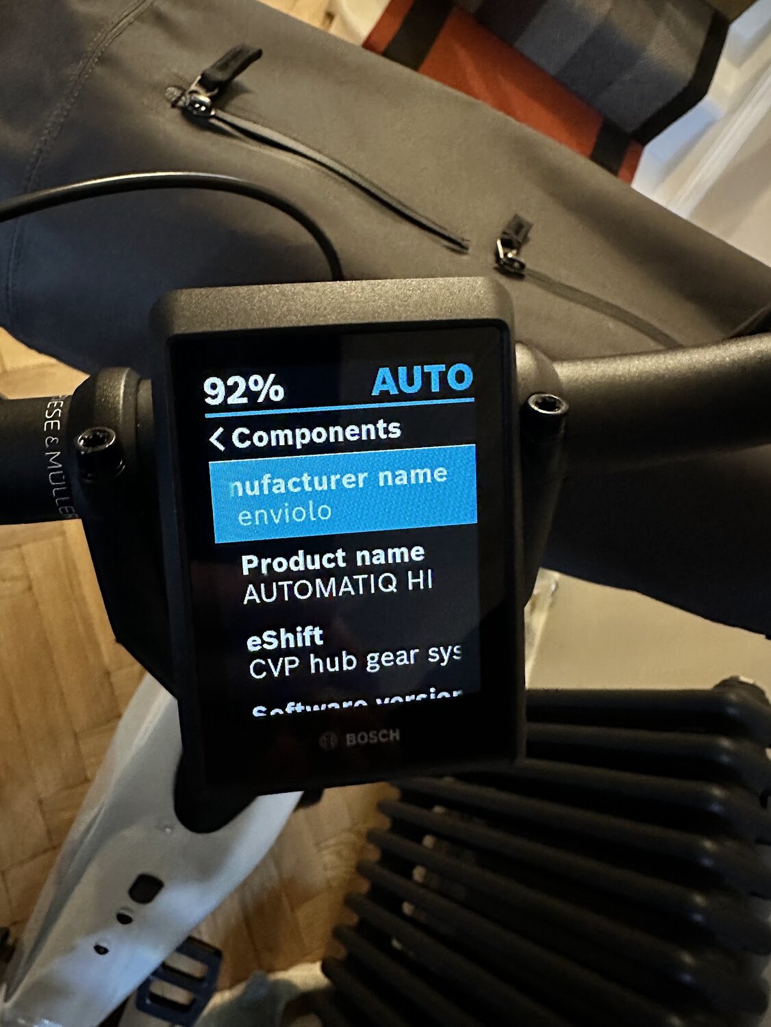

So I was set to buy a Homage4 and have tried out all the gear systems but was still slightly unsure which one. I had a test drive on the new Nevo3 Automatiq and I loved the system and not having to change gears and just cycling around enjoying the world was amazing and knew this was the gear system for me.
I asked my bike shop edemo if they could retrofit the Automatiq to the manual Enviolo option on the Homage4 Vario.
They contacted R&M who were happy to enable the e-shift integration on the smart system with the Enviolo Automatiq on my new Homage4.
They’ve done a manual->automatiq conversion with full Bosch integration and the cadence is configurable via the smart system.

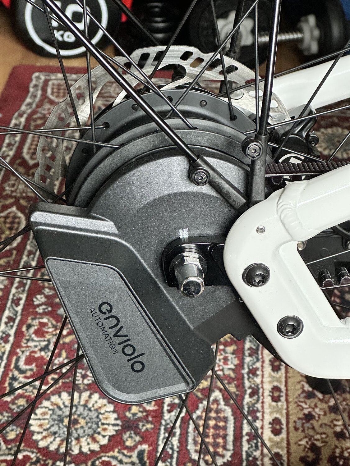

There is a slight issue installing it due to the read wheel is configured and where the wire comes out of the Automatiq unit (I suspect this is the reason that this option is not offered on the Homage4) which means the unit is installed sideways. (See picture)
I imagine this would be unacceptable to some people but it doesn’t bother me and I’m happy that I have the automatic gears!
So it is possible and R&M seem to be OK with enabling the eShift.
