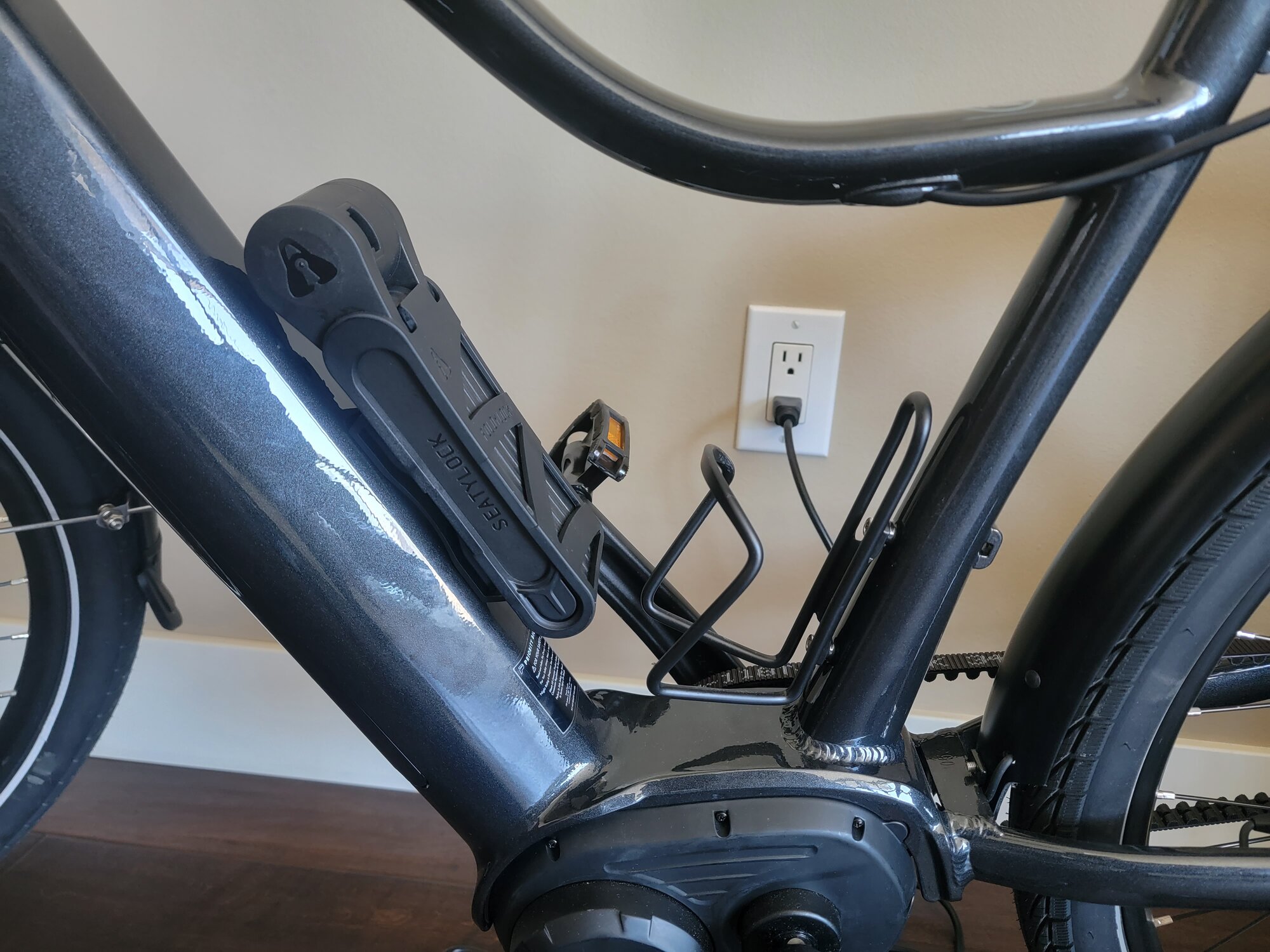

My first issue is that I bought a folding lock and bottle holder from Priority at the time I bought my Current ebike. The lock seems to be meant to fit on the seat post bar, since a water bottle could never fit there. But the space below the crossbar is so limited that I can't figure out how to get the folding lock into the holder. As you can see, I swapped the two holders but now a normal sized water bottle won't fit either. Any ideas?

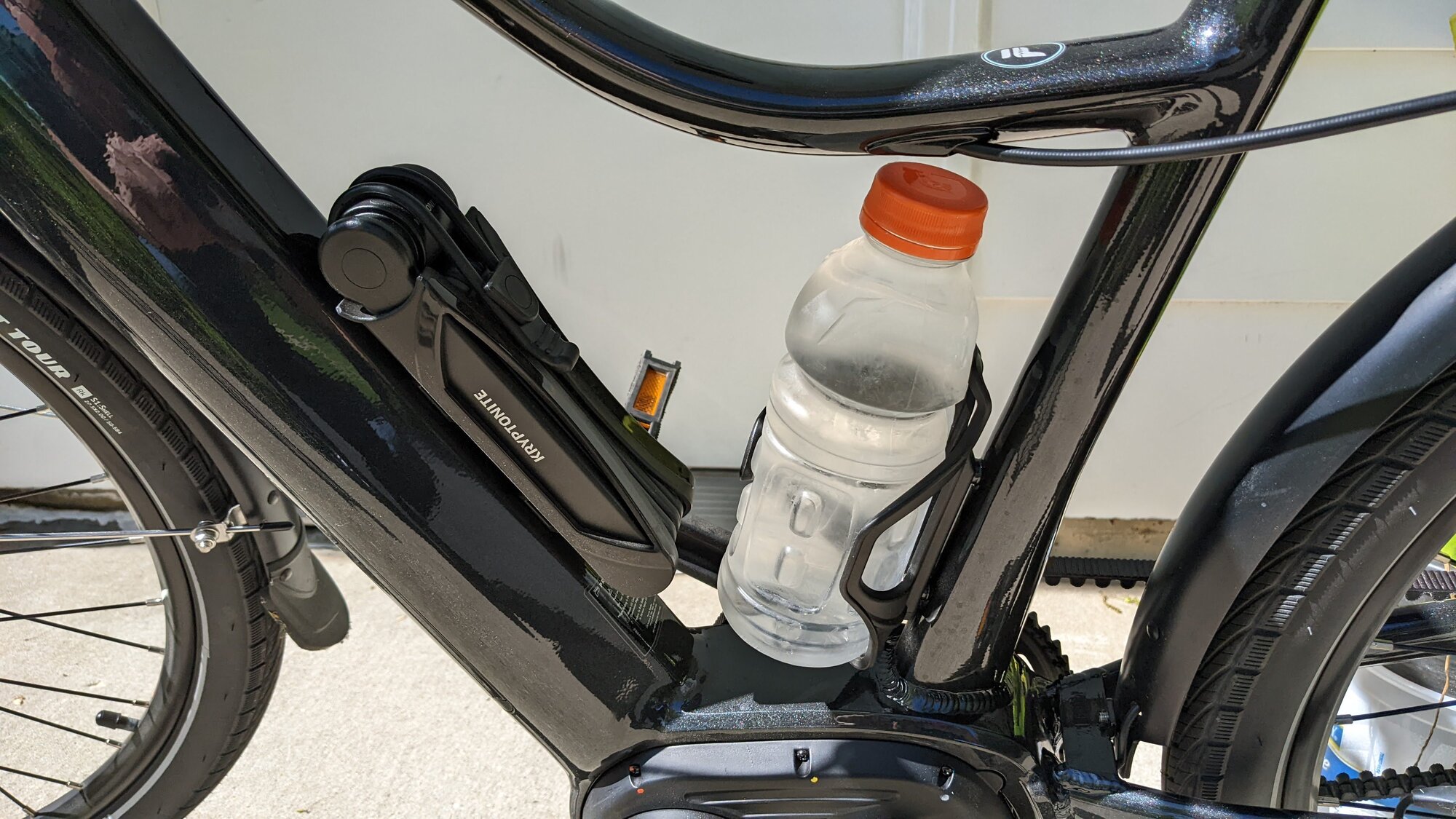

I'm also looking for a more elegant solution for this. In the meantime, I'm using a Lezyne side load bottle cage with a used gatorade bottle (12oz?)

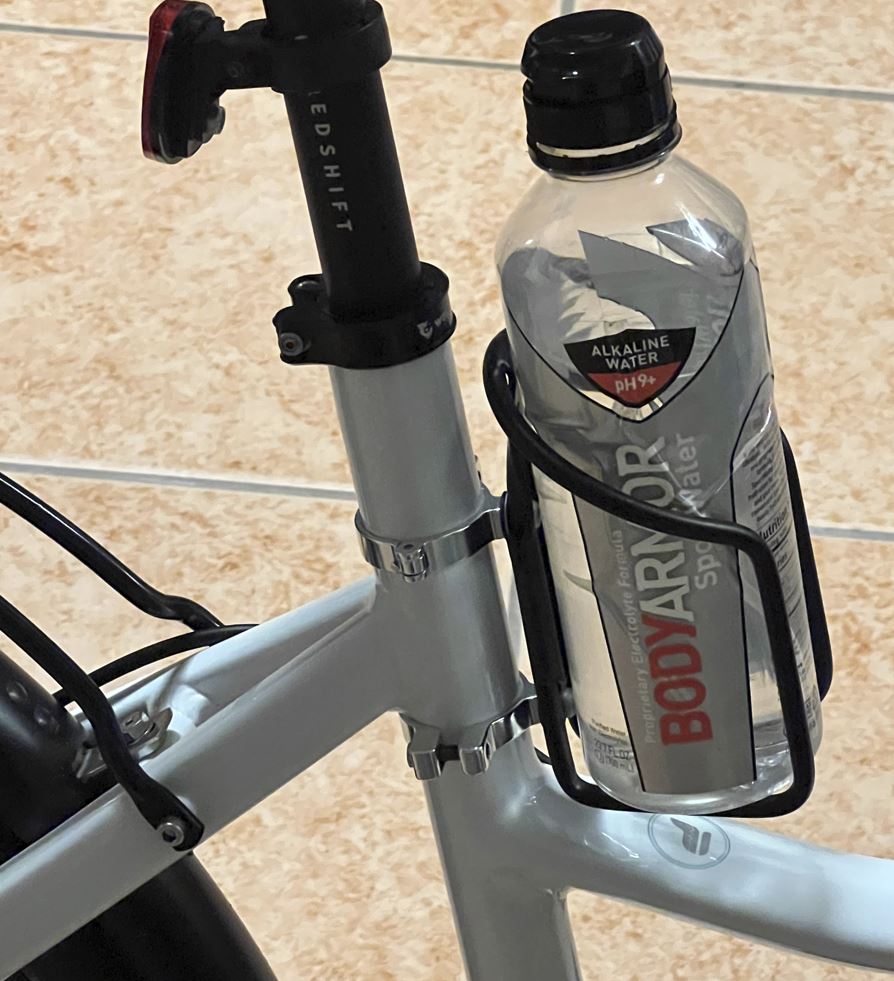

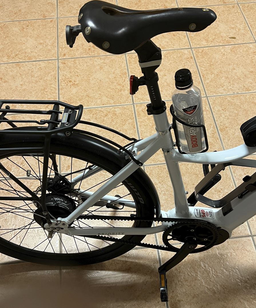

Hi, here is a solution that I've been happy with.
I made a bottle cage boss on the seat tube use two of these silver colored DMR Hinged Clamps ordered from here: https://www.chainreactioncycles.com/us/en/dmr-hinged-clamp/rp-prod745
The bottle cage I have is made from hollow aluminum tube construction to keep weight low. You can find them here: https://ride.lezyne.com/collections...roducts/1-bc-pole-v117?variant=19837330030678
Below is a picture of the seat tube area of my bike showing where and how the DMR Hinged Clamps are mounted and the finished look. Hope this helps!
Interesting. What size of clamp did you buy? Are you afraid of scratching the paint?
34.9mm is the size you need.
The DMR Hinged Clamps have plastic like coating that don't appear to scratch the paint. The first time I was installing them I had to fiddle with getting the orientation and spacing between the two clamps dialed-in, so I had to install and uninstall them couple of times and I saw no scratches. I use my bike almost every day since completing the install and have had these on my bike now for almost a year without any issues. I actually prefer this mount location for my water bottle over anywhere else on the bike.

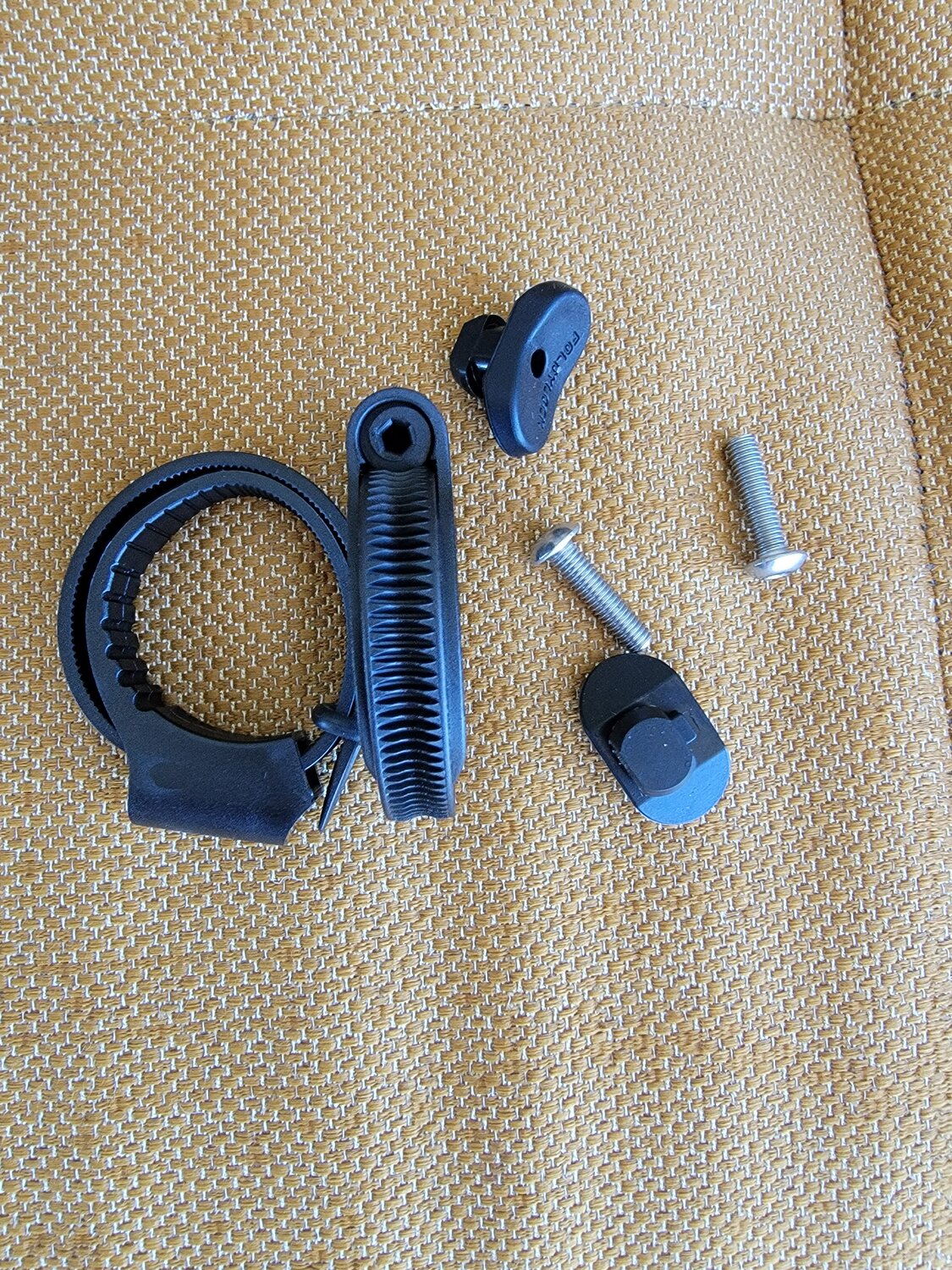

Your solution made me think about something I got from Priority that came with my Seaty Lock. Boy, my dim bulb is getting dimmer. This plastic clamp could work.
I agree, those clamps you got with your Seaty Lock should work. I like the clean and elegant look of the DMR Hinged Clamps.

The clamps do look nice. I wish they came in black. Shipping those from Germany must have cost as much as the clamps. I was wondering if your find your legs hitting the bottle below your seat?
I also wish them had them in black. The silver ones have grown on me. The clamps themselves are inexpensive. They ship from the UK. With shipping to FL, USA, I paid a total of $23.43 for the two. This was about a year ago.
Also, my legs does not hit the bottle below my seat becasuse the bottle bottle cage is narrow, below and towards the front of the seat.

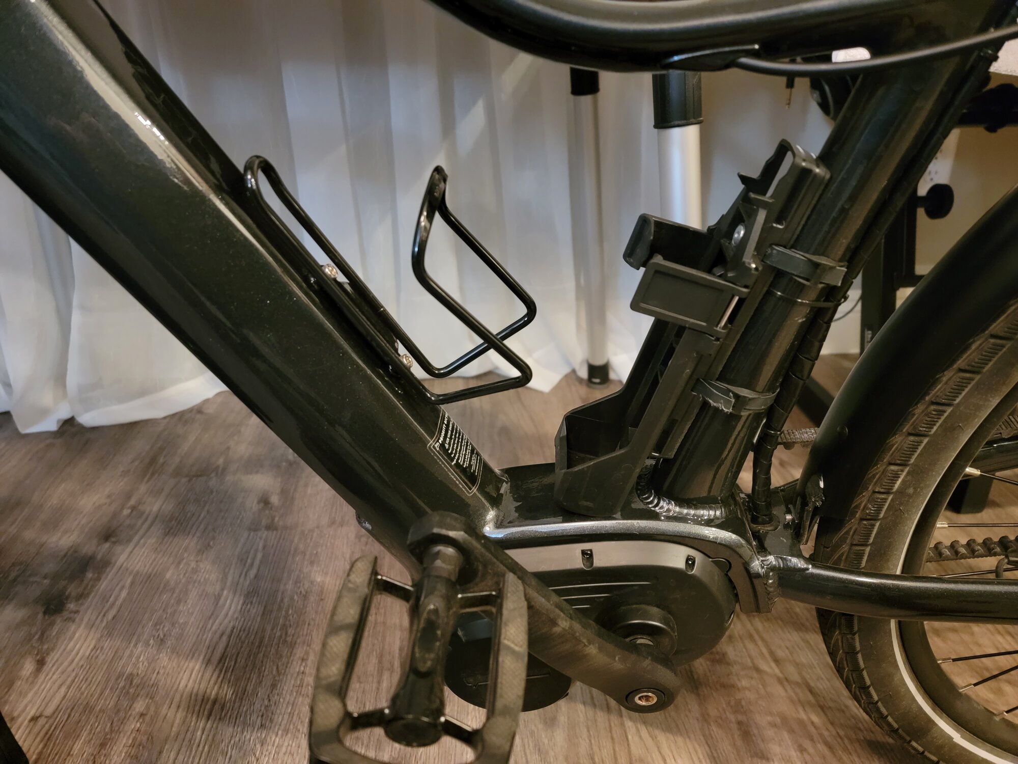

I have the large Abus folding lock. If you put the lock holder all the way to the bottom, you can just get the lock into the holder by starting with the bottom of the lock at an angle. It just clears my bottle cage.
I originally had the lock mounted on the top tube, but moved it so I could add a top tube zippered bag. I found a very nice one (waterproof?) on Amazon. The brand is Whale Fall.

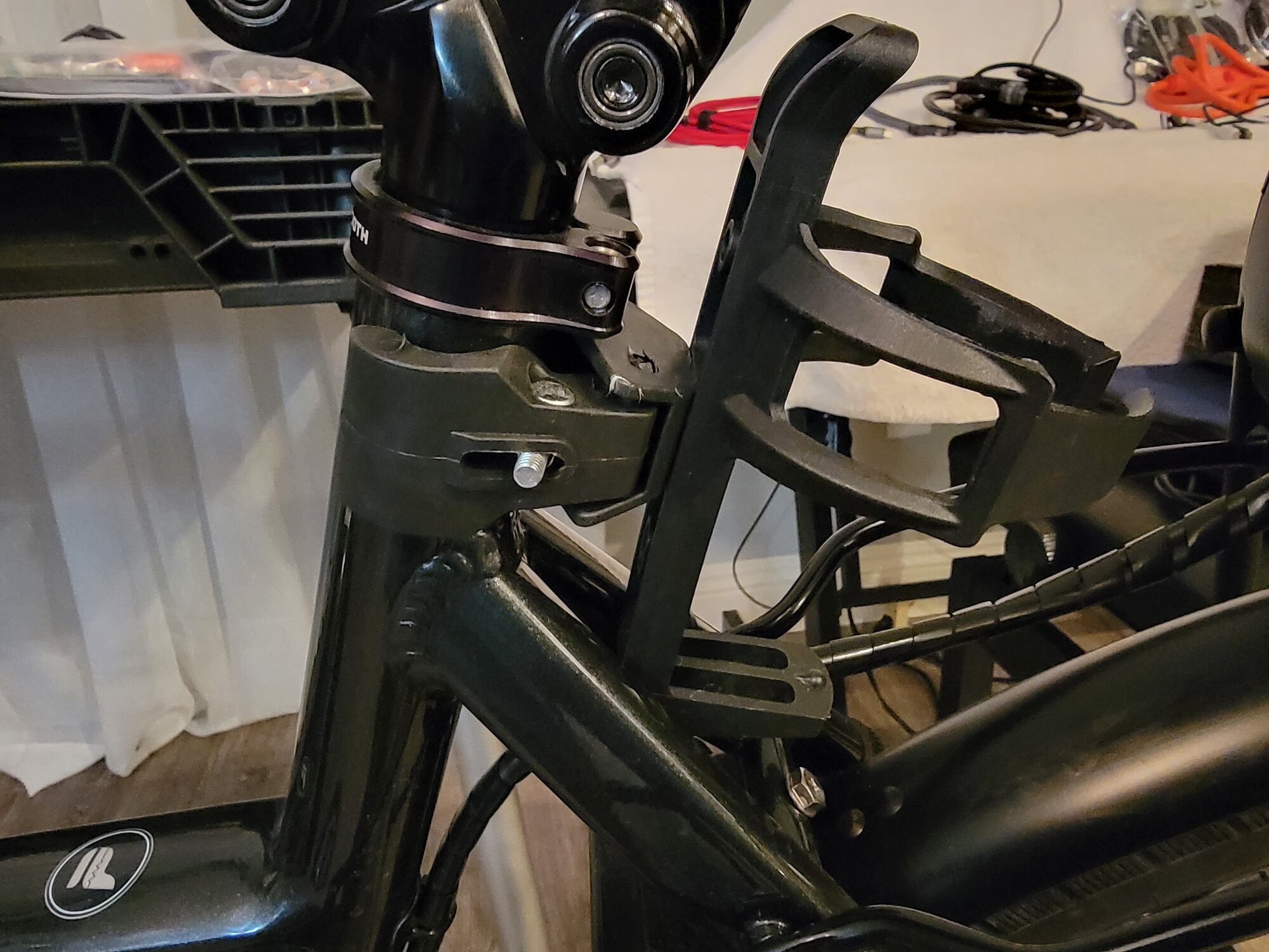

I also carry a second bottle behind the seat. I got a two-pack of these clamp on holders from Amazon for little money. After several rides, it seems to be holding up OK. I do have the holder resting on the frame, for support.

The lock holder that I have doesn't seem to allow for any alternate approaches to the holder. The clamp on holder looks promising. What brand is that?
