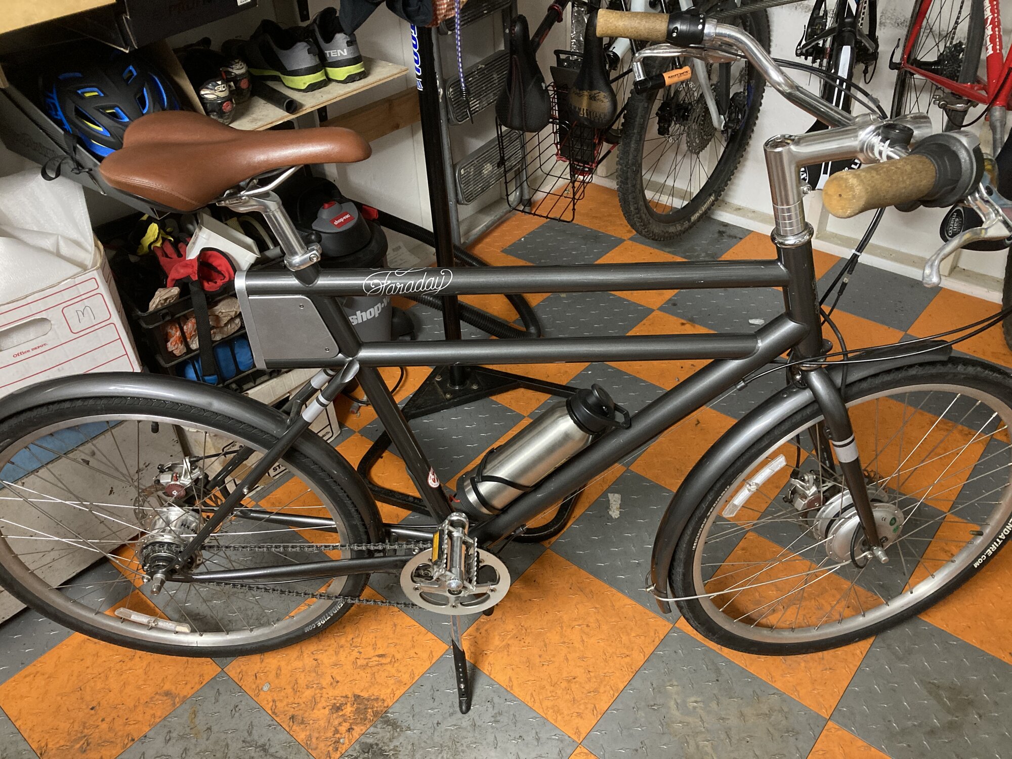

Bought a project and am in deep :) retro/hack or keep it original? What happens next?
Got bike tools, coding skillz and a soldier iron in between…

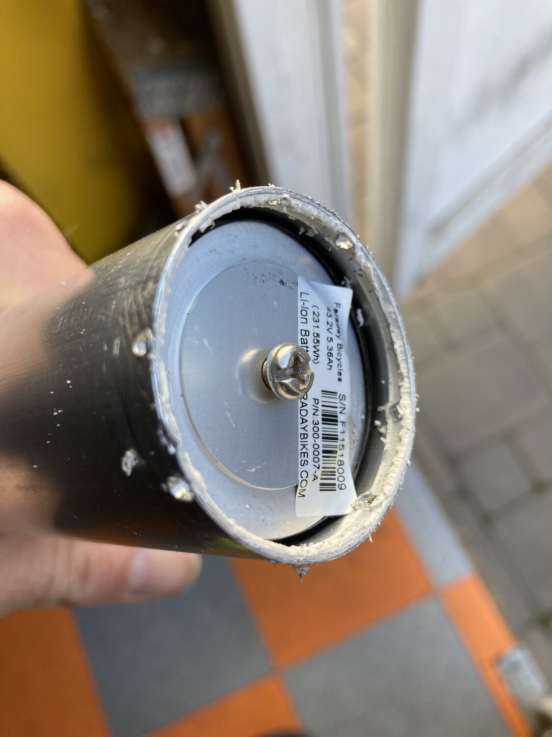

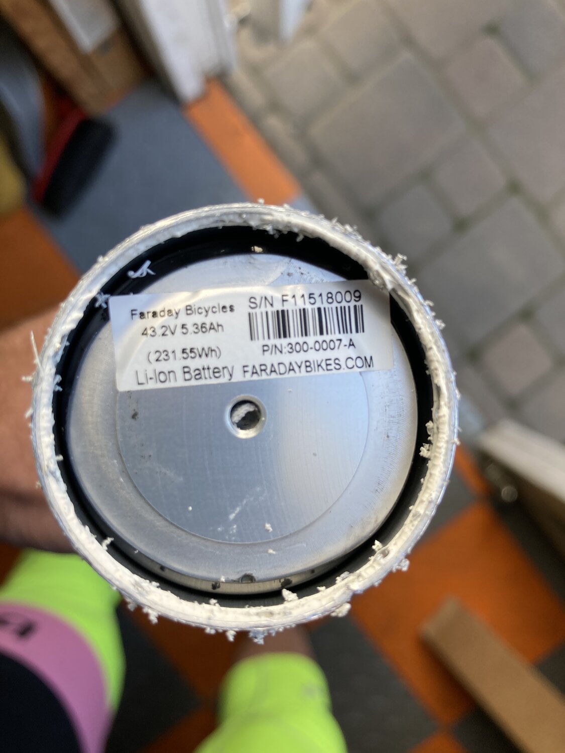

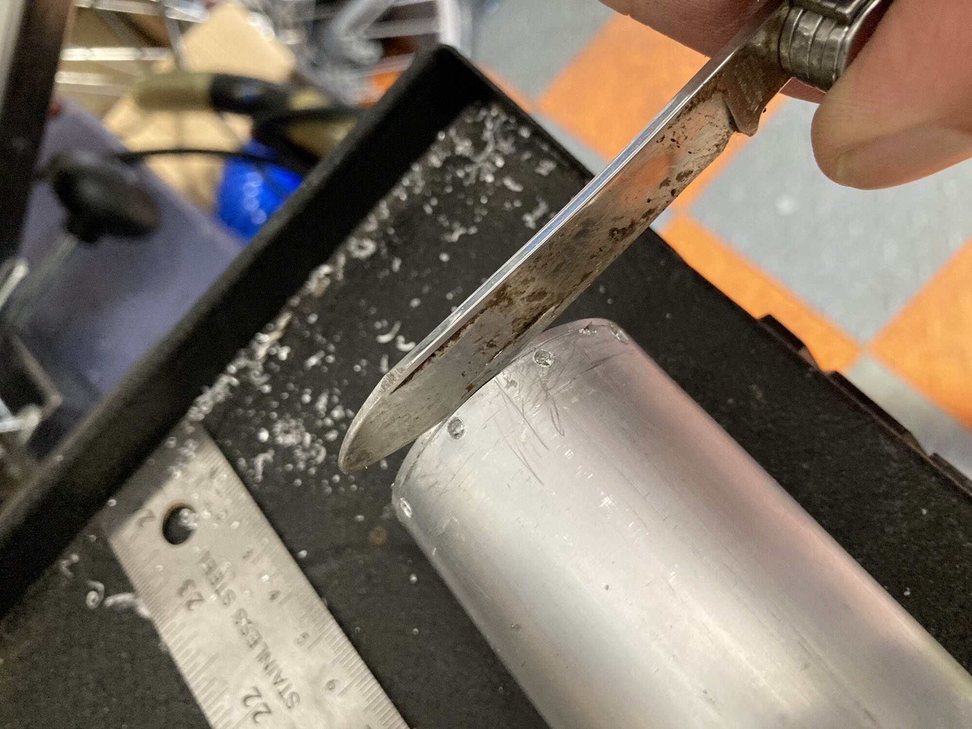

After mulling it over and convincing myself the battery is bricked, I took started taking it apart.

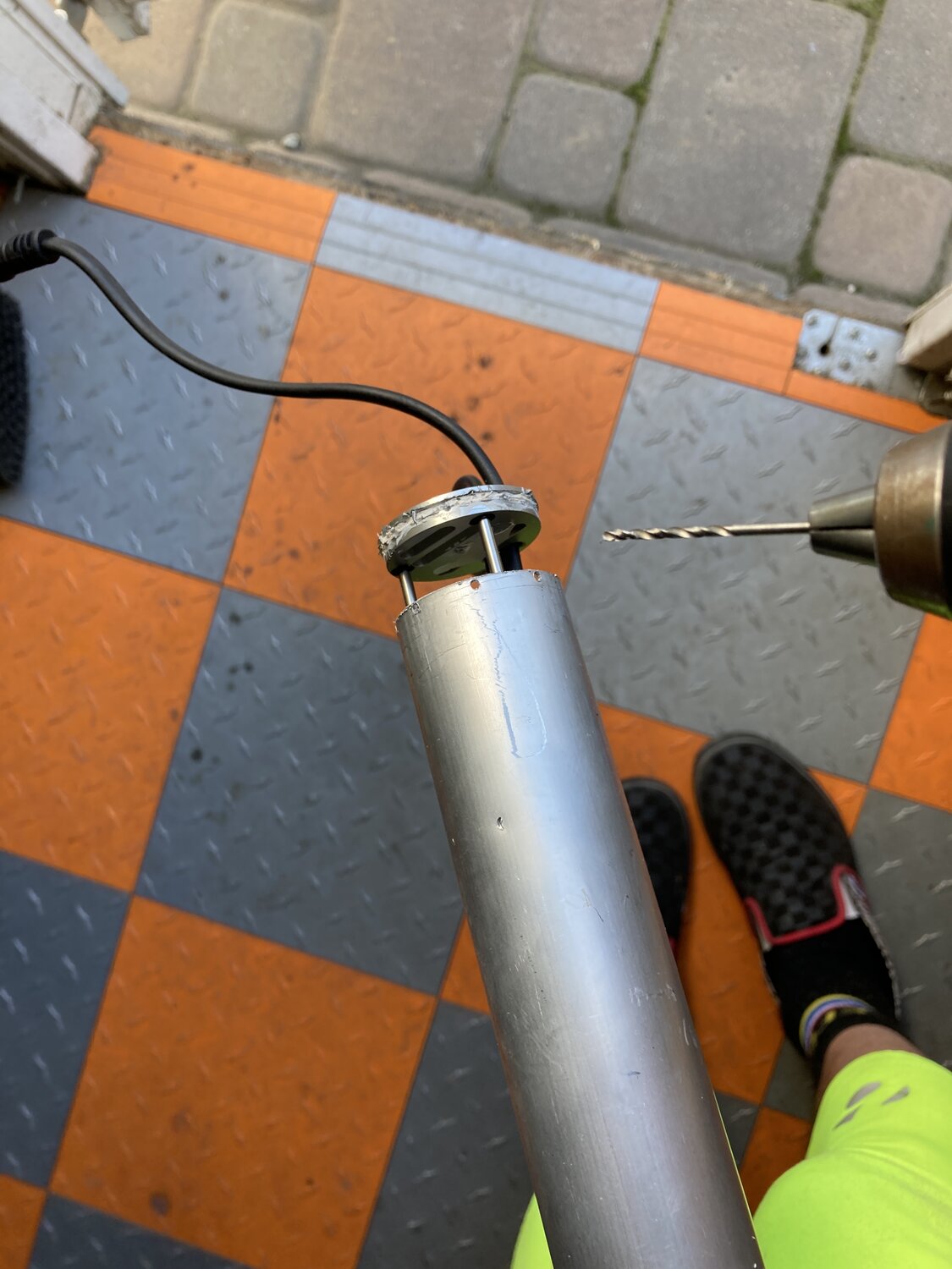

first step is to drill out the punched- in dimples holding the ends
And then some knife edge, screwdriver and big pliers

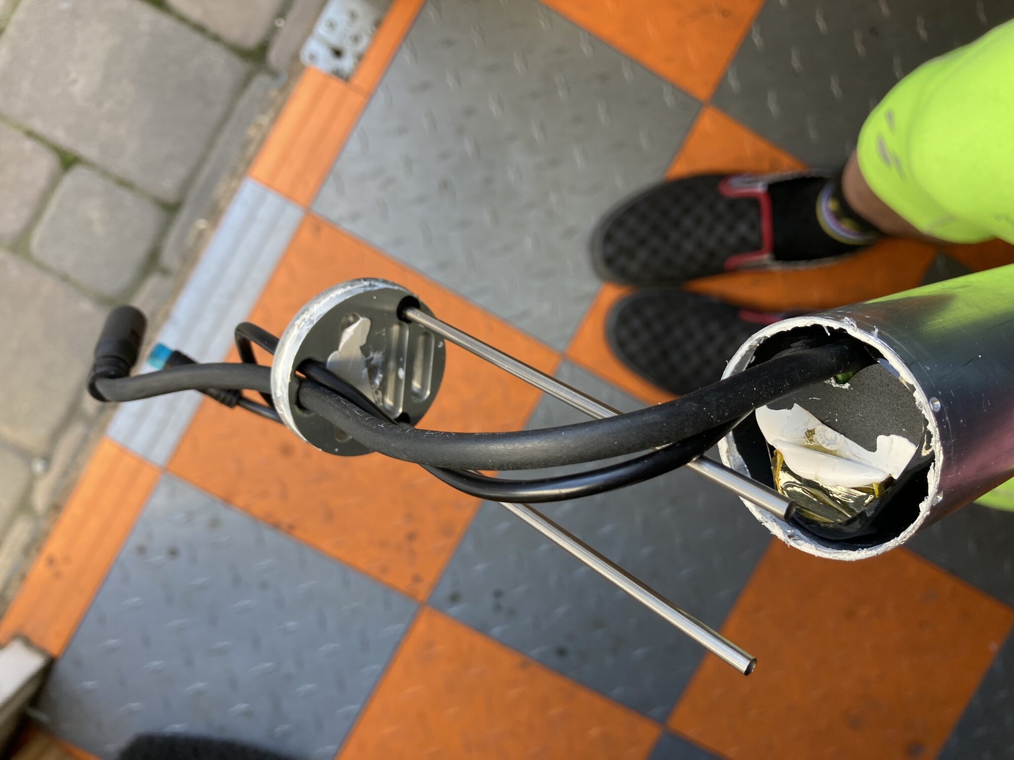

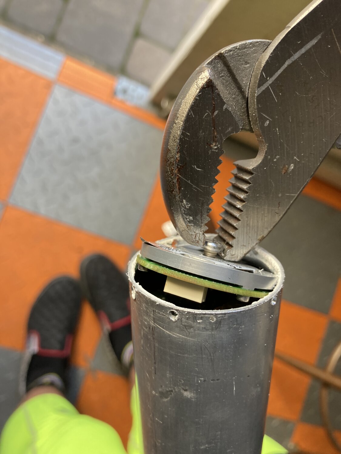

And the top pops off to reveal 3x batteries per cell

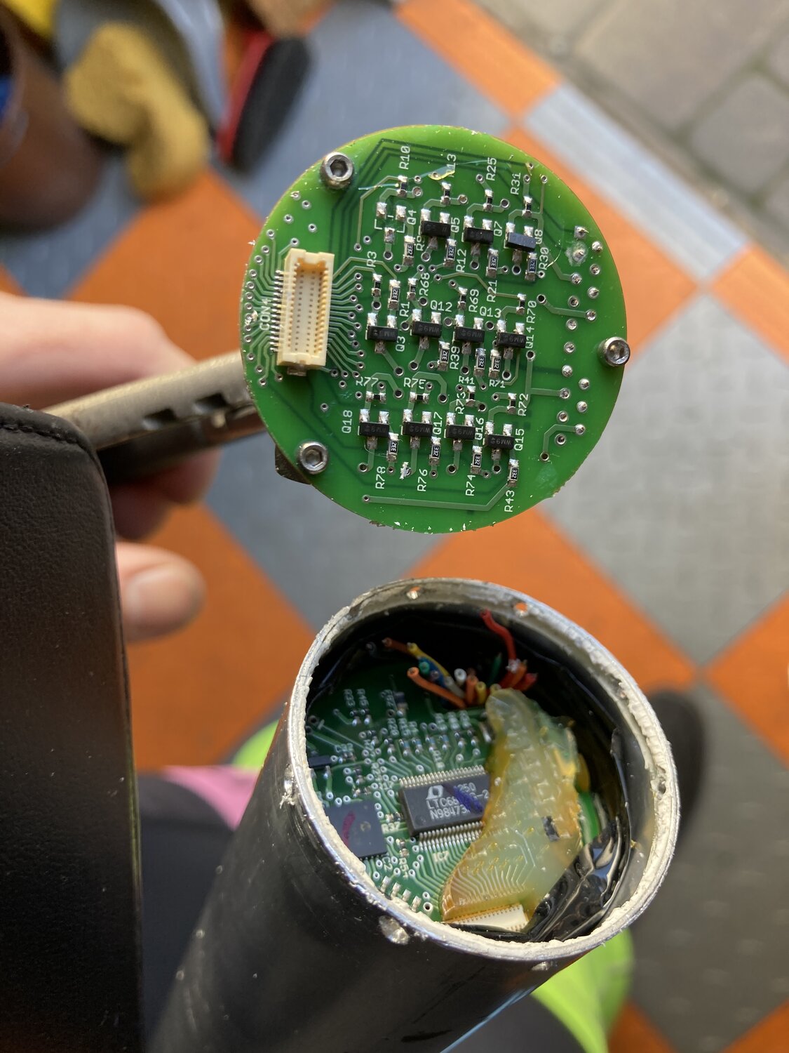

Drilling and yanking on the other end reveals the BMS, wires to the batts on the end side, plugged into another board with chips on the other
And
and pliers
and bms

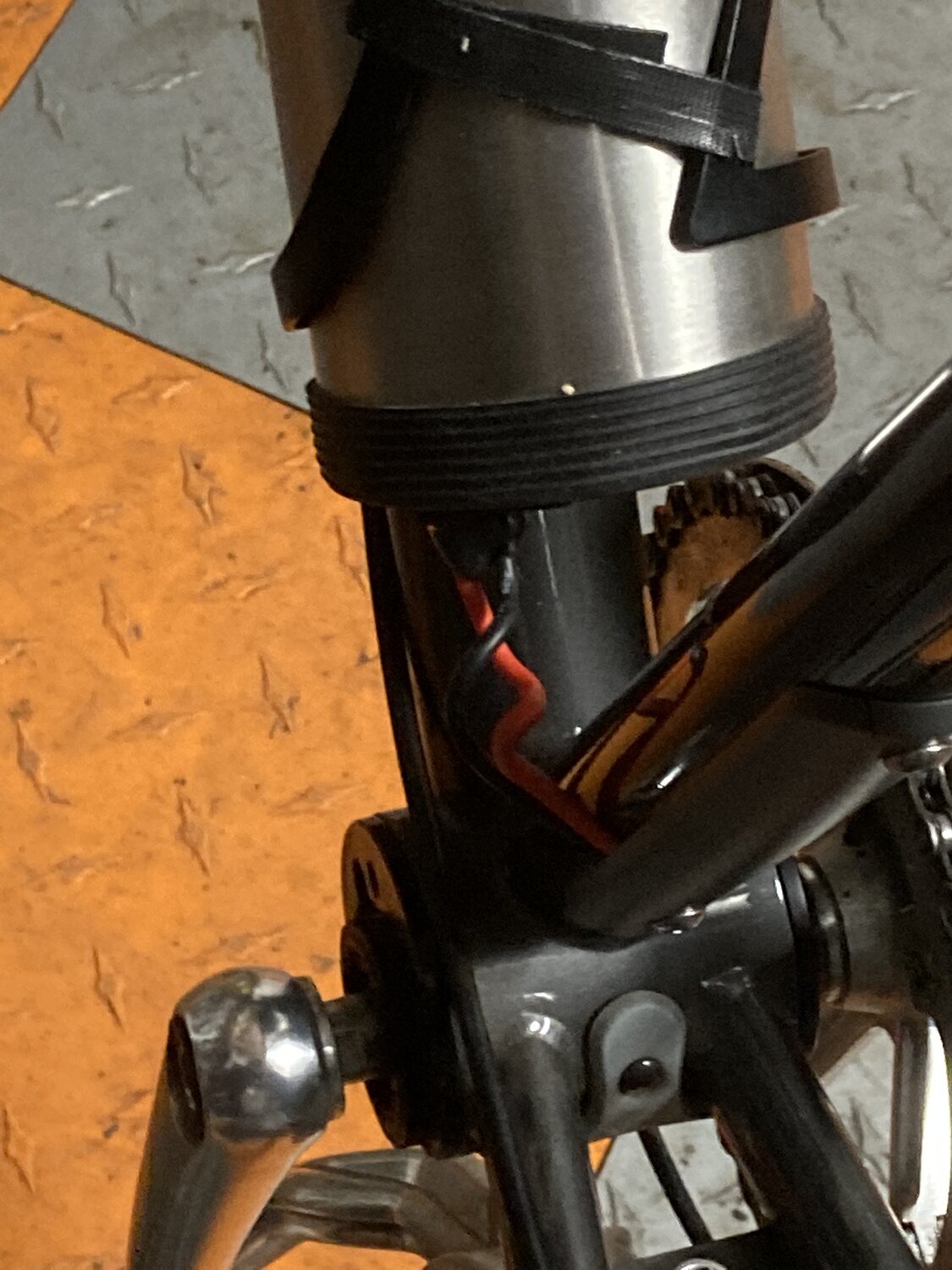

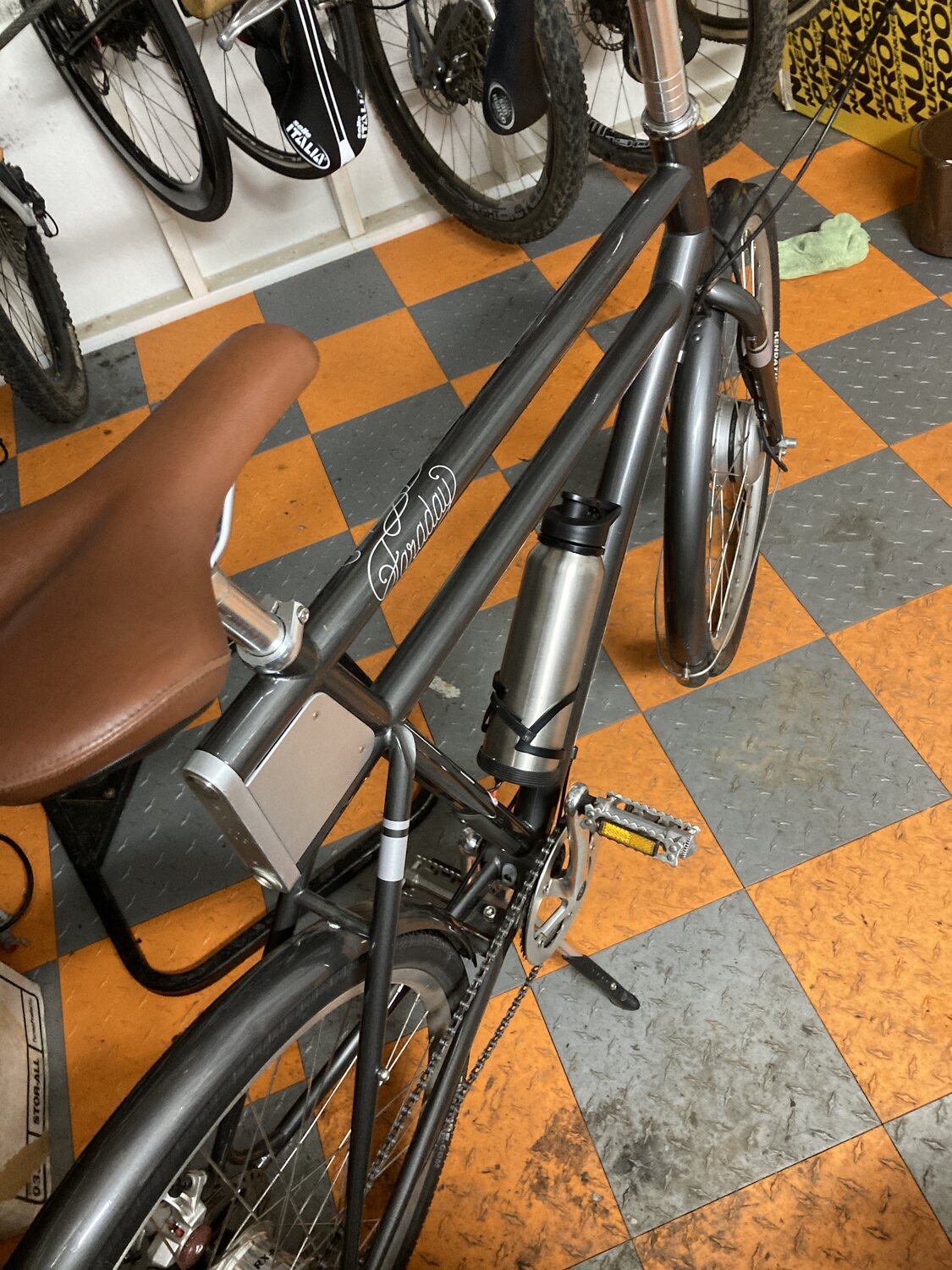

…and I got my waterbottle battery pack, drilled some holes for the cage, soldiered up the power cable, turned on the pack, the controller and headlight lit up! Moving the pedal and the front motor started spinning…
