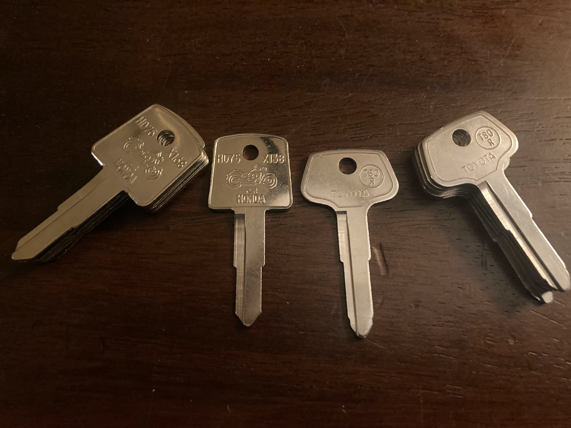

FROM THE POST I USED TO PURCHASE BLANKS
eBay has a seller with complete keys and lock.
The blanks are used by other devices. If I remember correctly they were Honda blanks. But you need a working key for a locksmith to cut new keys.
On the left are dolphins that used a Honda blank, in this case, Hyko HD75 and the on the right is for a shark and we used a Toyota blank, in this case, a Cole T020.

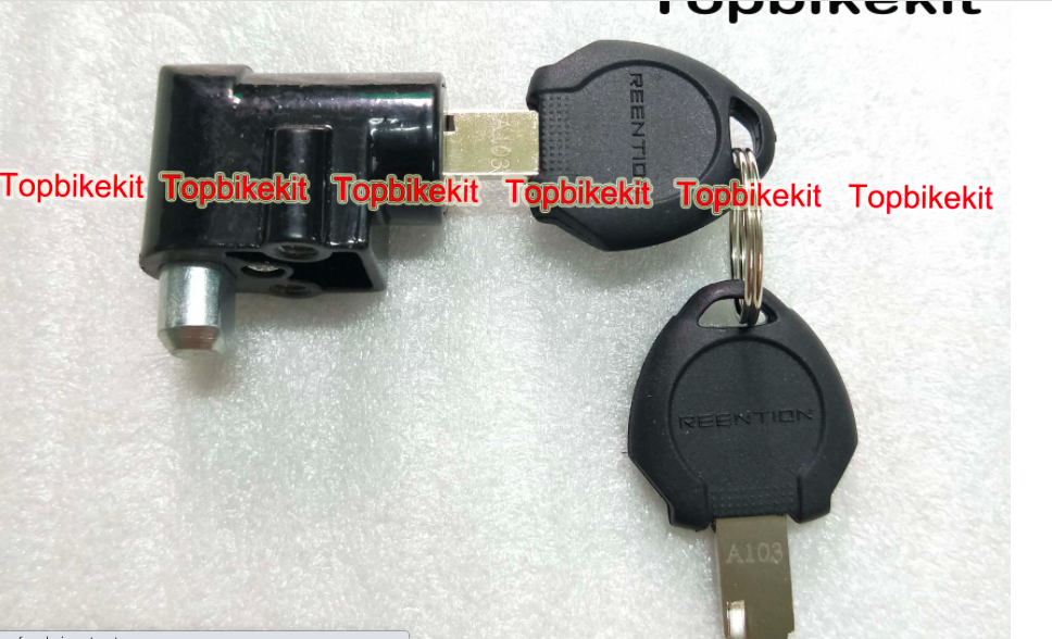

The profile of the Reention keys I have seem to match those of the Honda HD75 you posted.
My local Autozone does not have them in stock but they can be ordered via their website.

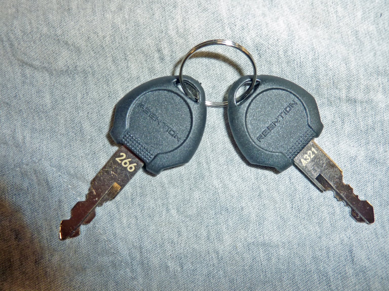

I found these from Grin Tech in Vancouver. They are made for the lock on the Reention / Hailong battery case:
They appear to have the milling on the same side as Key #266 in my pic above.

I ordered the HD75 blanks from Autozone and had them cut locally. They work fine for the battery case lock. I didn't need the Toyota blanks.
The lock on the Hailong battery uses a different key with the milling slot on the opposite side, or a mirror image of the HD75 (key #266 in my pic above). I had to order blanks from Grin Tech in Vancouver. I had them cut locally and they also work perfectly.
