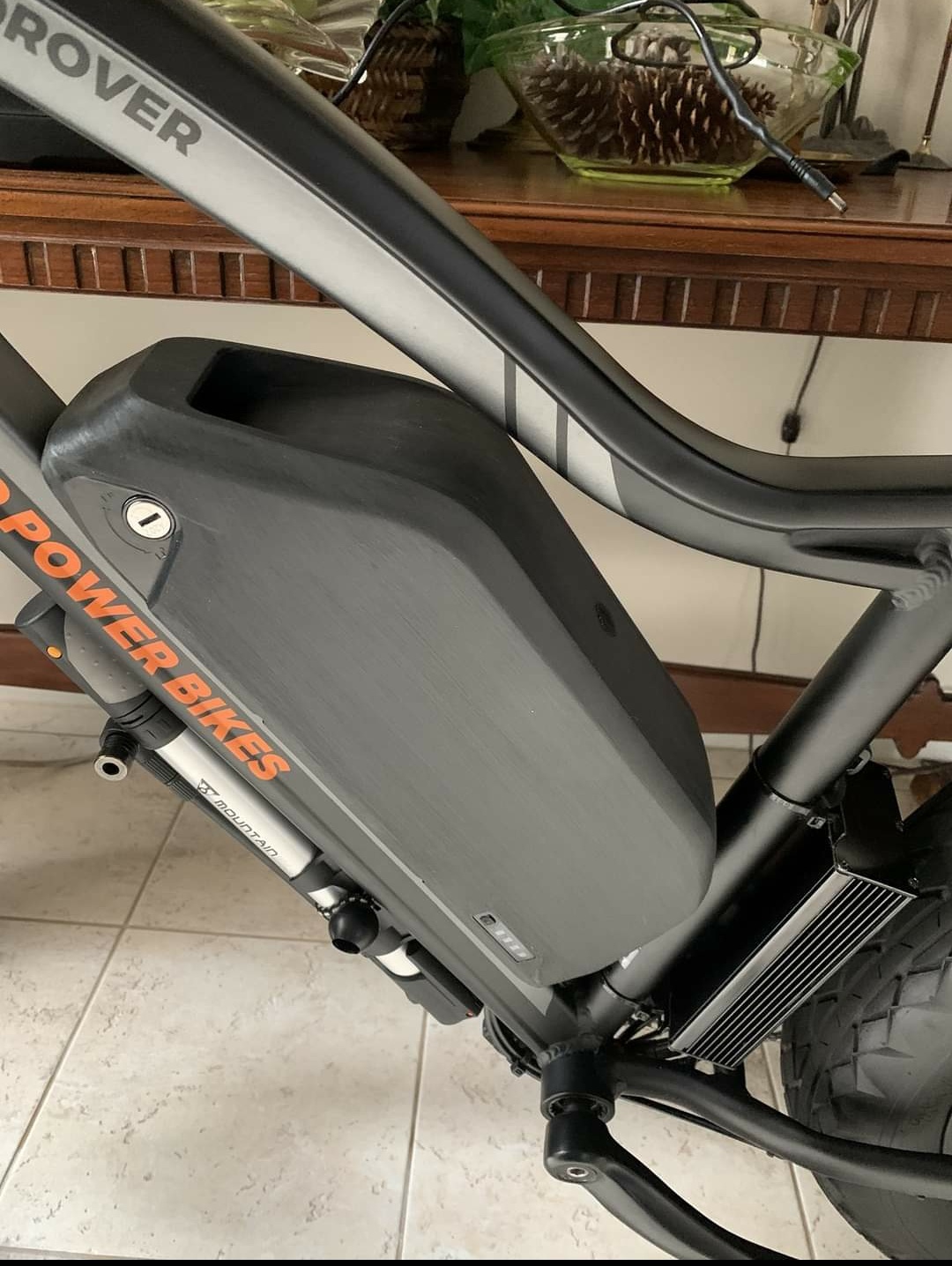

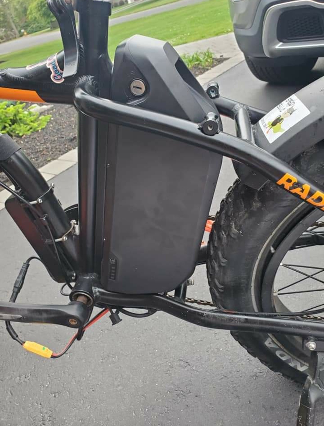

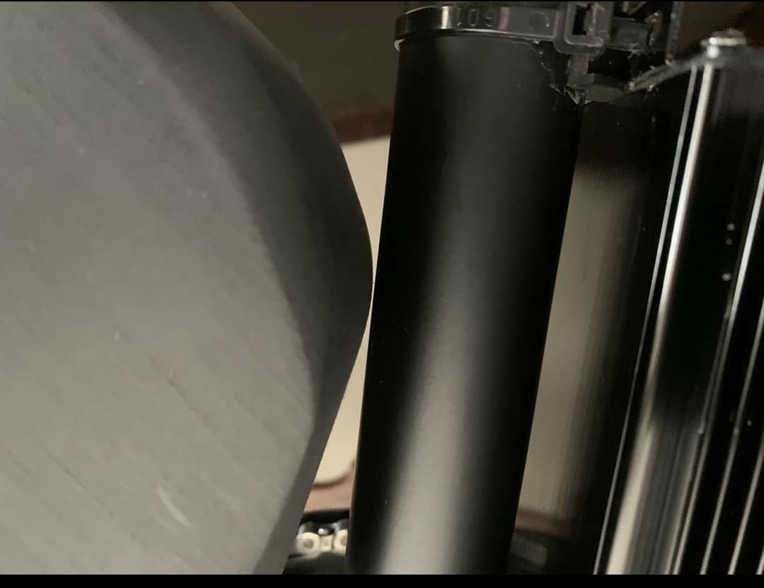

Yes. Couple Rovers, one mini.

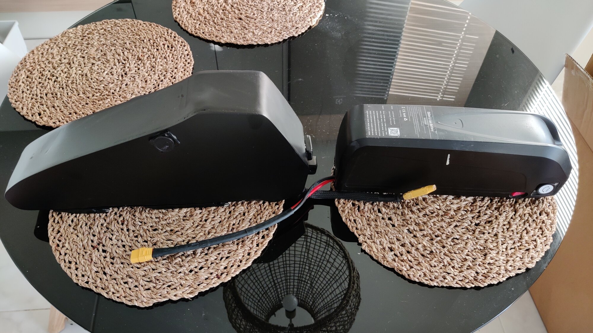

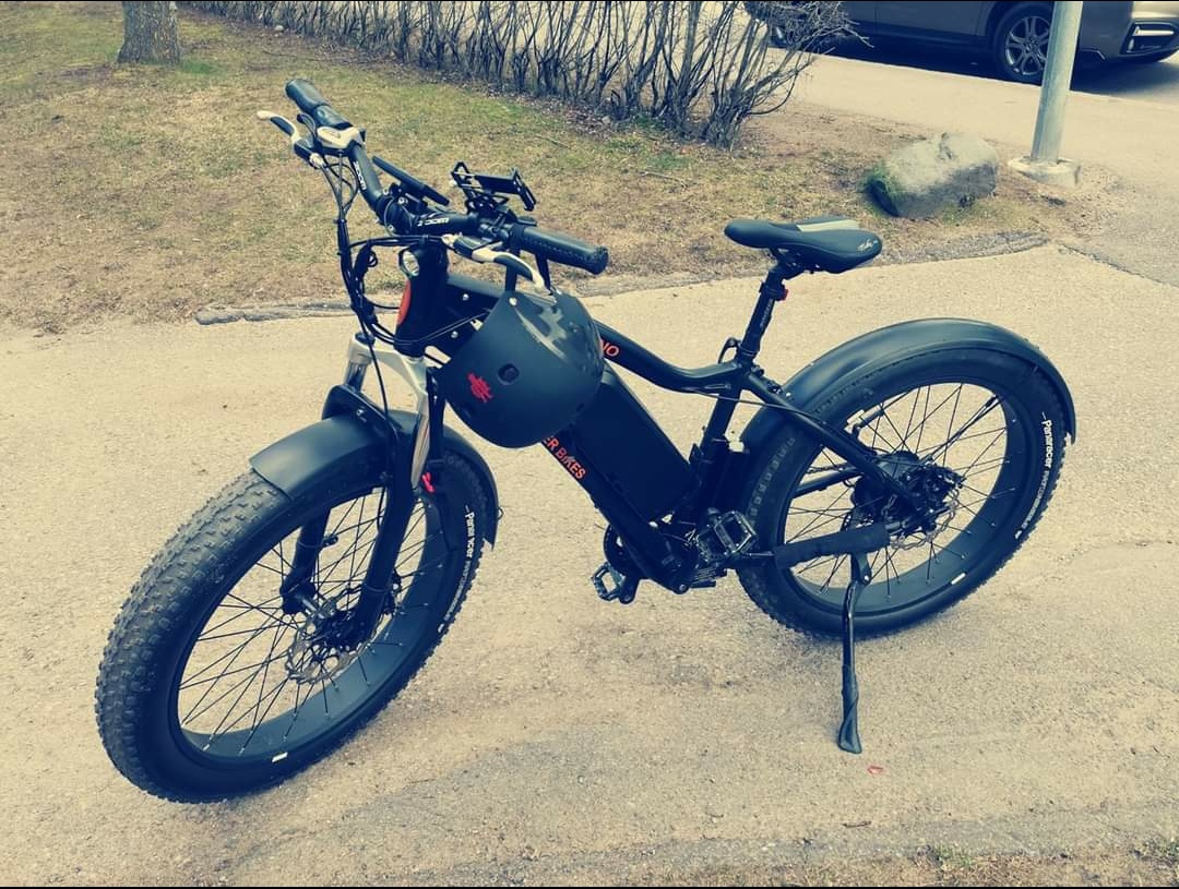

This is The former G80 battery on my bike.
Last picture is my current custom downtube battery compared to previouos G80.
The battery indicator is the bottle neck. 电量显示板
however it’s being used with higher A ratings. Maybe jenny mao can explain?
DP-2170-5C (125mm) is not as tall as DP9 (141mm). In many frames the DP9 is just a little too high to fit. DP-2170-5C is more comparable in size with G80.
