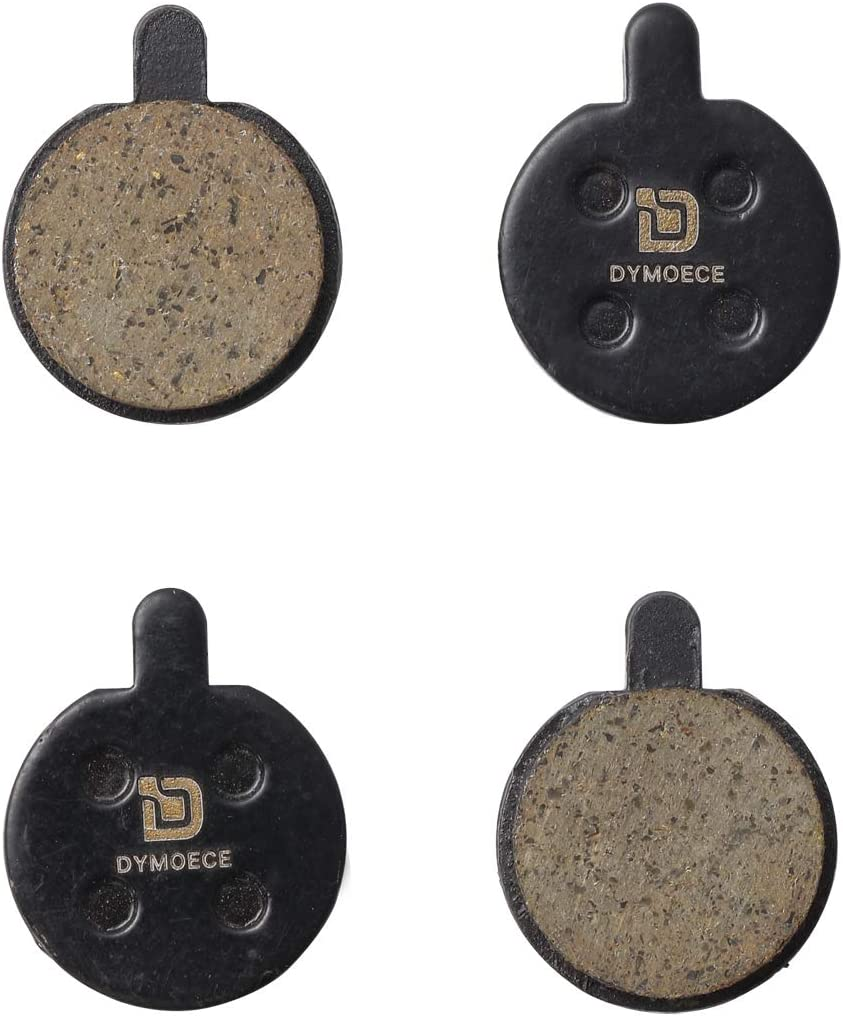

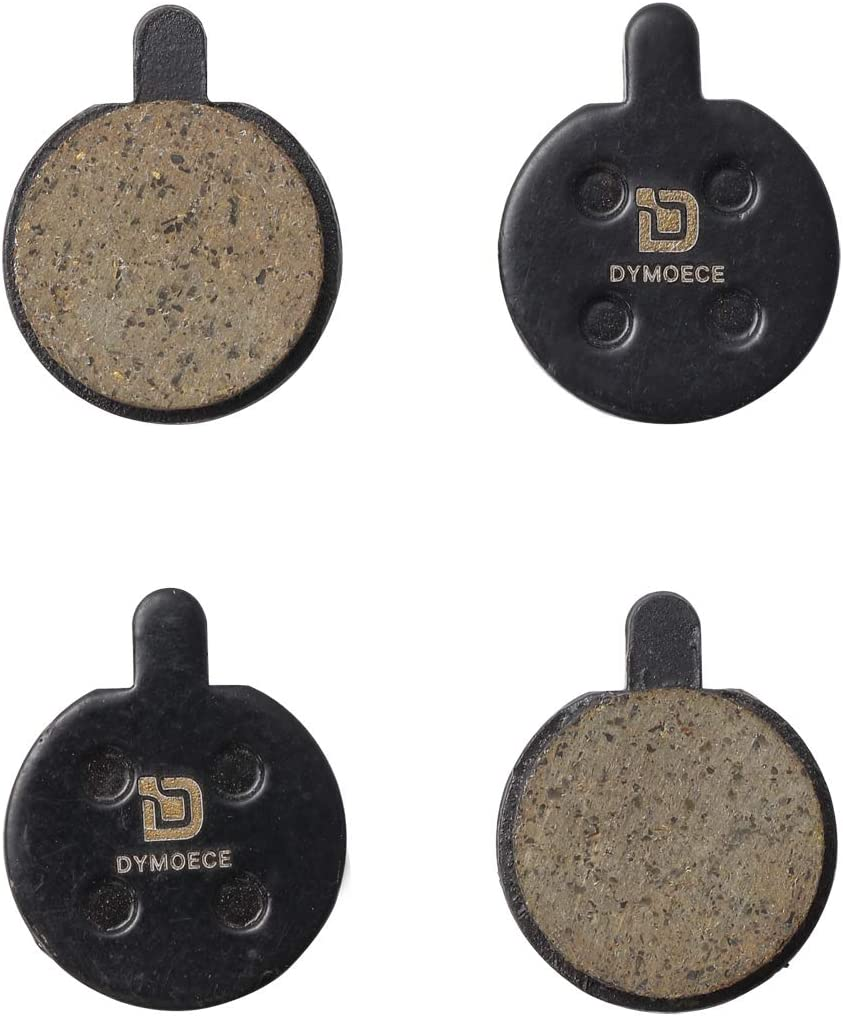

Here are some options for replacement pads... hope this helps.
I would recommend a brake pad upgrade first... what model are your current brakes?
FS911, FYI the pads You suggested did not work on my zoom brake, they did not have the slot for the spring to fit into. I actually ordered them and had to return them. I really do appreciate your efforts in trying to help out however Ijust want to make sure the word gets out in case anyone else has a similar problem. Thanks again,
Sorry that I gave you a bum steer... can you post the correct pad info to help other EBR members? ;)
No need to apologize, you were trying to help. The pads are I am using are by kool stop ( organic ) which I found on Amazon. Also the replacement pads for the avid BB5 brake will work and those are also available on Amazon. Again thanks for your help, I really appreciate it.
