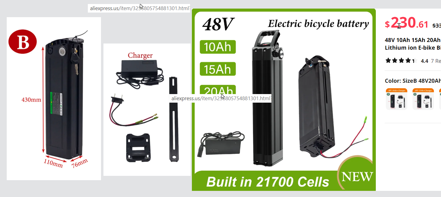

I am not giving advice as I am just learning but have appreciated info from here and elsewhere on the upgrading of the battery for my Ecotric Hammer from a 12.5 Ah battery to a 20 Ah battery (the max I could find). I needed more range and Amp Hours seems to be the only way. I couldn't find anything else but: https://www.aliexpress.us/item/3256805754881301.html (the B (430mm) 48V 20Ah version). I took a chance and it arrived in less than a month. It came with a little different guide rail, base, and plug. After charging (I needed a two pin to us standard converter: https://www.amazon.com/dp/B08P2HT2N7) and after a little adjusting to get base, rail, lock pin, etc. aligned it worked. So far the results look good. We'll see.

From the FWIW department:
Cyrusher had a 50% off sale for batteries so I picked one up for my Kommoda. It arrived with a tag attached to it warning never to use it with a voltage converter plug. Fire hazard, I guess.
As said, FWIW.
Thanks. It seems one does have to be careful with lithium ion batteries and voltage seems a key. My above link, in my understanding, is just a plug (not voltage) converter. The battery charger spec says input is AC100v-240v @ 2A. The old charger for the old battery had input AC120 2.0A. The battery charges without generating any heat on either device. Unless I am missing something this should be fundamentally OK as I am using it.
I checked out the Cyursher site but I don't see anything that would fit my Hammer though 50% would be worth looking for at for a similar class battery.
I appreciate the heads up and any further related input.
You bought a battery for something like an Aventon? I believe that's just the standard warning to use the charger that came with the battery. You can't go wrong with doing that.
If you have a good understanding of power, know the max safe charge rate for your battery, and the power rating of the connectors, then you can go your own way, It's my opinion that batteries with plastic cases shouldn't be charged higher than 2 amps, Connectors may start melting the plastic at 4A,
