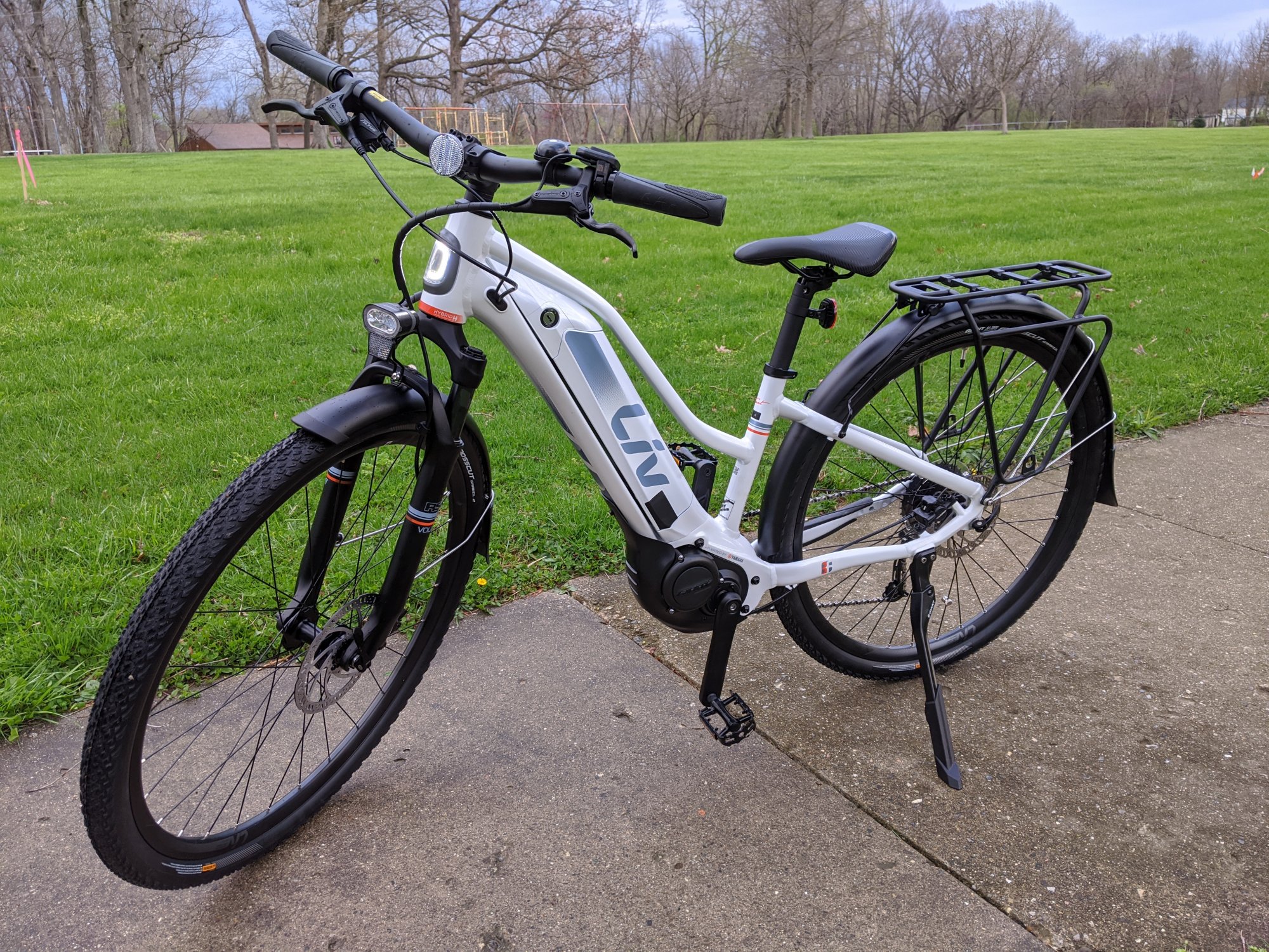

I got my bike today! It's gorgeous in person. Very well made. I got the extra small frame and I'm glad because it fits me perfectly. I'm 5'1". The motor is very quiet, responsive, and capable for what I want it to do. Brakes and gears are doing great. My only complaint is the harsh ride like others have noted. Yes, you feel every crack and bump in the road in your behind. I ordered a suspension seat post and a new seat so hopefully that helps. I'll let you know how that goes.
The riding style is very much like a road bike. It feels stable and well balanced. Very natural feeling when beginning to pedal from a dead stop. It doesn't coast quite as well as a regular bike because there's some drag from the Yamaha motor...I think. I'll have to experience it some more to tell.
It's weighs quite a bit less than my other ebikes, so it's easier to maneuver around in the garage or other tight places. I haven't found the weight listed anywhere but Court did a review on the Giant brother to this bike and it was 49 pounds. I think it might weigh just a tad under that which is pretty good for an electric bike.
I added the fenders, rack and a kickstand when ordering. I've always thought it was silly for bikes not to come with kickstands, especially an ebike. At least the accessories were priced reasonably. Anyway, it does come with two integrated front lights, including a daytime running light in the headtube. Looks cool and is bright enough to get attention. No light in the back but it does have a reflector. There is a very nice slap guard for the chain. I'm going to get some reflectors for the spokes but the white frame is super visible. The paint job and details look flawless.
I'm going to try to adjust the front suspension because right now it's set pretty stiff. The owner of the bike shop put it together for me and delivered it. I could tell he's not the ebike type. He's a longtime road bike enthusiast so I'm sure a stiff bike is right up his alley.
Anyway, I think I'm going to love it once I get a smoother ride for my rear end. :)

I'm enjoying the bike very much! I'm sure a suspension seat post will work wonders. I don't want to give the impression it rides rough because it doesn't. I have an old Trek, a regular bike, that rides the same. Very typical of road bikes. I'll try lowering the tire pressure until that seat post comes. :)
Good point! I’m sure all hard tails ride similar. I just added Creek Crane’s latest Thudbuster and took my Liv for a ride. The improvement is subtle but I did not feel the harsh jolt to my back going over ruts in pavement or dirt. I had to move my seat a little forward to compensate for the lengthened reach which put my knee in a slightly less than ideal position. I am not sure yet how much this will matter. Haywired, Please let us know how you like your suspension post when you get it! 🚴‍♀️
Okay, back from my first real ride and my view of the bike has changed...for the better! As far as pedal assist goes, levels 1 and 2 were plenty for me most of the time. I never had to use the highest level. This is an ebike you could ride without the motor too which is great. I wanted a bike for exercise.
Yes, it rides stiff but not harsh. Padded bicycle shorts would be enough for most once you get used to the bike. A suspension seat post is still a good choice for longer rides. I'd recommend some riding gloves since the grips don't have much padding to them and you're putting quite a bit of weight on your wrist from the riding style.
The fenders protected me well from mud and water puddles. Some water got on the motor but it's protected well. No issues. The frame itself didn't get a drop on it. I rode through some slimy mud and the tires didn't slip at all. They have good grip.
Oh, and I didn't notice any drag from the motor and it's super quick to respond. It's also quiet enough to hear the birds singing and traffic around me.
Anyway, I just wanted to give an update.

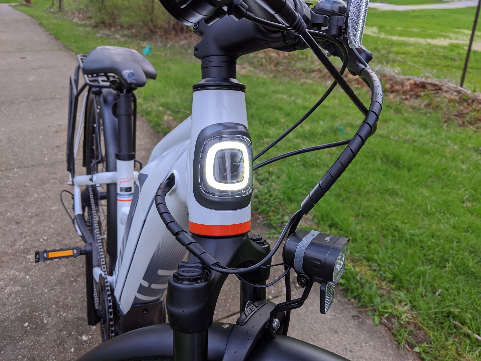

It has a nice rubber chainguard, a front headlight, and the coolest day time running light integrated into the headtube (with the lights set to on, it will automatically switch to the best one for the lighting conditions)
