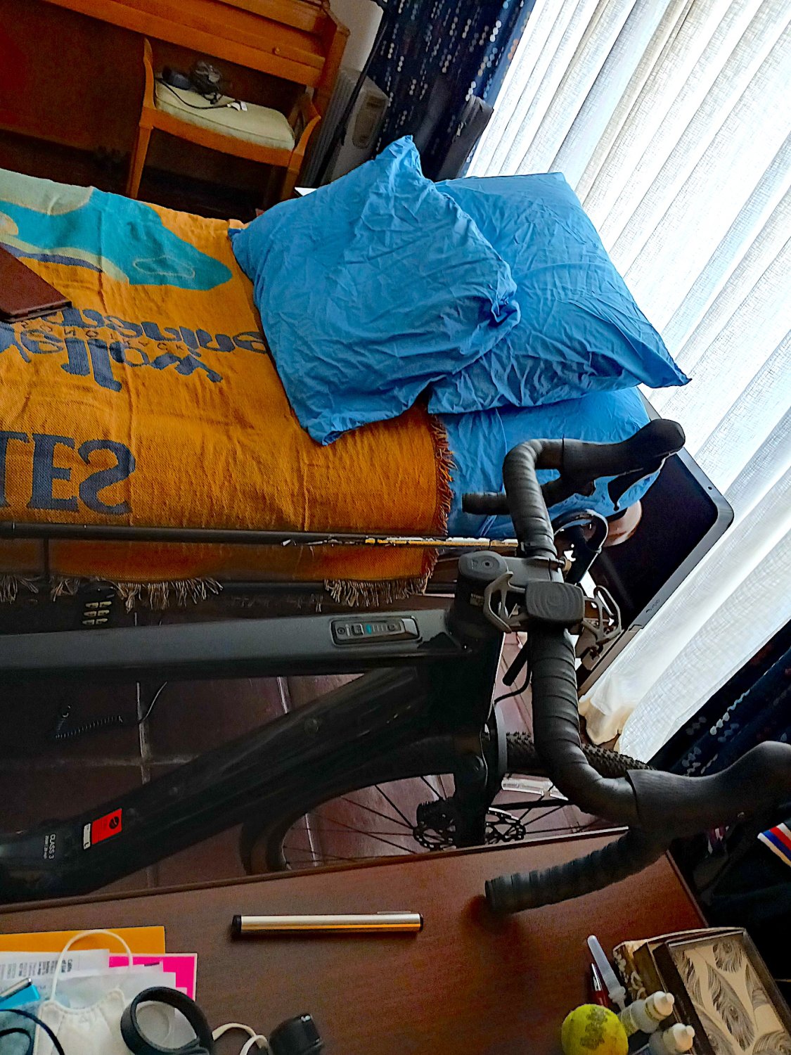

I am at that point where I still -- just barely -- benefit from a hospital bed, but I'm also -- just barely -- able to ride.
I did kind of prank my wife. When she came home, as expected, she asked, "What is the bike doing there?"
My answer: "She was hungry, I'm feeding her."
At which point, my wife rolled her eyes and totally figured out I'd set her up for a one-liner. How do I know she is female? Well, because she's heterosexual, and I see how she reacts to male bikes.
I'm still using this thing mostly because we're doing noisy home repair projects upstairs and I REALLY need the extra 45 minutes of uninterrupted sleep, but also because the incline of the mattress is helpful-- I have to figure out some way to duplicate that in the bedroom.
