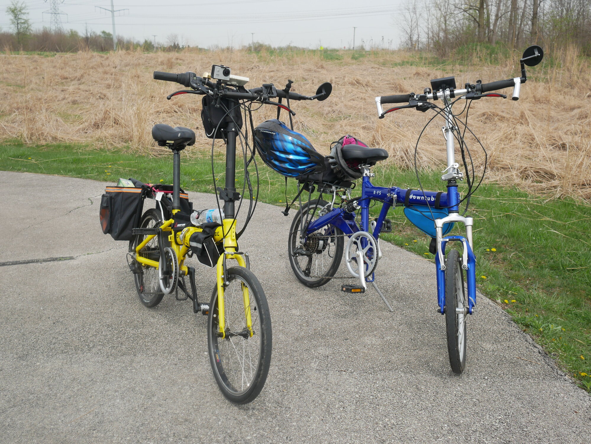

The Dolphin has a 52t crank chainring and a 14-28t rear freewheel (Shimano MF-TZ500-7). I'm going to swap out for a 11-28t rear cassette (Shimano HG41-7 $16), which should reduce the ridiculous "hamster wheel" pedaling cadence by about 20%.

Yes, @iOsiris, I did indeed. Freewheels and cassettes just attach differently to the hub and cassettes are the more common expectation these days. Same splined Park Tool. Otherwise, fairly straight forward DIY swap out and the 11t offers about a 20% reduction in crank rotation effort at wide open throttle. If anyone is doing this, I can walk you through removing the rear wheel, as it's a bit intimidating at first.
Not a lot of selection on 11t 7spd freewheels these days...Shimano doesn't make one anymore, and the only other one, DNP Epoch, only seems to come in nickel-plated cro-mo.
I also upgraded the crank from OEM 52t to a LitePro 53t (note: 56t and 58t won't clear the rear chainstay)...also a quick, cheap DIY if you have a crank puller tool in your toolbox.

DNP, by the way, was never known for quality amongst bikers who bought them to get 11T. The many disparaging reviews scared me too, but they come from the Spandex crowd who put a heavy load on the drivetrain. I don't even know why Spandexers would even deign to ride a freewheel bike. Cassettes are so much more durable. Anyway, ebikers are mostly trying to keep their pedal speed up. Much less stress. I've got 2600 and 1700 miles respectively on the two I bought.
Thanks for the kind feedback @Tinker I will say, peddling is very comfortable with the 11t at 25mph and power assist 5. When there's no bike lane, I find it's much safer riding closer to the speed of traffic. Vehicles aren't feeling you are an obstruction to overcome anymore. They aren't anxiously riding your rear wheel, strategizing on where to overtake you, and generally give more space. That's safer for everybody in the long run. The 11t DNP freewheels suddenly got popular, I think they were sold out on Amazon a week or so ago. If you find a link that has them, feel free to post for others that might be looking.
