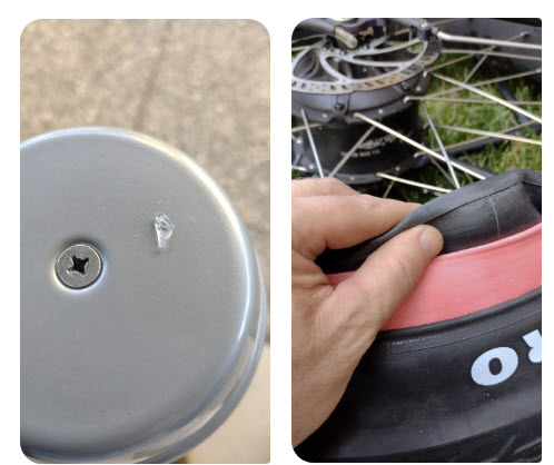

Took my first flat today on the Duro Fleetwoods, with Tannus Armour inserts, mounted on an Ariel Rider Kepler today. A 9mm sliver of glass was the cause, which I wiggled back out by squeezing the tread (it was still at the tread not worked beyond and through the Tannus). Still, it punctured the tube. No additional glass was found inside. Luckily it went flat while I was racking the bike at work.
Tire was inflated to 25.1psi (Jaco Elite Tire Pressure Gauge - certified accurate to professional ANSI 2A standards (±0.50% FS)). Apparently that is enough pressure to compress the 26x4 Tannus to 6mm or so?
How thick is a standard Hershey's Chocolate bar? The Tannus might actually be thinner than others have reported.
Here is an image of the glass and puncture.

Yeah, the stock tires might not have even taken the glass, and it's definitely all a bit of luck regarding how the object makes contact. Slicks will be more prone to glass, which was what I had hoped the Tannus Armour would help with. Just didn't happen this time, but I am concerned with how much the Tannus are compacting (in my experience and as reported by others). I've added some sealant for now. We'll see if it works with the Tannus in the mix. Next up would be adding a puncture strip, or
I will say that I fixed this flat on the bike, and the folding bead (plus higher TPI) was worlds easier than the stock wire bead would have been (even with the Tannus crammed in there - smaller tube btw, 26x3/3.5). Those wire beads are no joke. Also, pushing them to the middle of the rim to gain bead play moves the rim tape.

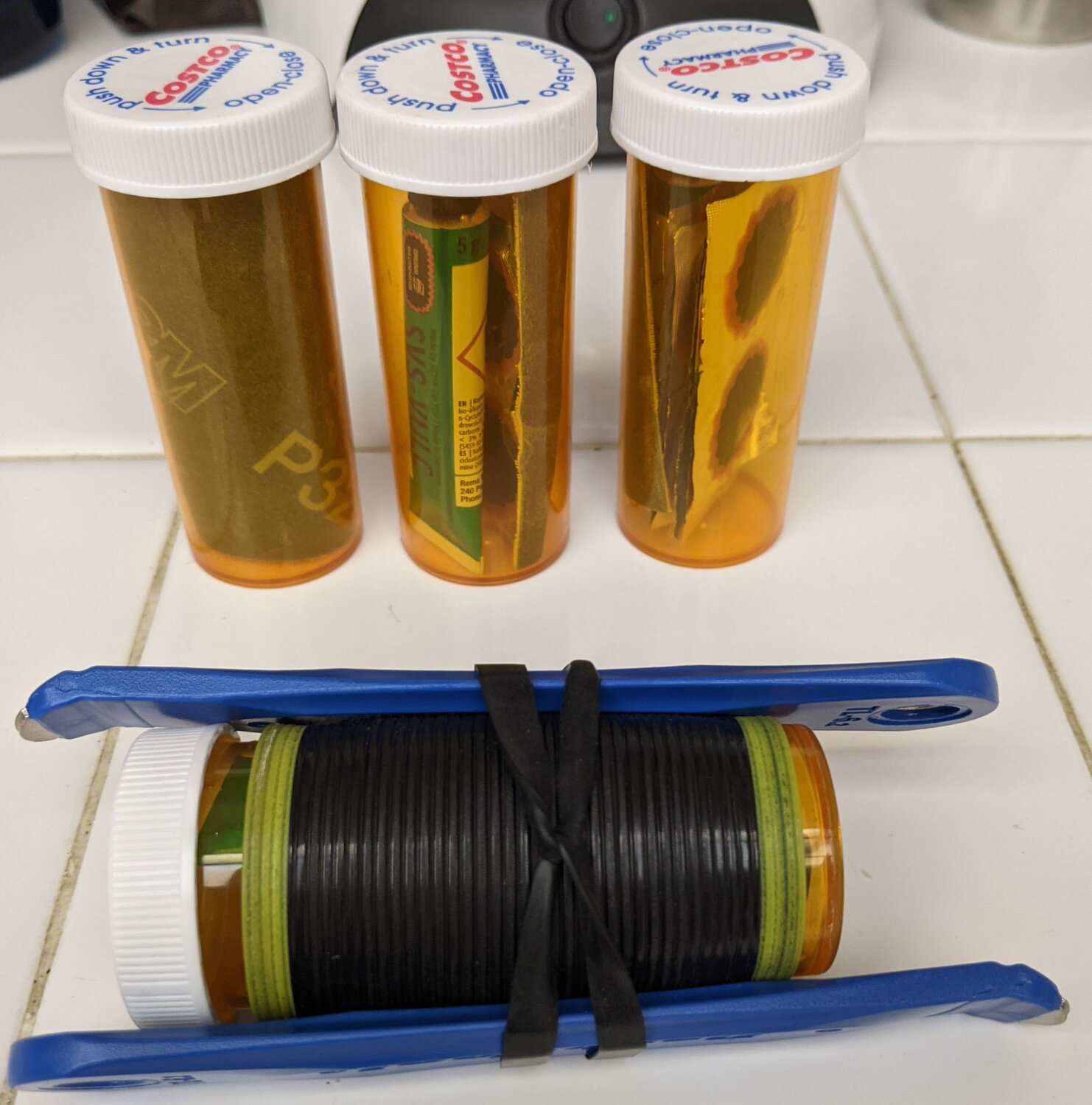

I have found that buying Rema parts (box of 100 patches, bag o' 5 tubes of cement) and supplying my own snippets of sandpaper works better than buying the kits. I use an empty prescription pill bottle for a patch 'box'. The adult-proof lid on the pill bottle plus the bottle shape itself makes for better packaging. Also when you buy the Rema cement separately you get a larger tube in the package. And of course you can carry more patches. I buy three different sizes. Links in the article below.
Something I also do on patches is, while I am sitting on the side of the road and buttoning the wheel back up, get a bit of road dust and rub it over/around the fresh patch (I also leave the plastic backing on). The idea being you want to stop the glue surrounding the patch from creating a weld of the tube to the tire.
