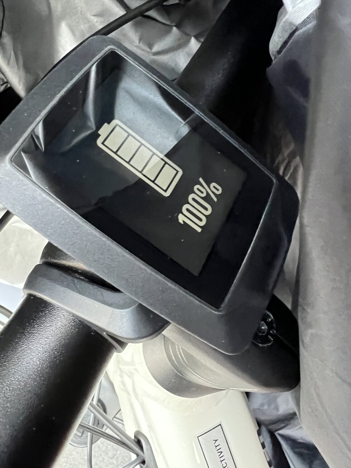

I’m having an issue with my bike’s TCD for 5 days now. The display only shows the battery life and it was dim as if on Stealth Mode (but apparenly Stealth Mode is not available in this model)
I tried the following but nothing worked:
  • Reseting the TCD
  • logging in/out of Mission Control
  • uninstalling/installing Mission Control
  • disconnecting/reconnecting the bike
  • fully charging both display and bike’s battery
  • Reseting display presets
Bike’s firmware is also currently up to date. Does anyone have an idea what’s happening? Is this a bug?
I haven’t gone to my LBS as I thought it would be an easy fix. I contacted Specialized but the only answer that I got was to check the brightness level in Mission Control. I already have it at 100% but it’s still dim. I also can still use the support modes but I’m unable to use the display as it doesn’t show any other information aside from battery %

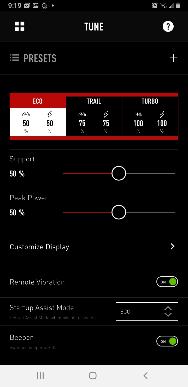

Very stealth. Pictures on the web and even on specialized.com show it on the tuning page. Unfortunately it does not show up on mine. I did reinstall Mission Control as there was a recent update. Maybe it is model specific.

What happens when you click "Customize display" in Mission Control?
Same issue when customizing the display. It was confirmed by specialized that Stealth Mode was enabled via my serial number. The corrective action is to take to an authorized dealer to disable. Apparently it was shipped in that mode. Luckily the dealer will not charge me. Slight disappointment so far.
