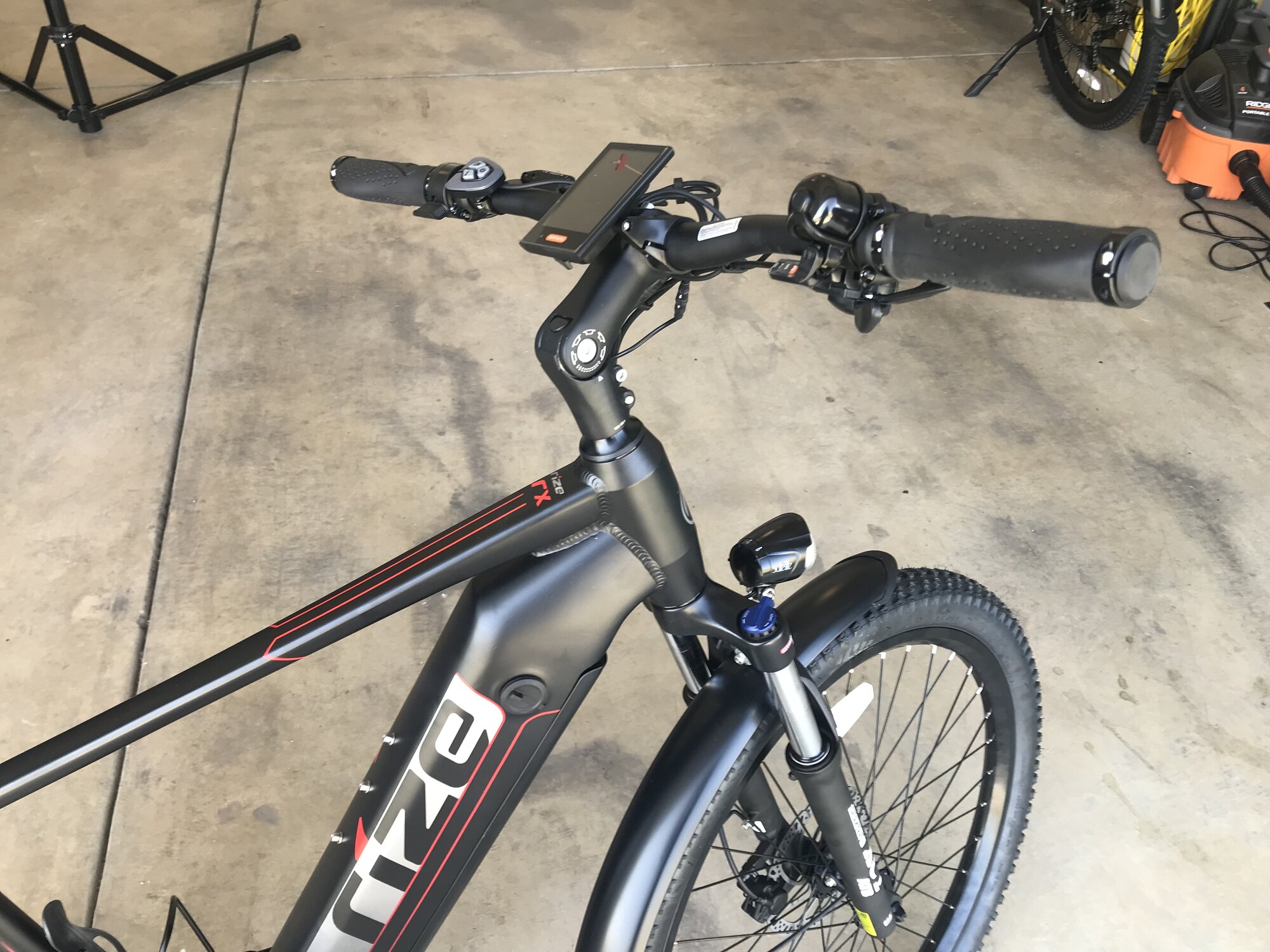

FWIW: My 2 Rize RXs just got delivered yesterday (9/26/21). I hope to post my thoughts in a couple weeks.

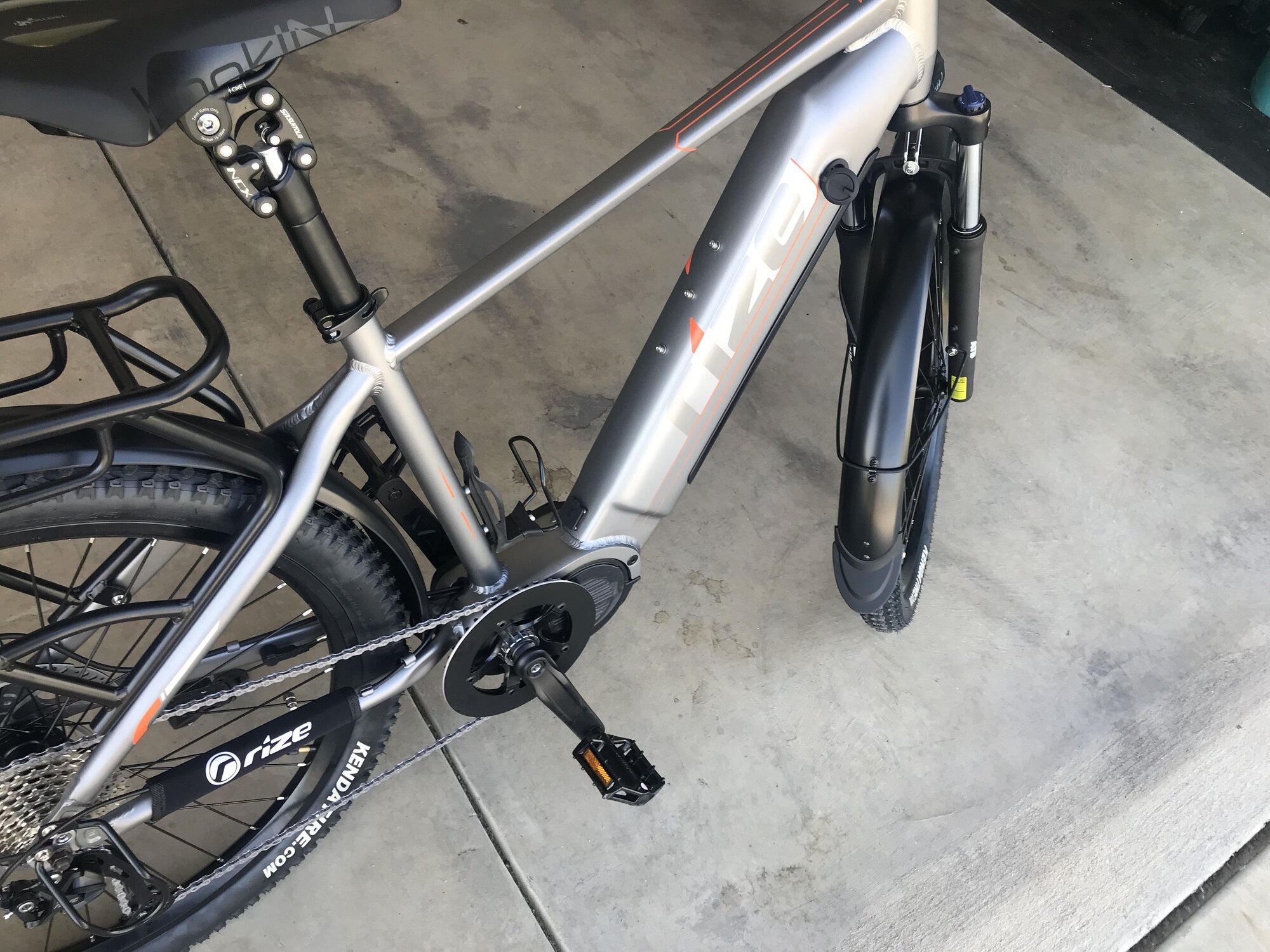

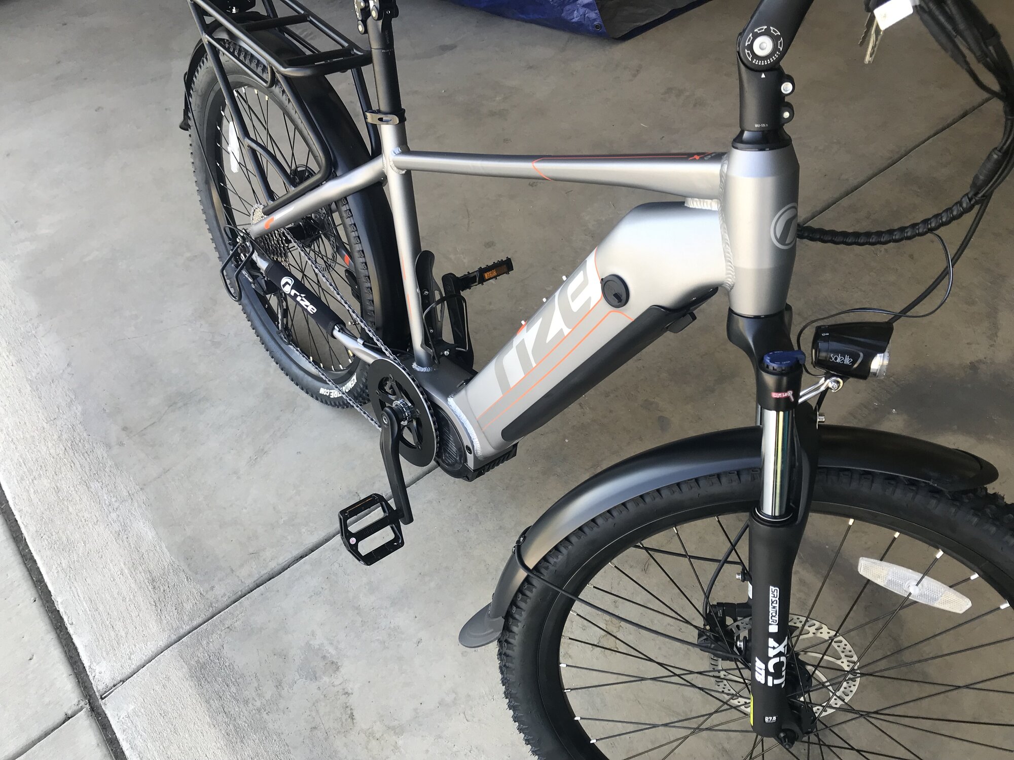

I received my 2 RXs. I really like both of the colors. The silver is much better than I was expecting. No issues with anything except the silver one had a chipped screen. I have to call Rize to ask for a replacement. I do agree with someone who said there is a lot of assist even on level 1. I guess gears 1-6 are really only for hills. I find myself constantly riding in 7-8-9. Granted, I have not hit any major hills yet. One question I do have is if it matters what gear I am in when I am starting from a stop? Do I have to gear down before stopping all the time? It seems like it leaves just fine from a stop in gear 5+ but not sure how it affects the drivetrain

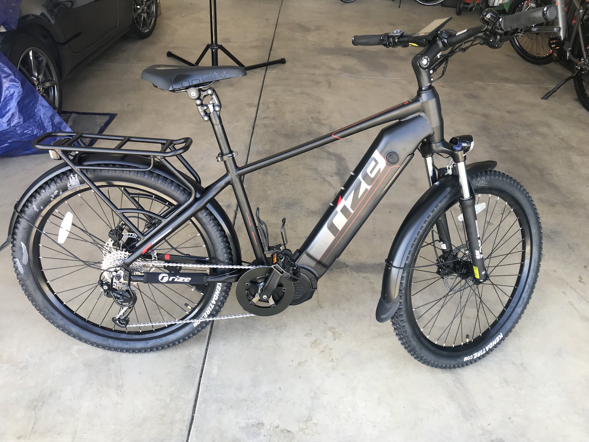

Rize RX 2021 - First Impressions

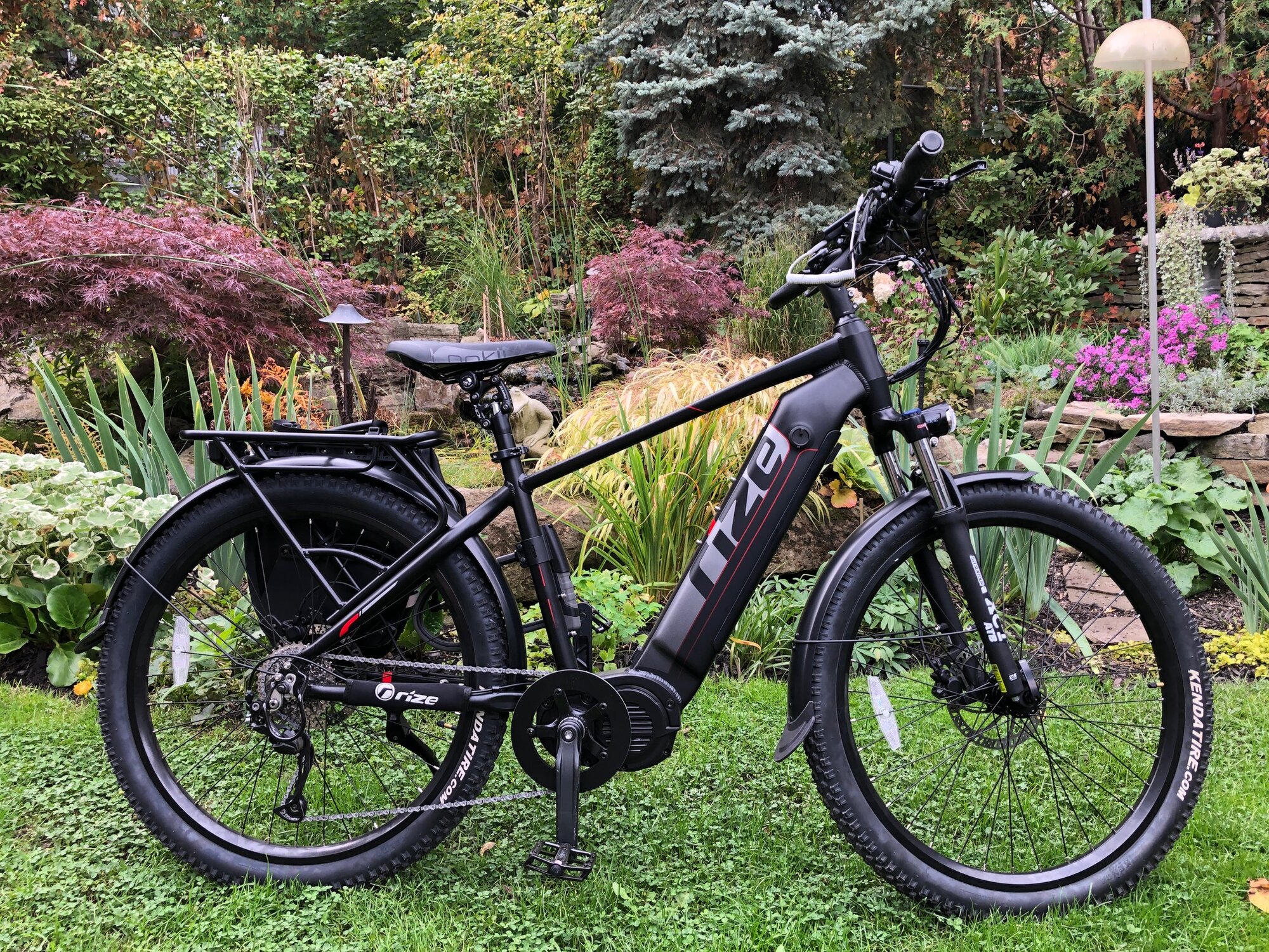

I just went for my first decent ride on my Rize RX (2021). It should be noted this is my first ebike. I rode a couple of Bulls bikes, some Aventons, and a Reise and Muller in the past just as test rides. I did change the PAS levels from max 5 to max 9. Not sure if that matters but it is good to know for this post. I rode a total of about 17 miles mostly in level 3. I did go to max PAS just for about 1 minute to see what it felt like but dialed it back for the entire ride. I did use the throttle intermittently while riding but was very careful to not over do it with the throttle. I mostly rode in gear 8-9 but was sure to start from a stop in gear 5-6. I would say overall everything was good. I do have some thoughts / concerns listed below:
  • It really gets up and going. I cannot imagine riding in the max or upper PAS levels. In PAS 3 (out of 9) and in gear 9, I maintained a speed of around 26-27mph. The one time I went to max PAS i was able to get to 35-36mph before i slowed down
  • I do not have a lot of massive hills by me but I can't imagine the need for gears 1-5. The hills I did ride, I never dropped below gear 6. I find myself using gears 6-9 all the time with most of the riding being in gear 8 or 9
  • I am concerned with the range of the bike. Under the conditions state above, I barely made it back home (17 miles total). For about the last 4-5 miles it felt like the motor was not really assisting and I could tell I was pedaling a 70+ lb bicycle. I was expecting around 30 miles and I thought I was being conservative at level 3 with minimal throttle

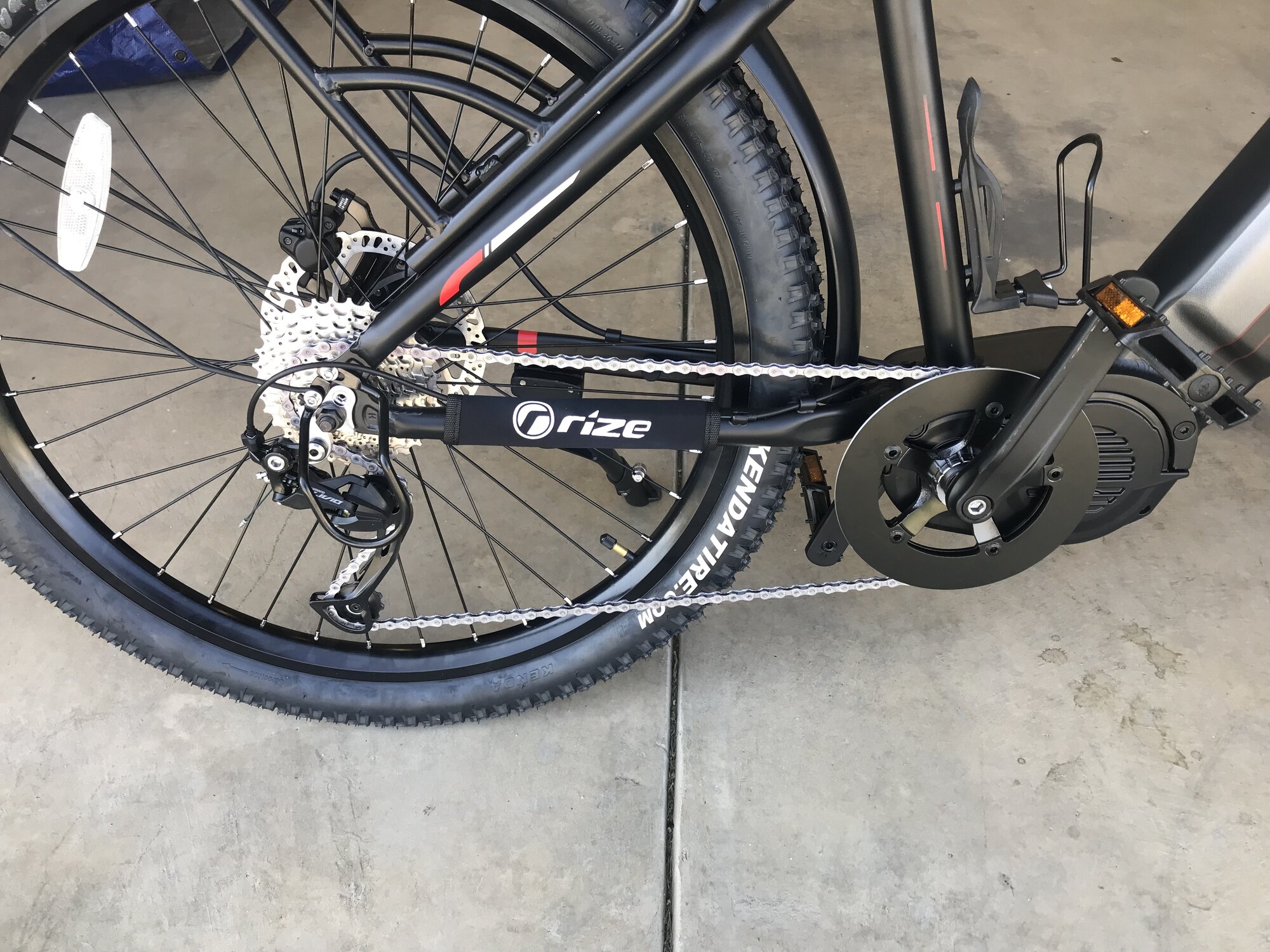

  • There is a very strange noise i noticed coming from the motor. I know what a typical ebike motor whine sounds like and this is not it. At first I thought it was a brake pad rubbing on the wheel but noticed the noise only comes when pedaling and the motor is working. If you coast and the motor stops, the noise is not present. The best way I can describe it is this: If you have ever ridden a manual bike with brake pads (not disc brakes) and the pad was poorly adjusted causing it to rub on the rim periodically, that is what it sounds like. I tried to get a video on my phone but it is hard to hear. Listen for the faint noise behind the motor whine. Here are two videos. Be sure to click the video to open Imgur and see the second video.

2. It is geared lower than most need. In stock dress I also never used anything below 3 and spent a lot of time in 8 & 9. I wanted to be able to contribute more pedaling at higher speed, so I swapped in a 49T front chainring and that shifted my gears about 2 cogs. I now seldom use 9 below 50km/h, but I use 2 and 3 regularly to get going, really steep hills, and for tight single track trails. That range works better for my use, and I still don't need 1.
3. My Ultra motor also makes that slight intermittent rubbing sound, but I couldn't find any obvious problem and it's at nearly 2000kms with no change/deterioration. I plan to tear it down and re-grease it this winter, so we'll see if I can find anything obvious then. The Ultras are generally know to be noisy due to metal gears - supposedly re-greasing with certain grease (Mobil SHC 100) helps - we'll see... Certainly post up if you find the clear cause.

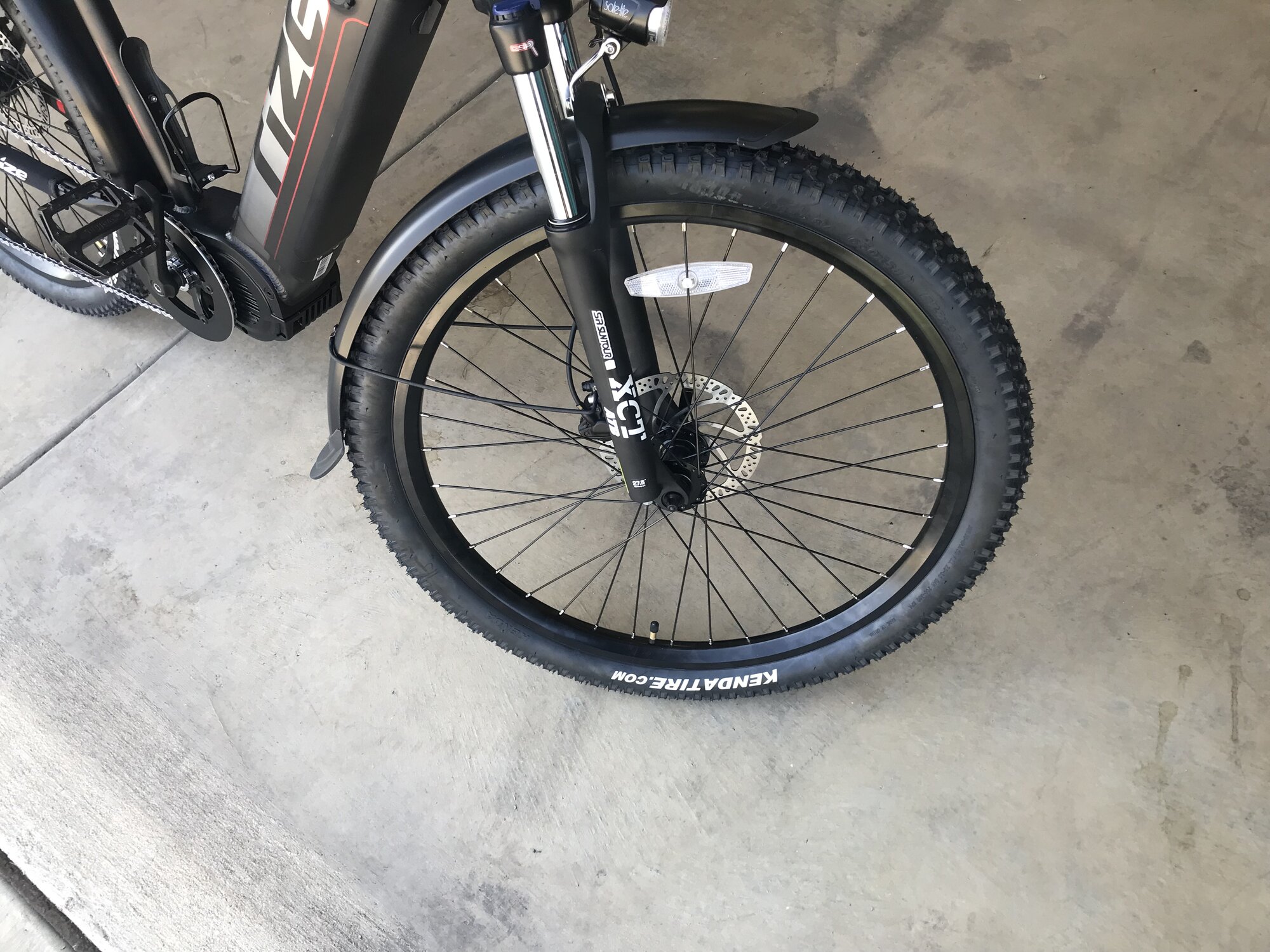

The tires, while noisy, are not anywhere as noisy as I thought they would be. They’re not as nimble feeling as hybrid tires, they feel pretty good overall.

The suspension forks are pretty meh. The preload dial on the left doesn’t seem to do anything. They also feel kind of jerky and not smooth at all. I ended up riding with them locked out mostly. I need to ask Rize if the preload dial is supposed to work on these or not. I read somewhere that the 2020’s didn’t do anything either I think.

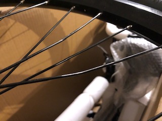

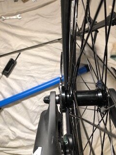

Rize RX 2021, after a substantial delay in shipping and several false starts (was supposed to be shipped but wasn't, it took a week to leave Rize after the FedEx ticket was raised), it arrived last Saturday. The Box was really banged up and I was expecting the worst. First thing I took out of the box was the front wheel, three bent spokes and I later discovered, a bent front rotor. I thought it was going to be all downhill from here, dreading a bent fork, but in fact, not much else was damaged. A scuff on the pedal and a scratch on the front rim and a bent spring on the cheap bell. So I ignored the bent spokes and spent some time straightening the front rotor, fiddly but not difficult. I got it good enough so it didn't rub and adjusted the brake. The weekend in Montreal was beautiful so I've clocked up close to 200 kms now. Takes a little getting use too. The surge when you set off on one peddle and cock the leg takes a little getting use too, so if I have any sought of down slope I now just set the level to "0". I've set 9 levels and spend most of my time in level 1. In fact today around the old port of Montreal, I just left it on 0 otherwise you get free wheeling then a surge. I've also spent quite a lot of time trying to get the derailleur adjusted (Park Tools has a very good video on this) and its still not perfect through the whole range of 9 gears. But I've had a ball and love patiently working through the teething problems.
Anyway all this to say, I wasn't sure how Rize would respond, re; the warranty and my fiddling around. Maybe would want the front wheel returned and there goes the last of our good weather!! I proposed them sending new spokes and a rotor and they responded yesterday (Thanksgiving delay no doubt) and agreed. Just give them a quote for the labour and they'll sought out the warranty. No quizzing, no BS. They are sending new parts immediately. My regular bike place is not allowed to repair eBikes so will have to find a repair shop that will do the work, but if I can't, I'll do the work myself, not rocket science. So overall, disappointed with the shipping but the bike is fantastic and very pleased with the Rize attitude, support and flexibility. No formal mumbo jumbo.
