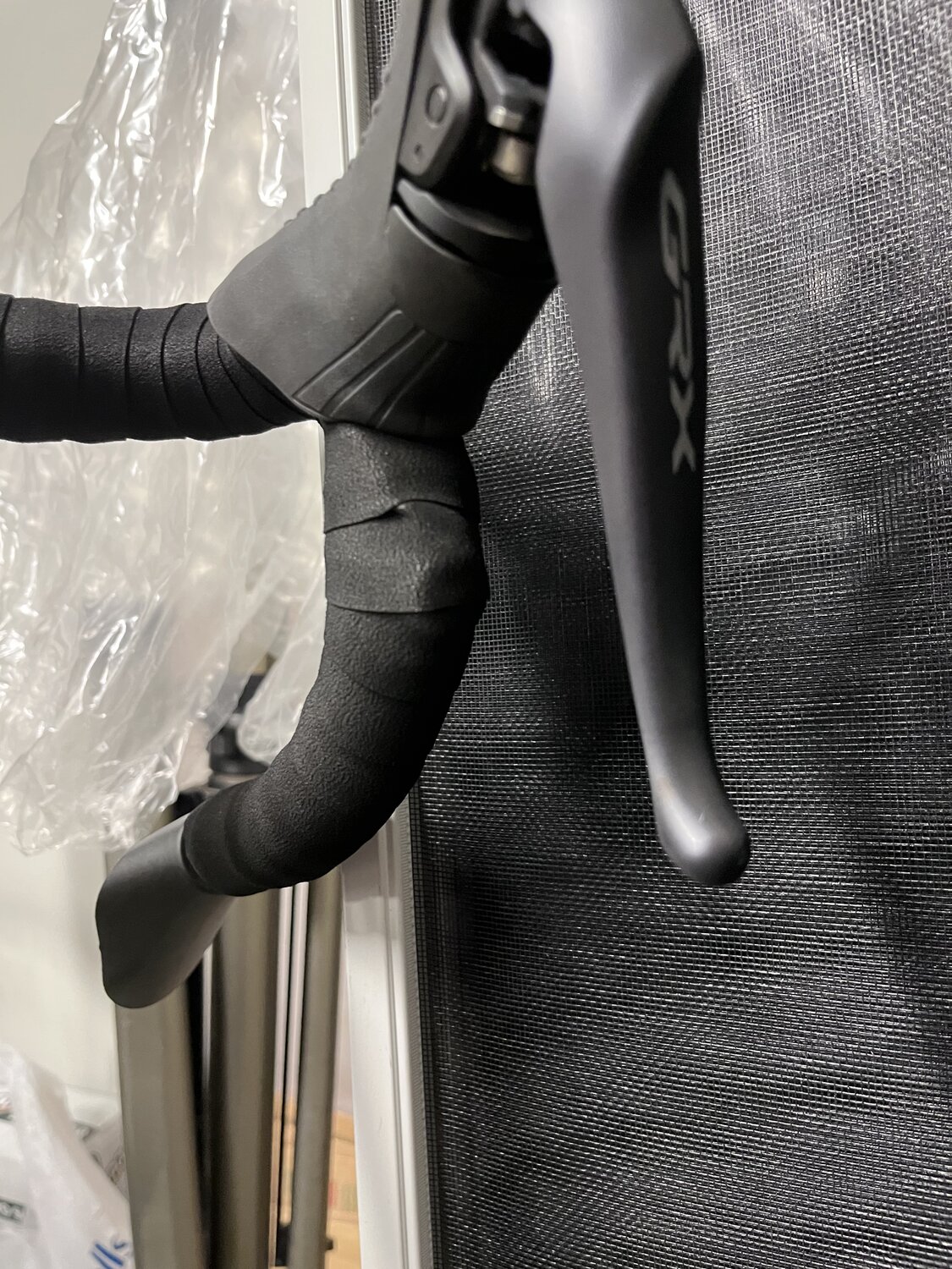

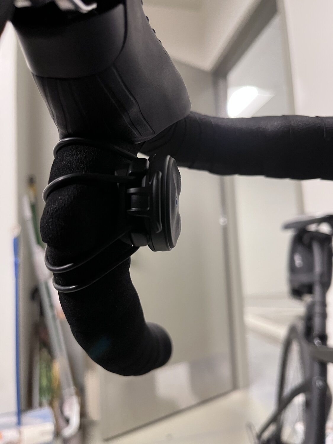

I just had remote buttons installed on Creo Carbon Carbon and am relatively pleased with the aesthetics and function. Kudos to Cadence Cycling in Philadelphia. The lighting makes the shifter on the right a little difficult to see but the tape is wrapped over a minimalist bulge. I have a Garmin Edge remote on the right shifter and the Creo remote is actually fixed between the upper and lower bands. The install is better visualized on the left shifter. I have some concerns about wear of the bar tape over the buttons, however I usually leave the power setting in ECO or off and don't "shift" that often so I think wear will be minimal. The other gain I hope to obtain with the buttons is the ability to obtain power data while the motor is on but assist is off. IMG-0600.jpgIMG-0601.jpg

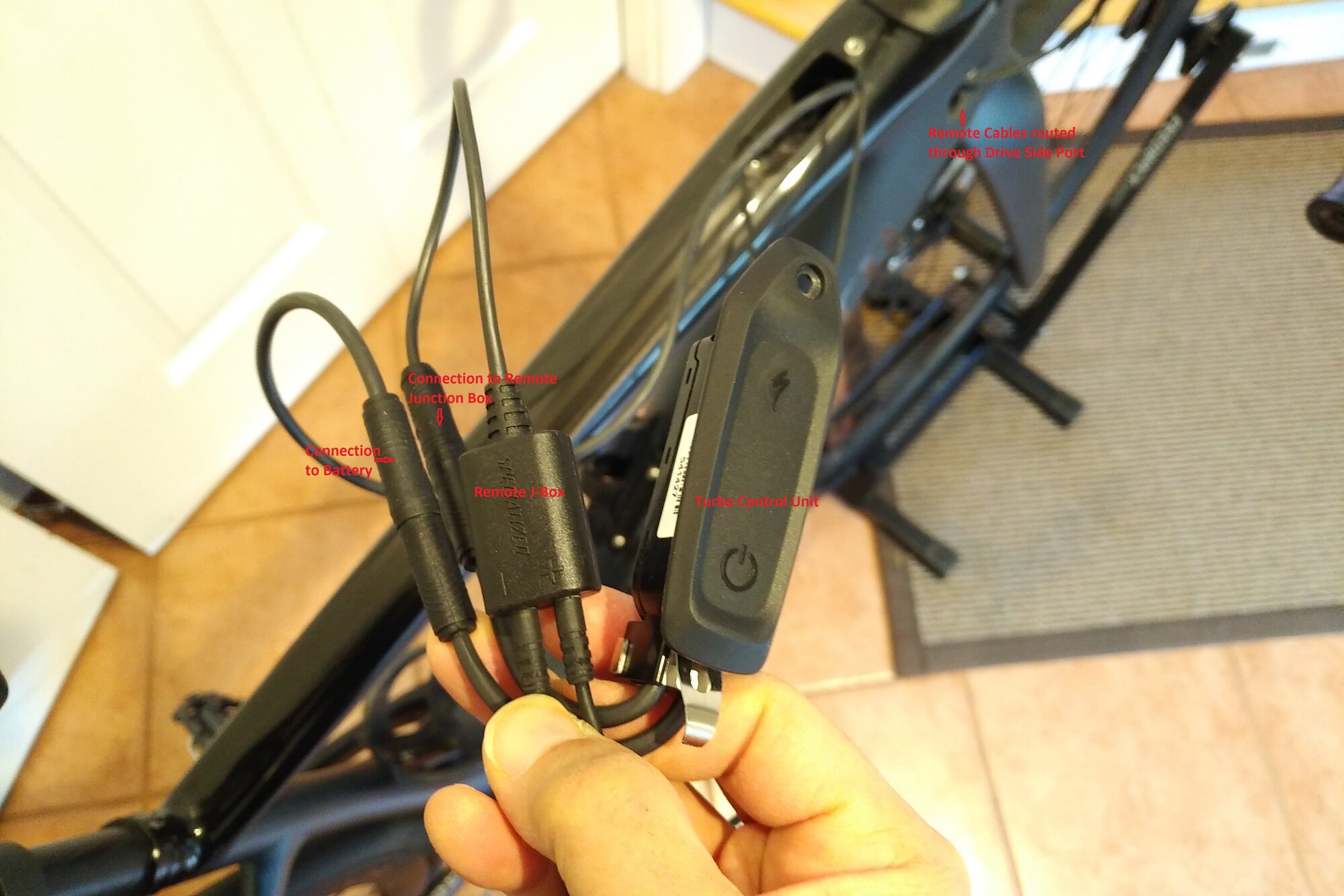

It shouldn't be any different from the Levo remote. The TCU will have a vacant female plug and it's simply a matter of plugging in the junction box/remote connector. Just make sure that you have the +/- buttons on the corresponding bar locations where you want them placed as the cable themselves have no visible markings to indicate this. ie + button increases support, - button decreases support. The connectors to the junction box need to be seated all the way in until you can hear a distinct click. If they are not fully inserted the remotes won't work. There is plenty of excess cable along with the junction box and connectors all which require care when it comes to storing them inside the frame.
If you own an EVO you are already a step ahead of those of us who have non-EVO versions as the appropriate ICR port is already in place. From what I understand, new MY Creos will come shipped with a parts box supplied with a replacement port. It's plausible to think that some shops have simply gone ahead and routed all cables through to the non-drive side since early models would have been shipped with just blank versions of the ports. I'm not even aware if they are available yet so it's prudent to check with your own Specialized dealer. Part # for the replacement ICR port is S196500006.
I just bought a new, 2021 Turbo Creo and Turbo Remote kit. I can confirm that the parts supplied with the bike included an S196500006 which is referenced, but not included in the Turbo Remote kit.
