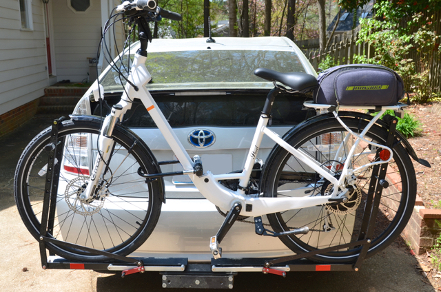

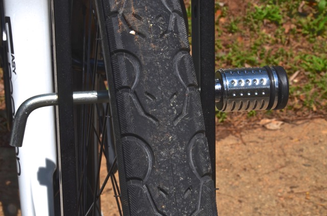

1upUSA Heavy Duty 2x50lbs $529, Super Heavy Duty 2x75lbs $559. Pros: Love the design and ease of use. Folds up well. Could store in back of RAV when not in use. Con: called 1upUSA directly, does NOT recommend from use with rear fenders for heavy bikes (i.e.: ebikes
Thule Easy Fold TH9032 $699 2x66lbs Pros: designed for ebikes, clamps directly to frame, can be stored in back of RAV when not in use, lightest rack at 37-40lbs. Cons: Does not fold up towards back of car to reduce profile when not in use. 700 freaking dollars.
Personally, I would love to get the 1upUSA, but just not comfortable based on their answer (some fender alternative may be in development).
