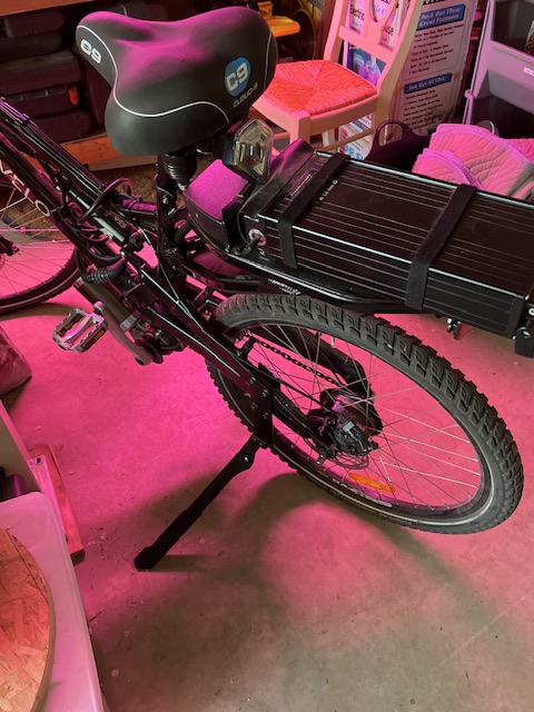

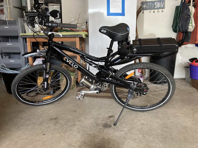

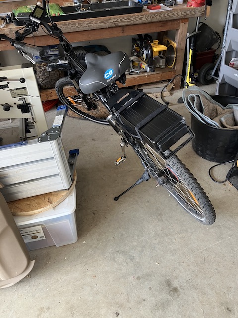

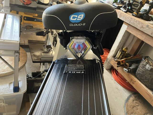

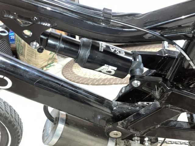

I purchased an Aries model in 2016. Despite good intentions, I only put about 420 miles on it the first six years. In 2023, I committed to riding more but my battery was dead and the standard replacement was no longer available. I rebuilt the backend of the bike to accept an eBay sourced replacement. I went thru a few tweaks before the battery and mounting plate were rattle free. But the range improved. I added about 340 miles and replaced tires and tubes, that year. Early 2024 the drive train became noisy and with Evelo’s great support, I was able to tear down the motor, replace some internal bearings, add new lubricant and begin to ride regularly. I replaced the NuVinci and brake cables and sheathing mid year and upgraded brake calipers to hybrid versions and the airshock in the fall. These upgrades improved smoothness of operation, improved braking performance and eliminated brake squeal. Also replaced the Ended 2024 with about 1260 additional miles. This year I have a better start but kickstand seemed to be getting tired and bike began leaning too much. Original kickstand is a unique design and locating one was impossible. I fabricated a mounting bracket and added PDW Sturdy Lad kickstand as a replacement. As I have tweaked or upgraded almost every thing on this bike, feel free to reach out if you have similar questions with this old Evelo bike model.
