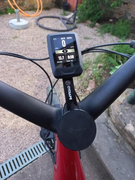

How do you mount a phone on the Como (22-23) ?
Fender
Europe
Lyon
The handlebar is so specific, how do you mount a phone on this ? the 22mm part is so narrow and the rest of the free handlebar has a profile incompatible with 99% of mounts, so how do you do it ? with pics please :)

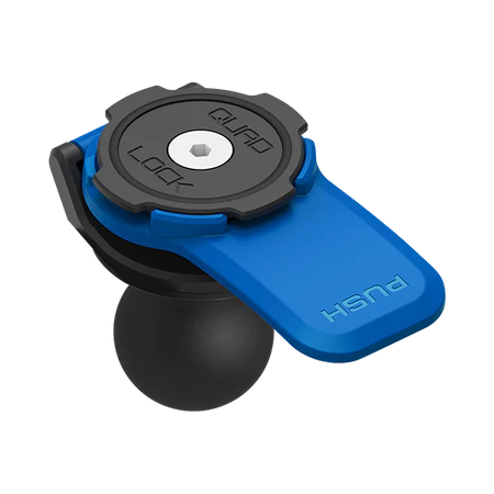

@Fender - What is the width of the handlebar stem/base? What about a clamp similar to the idea that @Bavi suggested in option 1? RAM makes a variety of clamps, extension sockets, and even phone mounts that you could attach to the base of the handlebar and articulate it in a manner so that the phone is at the same the height of the stock display either facing out front or having the clamp attached to the rear of the handlebar stem. The articulating sockets are what makes it so adjustable. I don’t know how secure the Ram phone mounts are but you could always use a 1" Quadlock ball mount attached to a RAM extension.
I use a RAM Tough claw to hold a handlebar mount/platform for a drone controller and I can attest that it has a firm grip on the entire assembly. I admit that it’s not as elegant as a custom-made mount but it can be attached and removed in seconds and the phone would obscure what’s holding it in place anyways.
i have an old ram double ball mount for a motorbike, with the old U-screws clamp I'll check if the rest of the form factor is usable with the handlebar

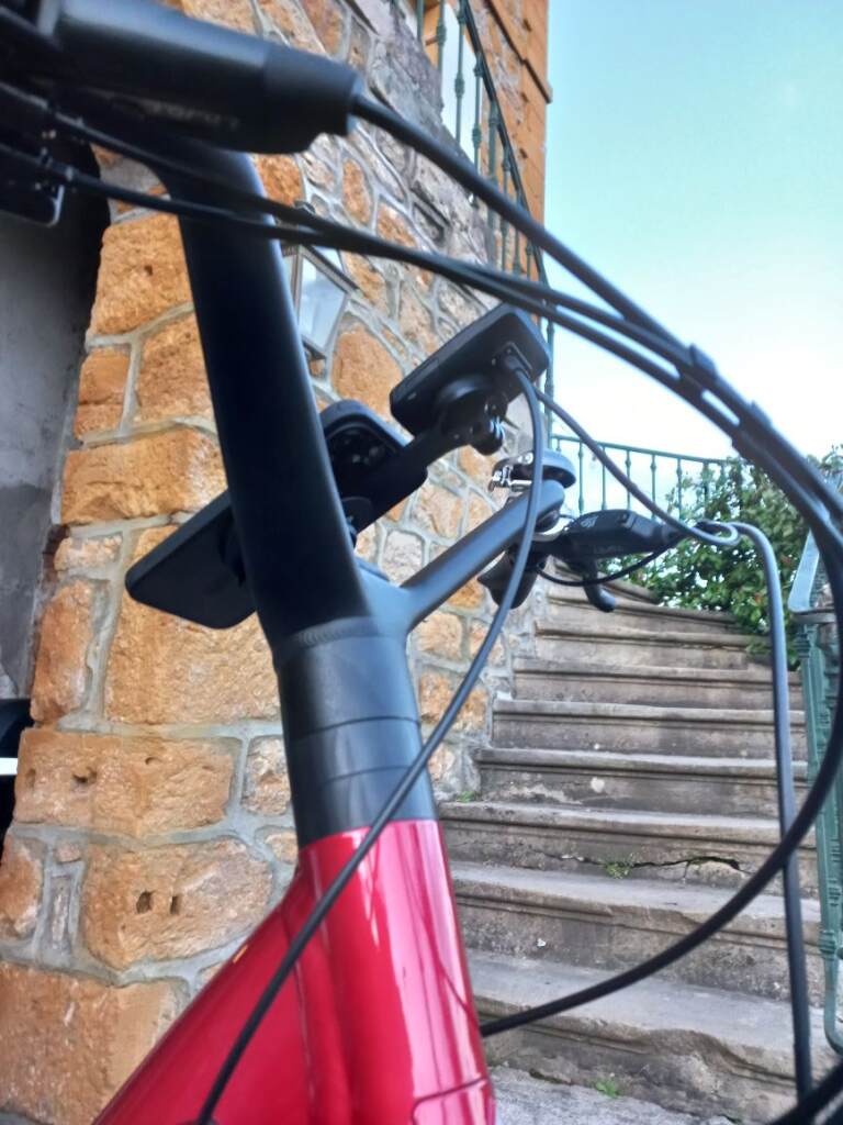

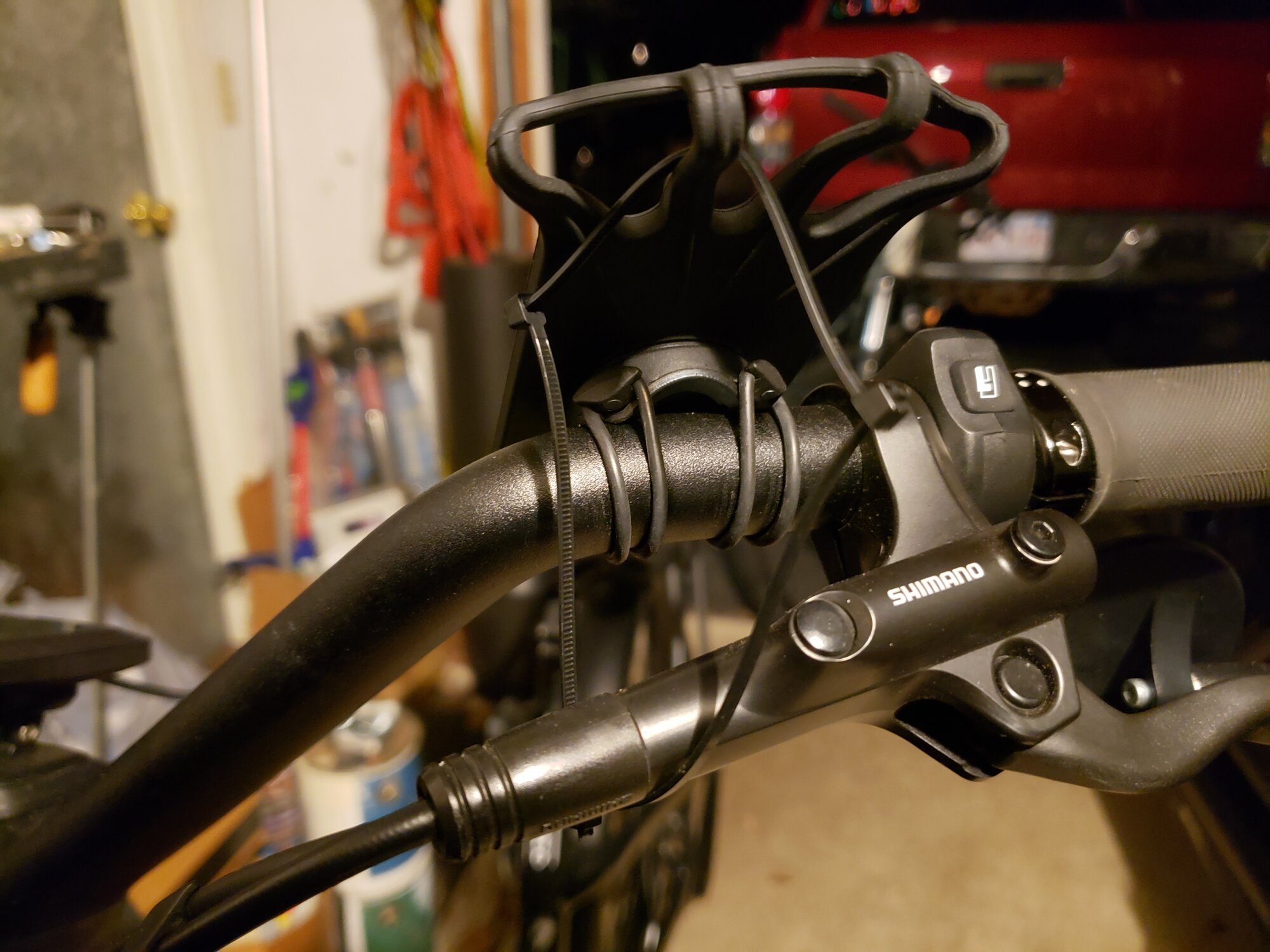

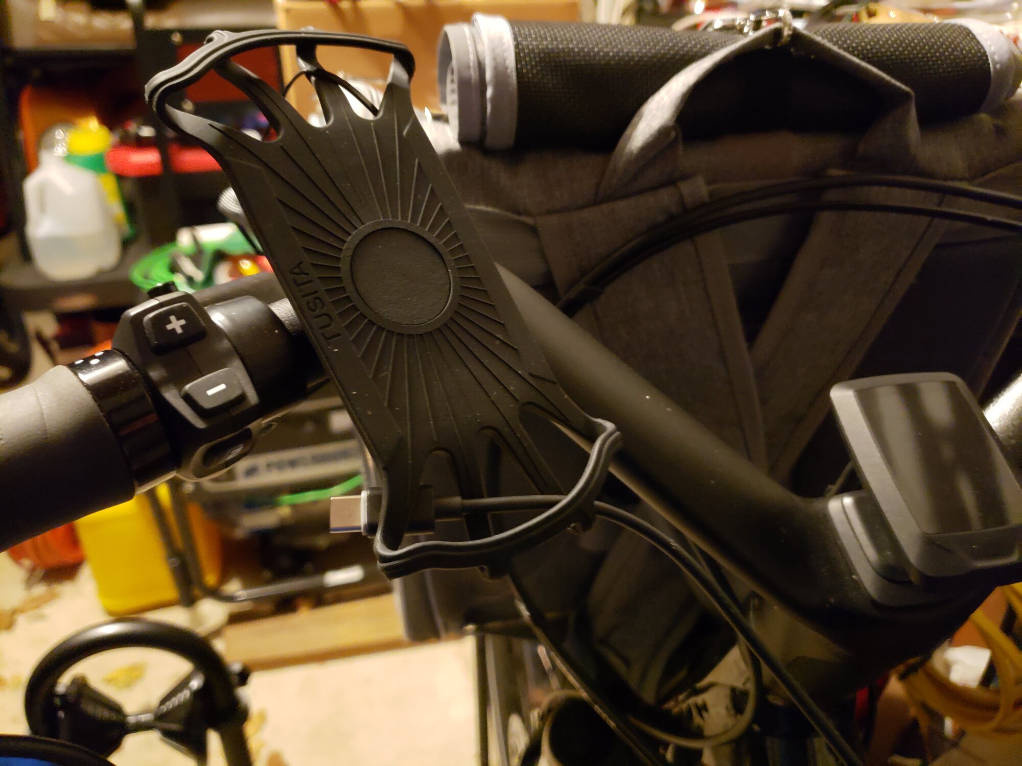

Wife's Como.
Cable ties are just for backup since I am not totally comfortable with O-ring mounts, especially on bumpy trails.

^ I notice they are Shimano brake master cylinders, are they standard? Mine came with Sram M/Cs and from memory are bit more bulky (and possibly offer a little less free real estate)
Good info nonetheless 👍

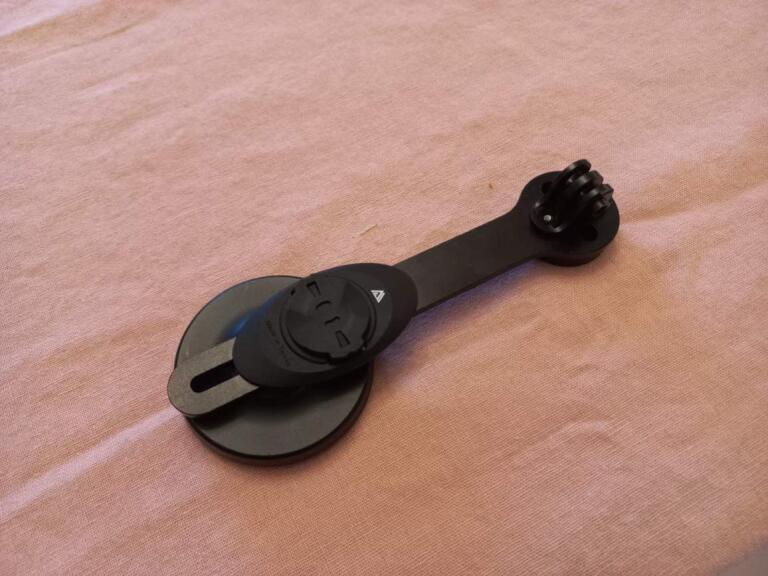

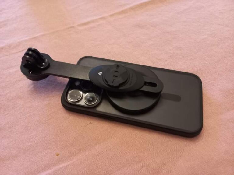

oh I just had an epiphany moment.

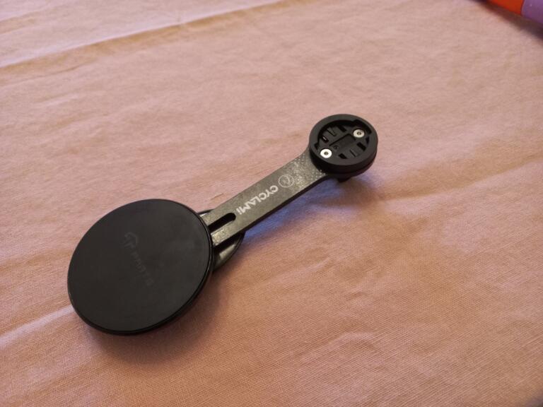

The TCD mount is a garmin mount, so, an elegant solution would be to have a custom phone case with a garmin male part mount on the back/center and on the upper part of the phone case, a female garmin mount to put the mastermind TCD. and when you don't need the phone, voilà, back to normal !
Need to find that or make one myself, but seems doable

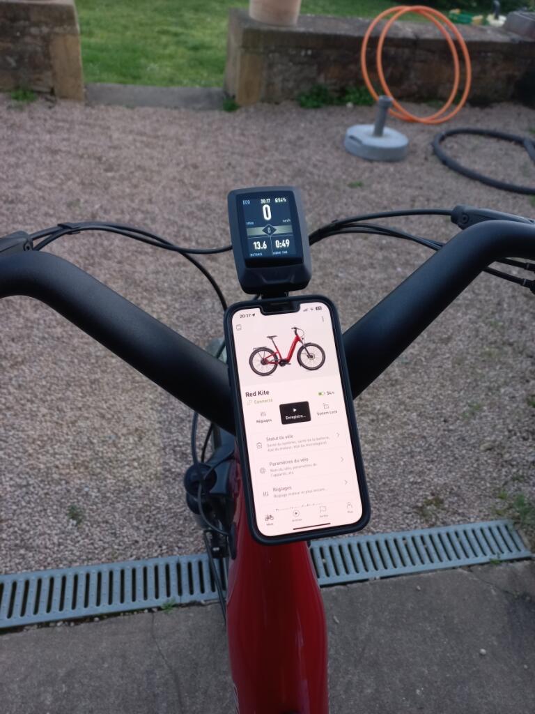

@Fender I have used this with great success.
Yeah I need to find something to stick exactly this, a plate and a female garmin mount under an iPhone case
