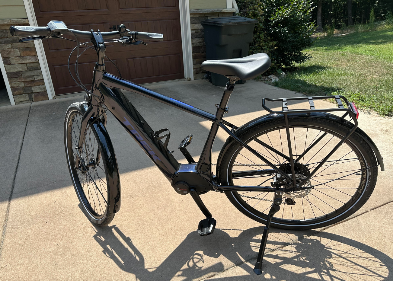

Hello from NC. I have been biking forever and just bought my first e-Bike as a Trek Verve+ 4S. I wanted a bike that could double peddling for fitness, but also enjoy exploring other cities when traveling in my RV. I also bought a Kuat NV Base 2.0 as it pairs well to the additional weight of the bike. I found this forum while searching for an empty (or fake) replacement for the battery holder. I would rather not leave the battery installed while it sits atop the NV Base both for weather/temp and dirt considerations. Seems it would be a good idea to keep the battery inside the cabin, but also protect the battery tube contacts, etc. on the bike as well while transporting. I also picked up a Comnova bike cover to help keep road debris off the bike, but that isn't a guarantee in my mind. So if anyone has crossed that bridge already I would appreciate any advice or ideas you have. Other than that, I think I'm good to go until I have some miles under my belt. Looking forward to learning everything I don't know..!!

Thought I'd follow up with result from all this good dialog. I went with @pmddonald recommendations so here's result. The pin cover is a no brainer! Here's some pics showing ping cover package, pins exposed, and pins covered with pin cover.
Next is the neoprene downtube cover packaging, as packed, and installed. The only downside with this one is you have to take off the bottle rack. Small price to keep you unit safe and sound... All in all I think this works well for not much $$$.
Want to thank everyone that chimed in. Appreciate the help with this! Love this forum! Hope this helps someone else along the way.
