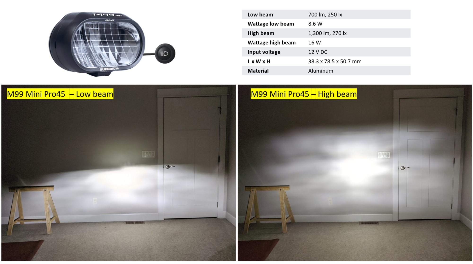

Here are the comparisons with Supernova M99 Mini Pro-45.
Ravi, as you know I have the M99 pro. It has a very good spread and bright. Definitely sufficient for almost any kind of riding. I rode a lot at night and cars coming from the side roads realize that you are coming their way.
Now is it worth 450? I don't know. Given that 1000lumens cree leds are out there and used even in $30 bike lights the brightness can certainly be matched for a lot less.
The optics(mirrors especially) will surely add quite a bit to the cost still $450 is a bit high. Also supernova blinds people and quite taxing on the battery. Still it is a great addition to any bike and imo improves safety significantly.

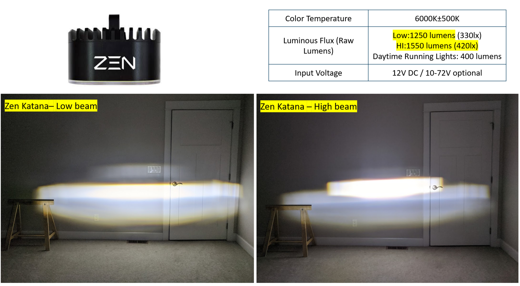

It is hard to make an accurate assessment of the Zen light from the photos. I would think the brightness is very good. maybe as good as m99. But the vertical spread looks a bit too narrow. Does it illuminate the road surface well? At night it is quite important, to maneuver around holes, cracks etc. , especially at higher speeds. I can not make it from the photos.
Of course. It is just as bright as the M99 Pro. You will be surprised how bright it is.
Because the photo was taken in a closed room with limited space, the beam looks compressed on the wall but on an open road, it spreads out quite well and long actually.
It is just not about the cree LEDs but also, the quality of the lens, thermal management when run for hours on end, the electromagnetic shielding to minimize interference with other electronics.
Keeping those LEDs running at 1500 lumens without hitting thermal bottleneck is not trivial.
As you can see from the test data below for a light that doesn't thermal management built-in, it leads to loss of power. We will do a full review with video in about 3 weeks comparing different lights.
That is why I mentioned optics. (Back in the day when I was taking an Optics course one of the things that the professor mentioned was "Although the math is easy, manufacturing a good lens or mirror can be very expensive so they take shortcuts ", I don't know how things go these days)
-I can see the cooling fins on the back of the light so it should have no problem with cooling.
So again I am sure it is just as bright and doesn't have any thermal issues.
-The mid section is bright so I am also certain that the long distance illumination will be good.
As you said it is hard to assess the spread in a room. Assuming that you put both lights at the same location if you look at the legs of the stand on the left while it is illuminated well by m99 , it seems a bit under illuminated with the zen light. Don't get me wrong, It may still be very well lit.
When you have the time you may want to take a couple of photos at night outside that should demonstrate the capability of the light even more.

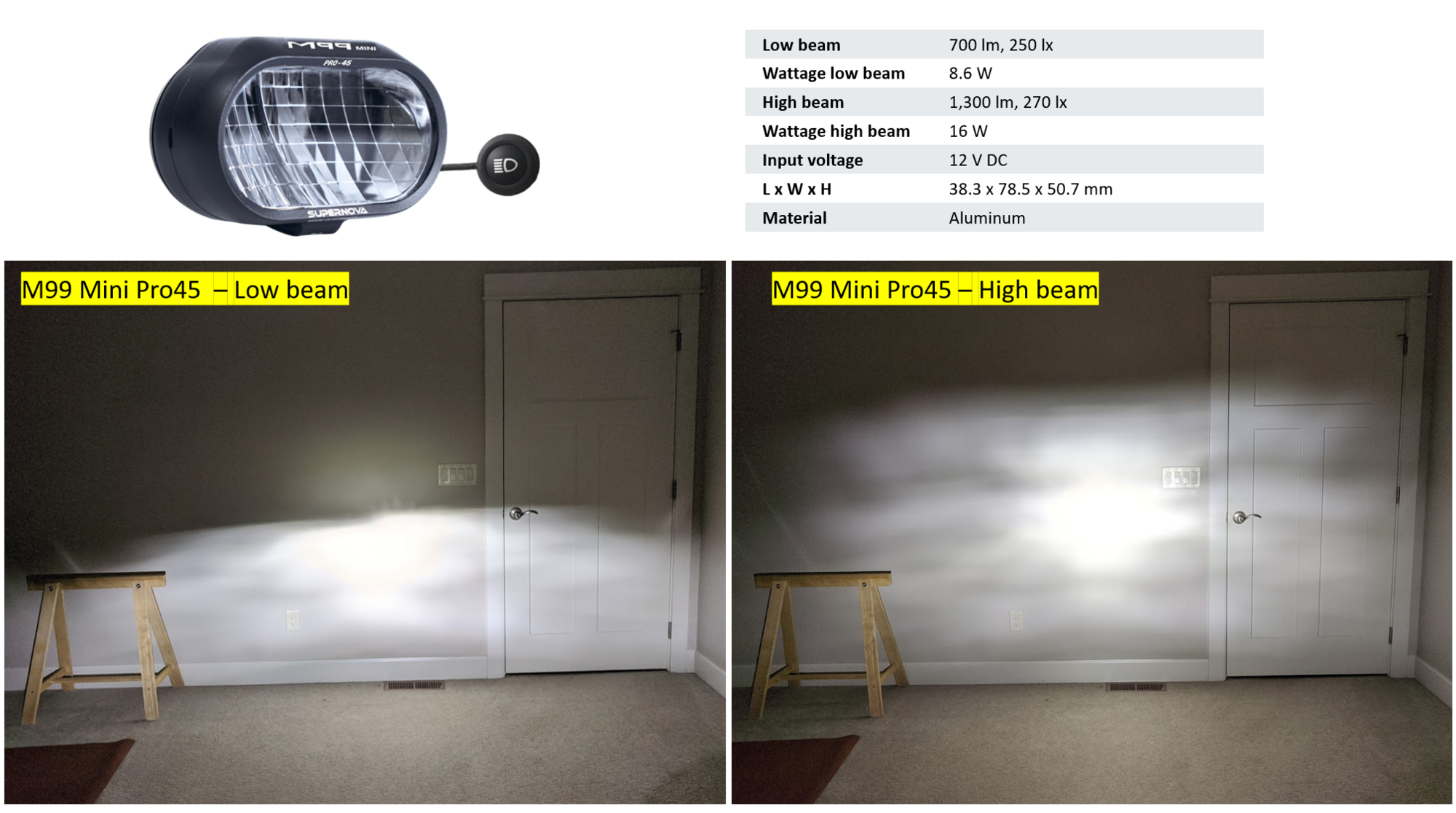

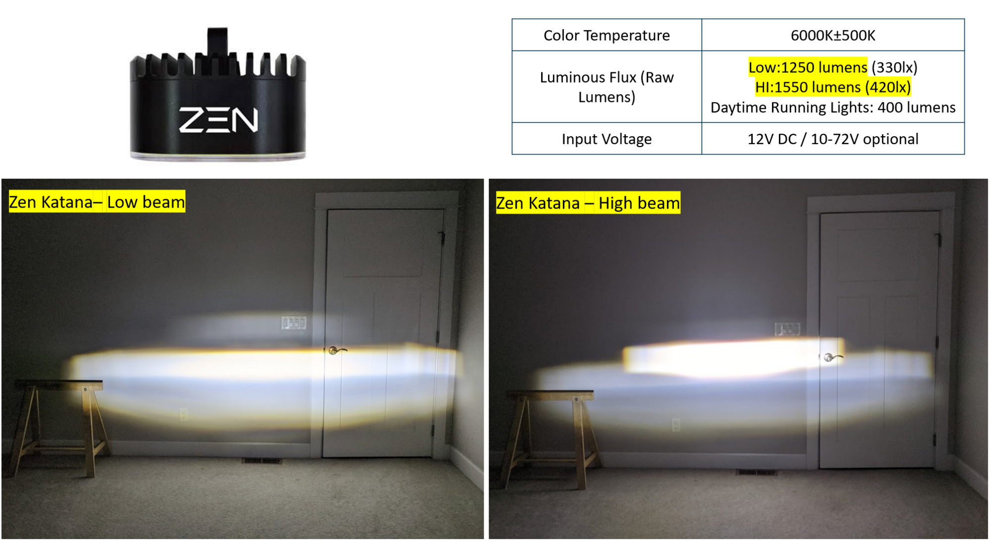

The beam cutoff line looks super sharp... well done!
Kind of cool @Ravi Kempaiah if you did a light shootout, the way MTBR does theirs, but for e-bike specific lights.
Nothing trumps how lights perform in the real world though. These pictures look great but camera settings can make a huge difference.
Seca 2500 with the 3cell battery is the ultimate ebike headlight. That or Lupine . It stops cars, Suv's , foxes , squirrels you name it ...
If the Zen would be made with auxiliary cells (like the 2 or 3 cell batt. for Seca) it could be pretty good for the price). But Seca also has outstanding warranty and service. I shorted a prior Seca headlight in a very heavy downpour ride , i got a new one in 2 days.
The brighter the light , the safer the rider is. Cygolight hotshot or Lupine for rear.
I absolute love the sharp cut off line!
If I could make a criticism though, judging by the picture, the high beam isn't that high.
If I'm using high beam, I'd like my high beam to scatter around like cars / motorcycles headlights.
Is there any way to fix that?
I know Ravi didn't say he was going for StVZO standards (Germany), but you also don't want the light too high to be blinding. Hard to say from this picture if too high/low.
