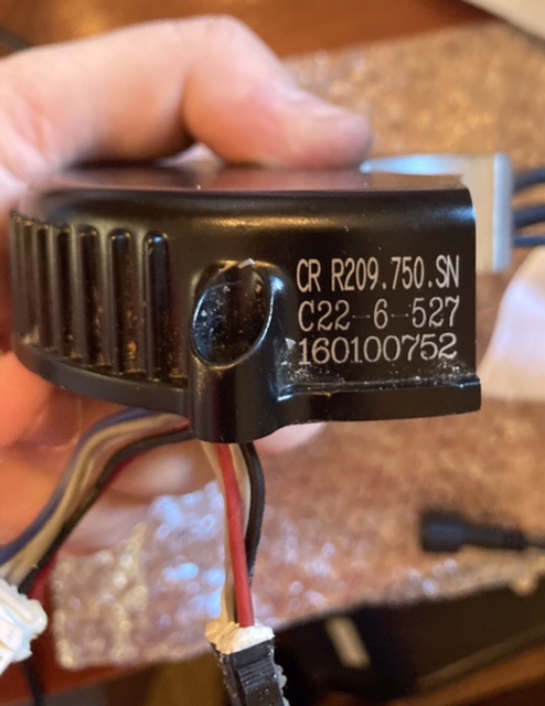

Yesterday I tried to reprogram the replacement BBS01b controller to increase the current setting from the 15a factory setting to 18a, only to face an Error 11H on my 965A display which then would stop working so I could not change PAS level without turning the display off and on again when stationary, I also lost walk assist and throttle, though the motor still ran when pedalling. Reflashed the original .el file backup settings and the problems disappeared. Googling around I found this problem reported on the German Pedelec forum as well. It appears from that discussion thread that BBS01b motors like the one I have that were made in 2016 (serial # CR R209.750.SN C22-6 527 160100752), and also made in 2017, must have some firmware from Bafang that throws this error if you try to increase the current above 15a.

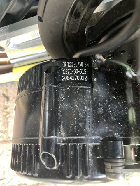

New 2020 36v BBS02b controller fitted to BBS01b motor
Old 2016 BBS01b Controller locked to 15a
Are there any other numbers on the controllers you have? I just read that a 206 was the generic FETs’ and 206.1 the updated 3077 FET.
Hi Tom, no other numbers on the controller.
