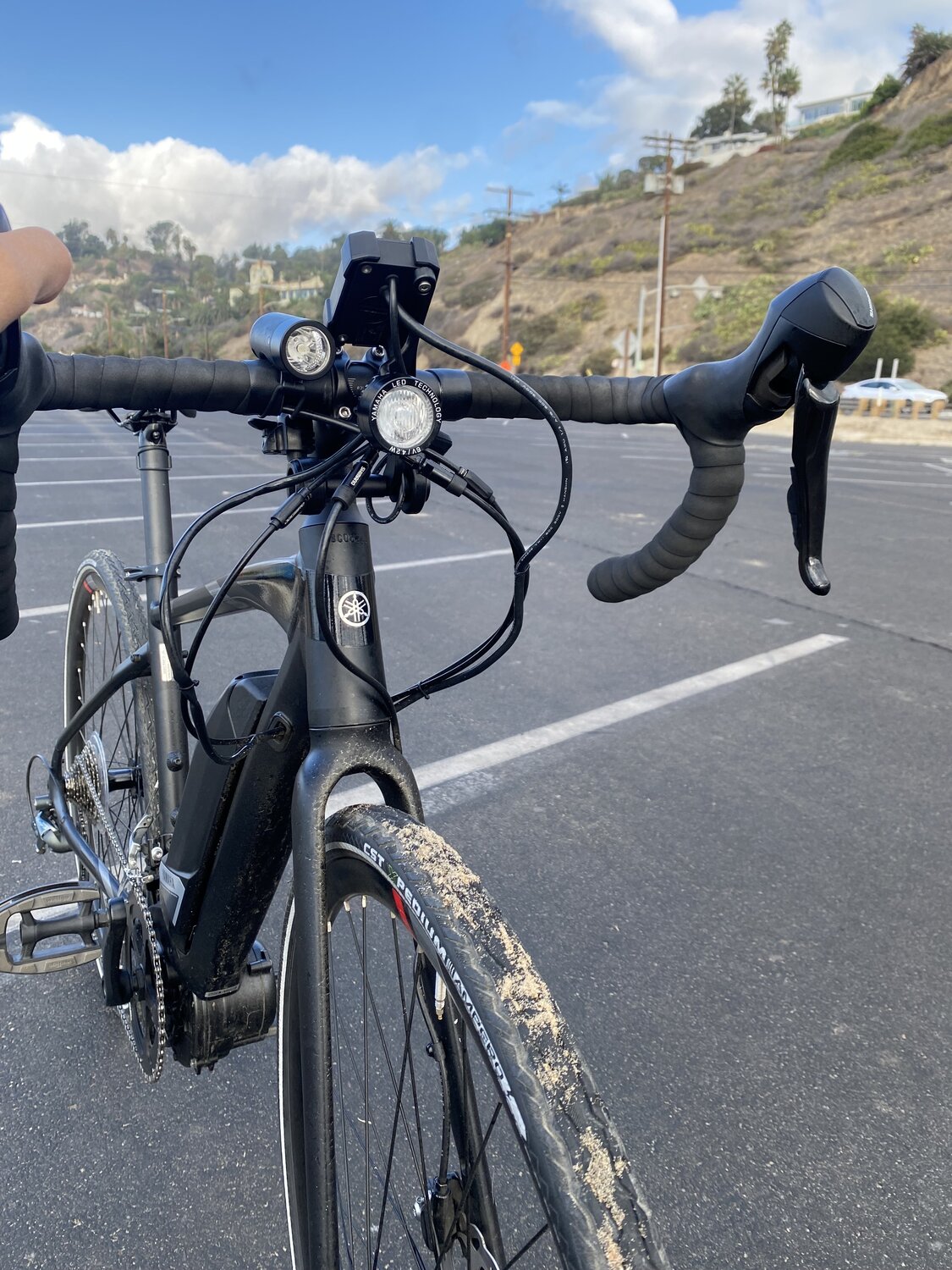

I don’t have any issues with chain slap at all. Chain is definitely not coming off. The chain line and both derailleurs needed a tune at 350 miles but I have not needed to retune since then. I’ve recently taken off the “dork disc” since it was starting to crack and have no issues.

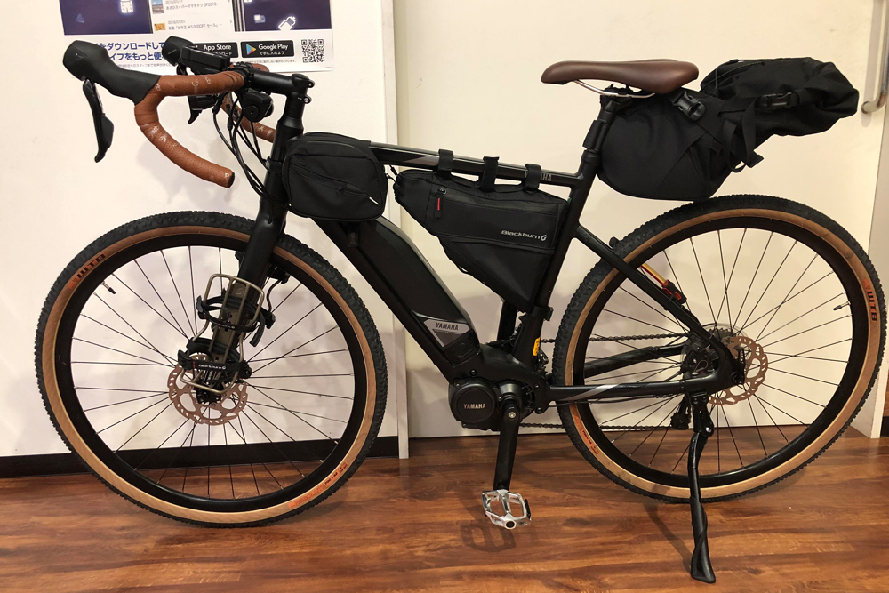

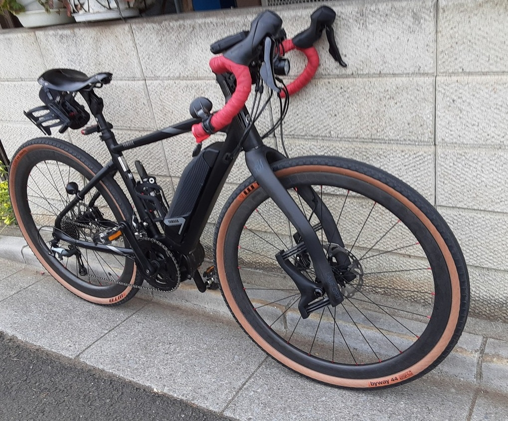

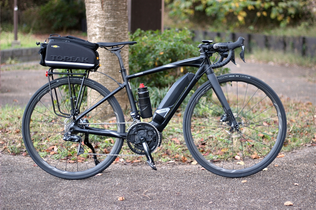

Here are some fun custom bikes. Really shows the flexibility of this Yamaha frame. They can be setup for whatever you want them to be. Enjoy the examples!
Rough Road Setup: Fatter tires and Lauf suspension fork.
Fast Roadie: Upgraded to Shimano RS wheels, carbon fork, Ultegra levers and lighter cranks it seems. They figured out how to mount the rear speed sensor on a non-stock hub.
Loaded Tourer: Bags galore and fork cargo cages.
