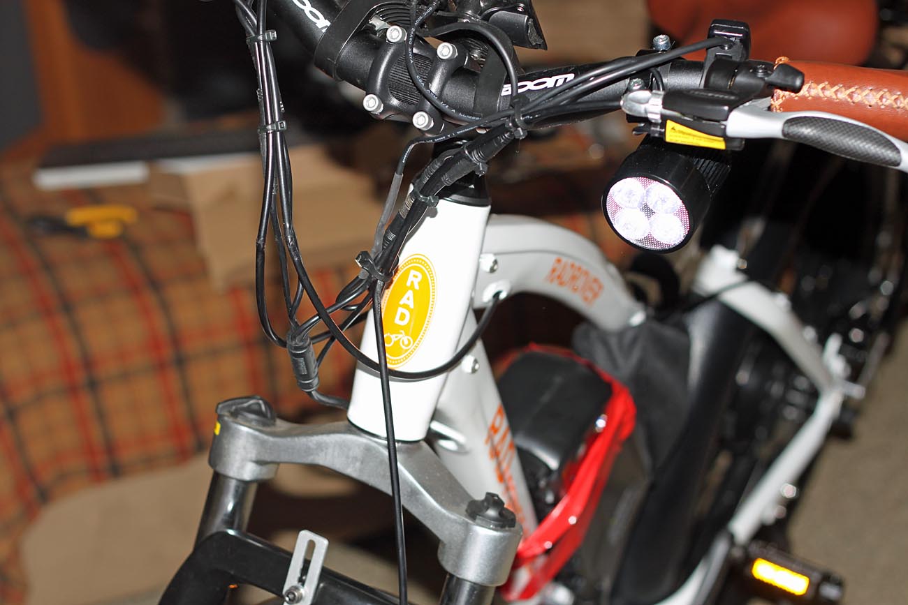

Here is the $10 ebay light. Seriously, if I had to pick one bad decision on the part of Rad Power, it would be the light. Soldered this puppy in and all is good. IIRC on some other site that reviewed it, it drew 11.4 watts, which would not mean a lot on a range hit.
Something to keep in mind is that those lights are simple flood lights for off road use rather than properly engineered headlights, and as such can totally overwhelm the vision of others if not used with careful consideration.
I had a very close call when totally blinded by the intense glare of such a light on a local MUT because I ended up going off the pavement on to soft ground.
Yeah, I realize that. I purposely aimed it down a little bit more than I wanted. I had my daughter come at me with the bike to check, it did not seem any worse than a car.

Here is the $10 ebay light. Seriously, if I had to pick one bad decision on the part of Rad Power, it would be the light. Soldered this puppy in and all is good. IIRC on some other site that reviewed it, it drew 11.4 watts, which would not mean a lot on a range hit. View attachment 14879

Does the light on the side (not in the center where you are traveling) throw you off a bit?
Nope, not noticeable in the least. It lights up a wide enough path to navigate comfortably. On a beam 15 or 20 feet wide, being off center a couple inches will be minuscule.
I use Bar Mitts in the winter for commuting and I didn't like how the RR handlebars tilted and moved the light off center.
I did the BM WORKS Speed Extender, Amazon, $23: https://www.amazon.com/gp/product/B00M13QMVA/ref=oh_aui_detailpage_o00_s00?ie=UTF8&psc=1
The mounting points are right under the LCD screen. It stays in place on trail rides. It gave me more real estate to mount my light, iPhone 6S Plus with wireless charging case, and back-up light without taking up too much space on the RR handle bars.

Does anyone have any idea how many watts the output of the controller is good for on the light channel? The Rad Power light is really a joke, it is a simple LED (I forget the size T1 3/4?) pointed at a reflector. I bet it only draws a 1/10 of a watt at best, which gave me pause for thought on hooking up an 11 watt load to it. I finally said go for it when I saw someone else did the same thing...
Have you seen my photos of the headlight taken apart? It really is a joke. It's only running at 3v (unsure how many mAh, didn't test that).
What do you have that's 11 watts? The connectors are pumping out 52v, FYI.
The ebay link posted above. Advertised as 20 watt, but really about 11 or 12.
The rad light is maybe a 40 mw led.
