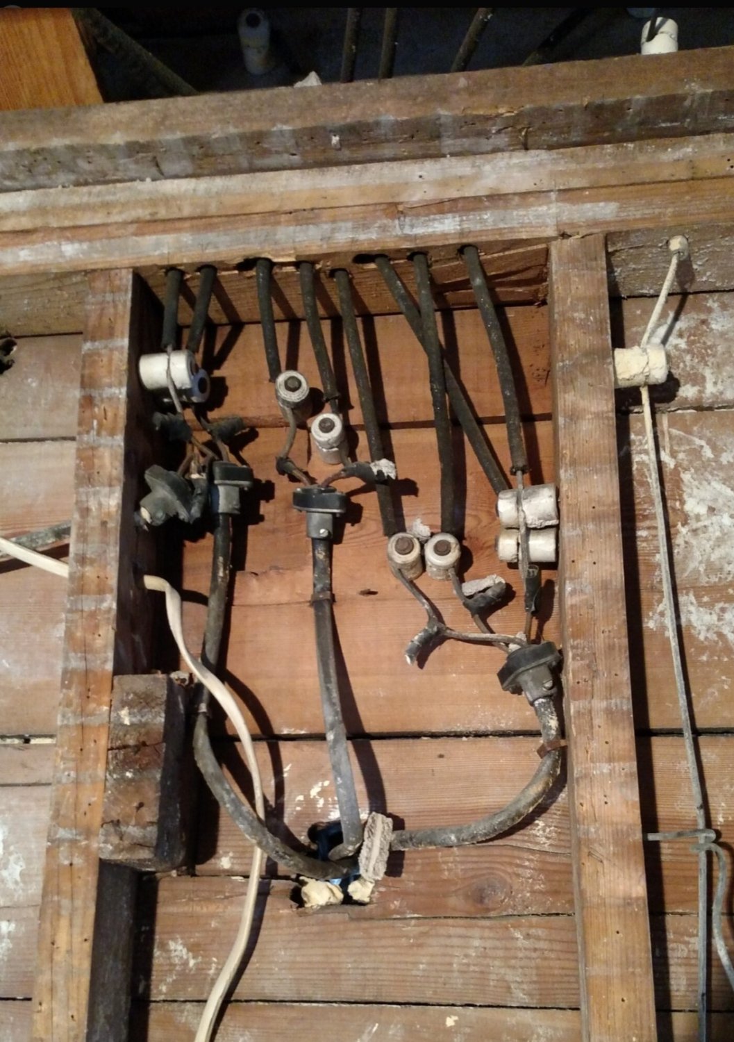

My house was wired in 1926. The Western Union splices are still fine. The electrician was killed shortly afterward, wiring lights at a ball park. I know he wired my house right because there are no twisted (AKA rattail or pigtail) splices. Some electricians used to twist and tape, but that's not allowed in household wiring because even solder doesn't make it reliable.

There is practically no reasons to use a Western Union splice in a home. The only time I ever seen it in a home was with knob and tube wiring which should be replaced no matter how well it was done.

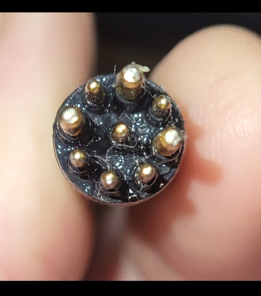

I will shorten cables. A lifetime of soldering experience. Shortening the motor cable is not advised, but I did it. I would use DIY solder ferrules for the heavier phase wires, but worry about strain relief, Best way to do that is buy a long 9 pin motor extension, cut it to length and solder the cut wires inside the controller, It's an easy solder joint, no strain/cracking issues, and protected from water.

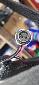

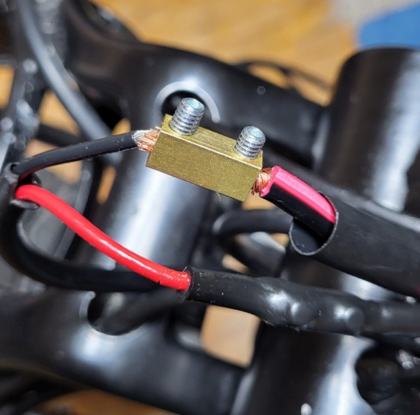

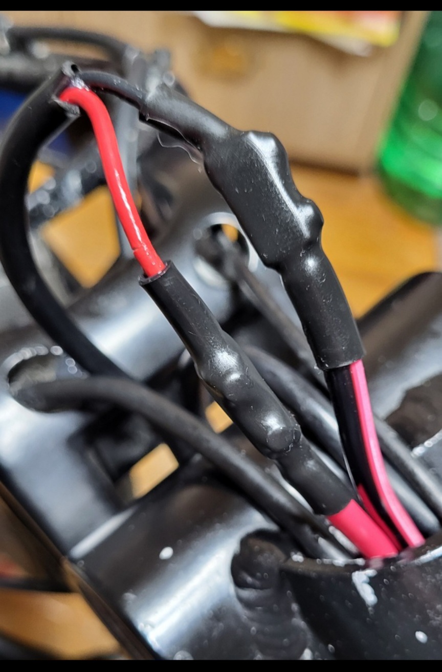

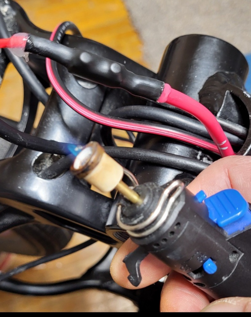

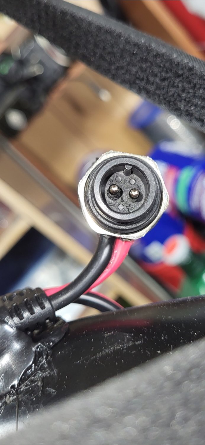

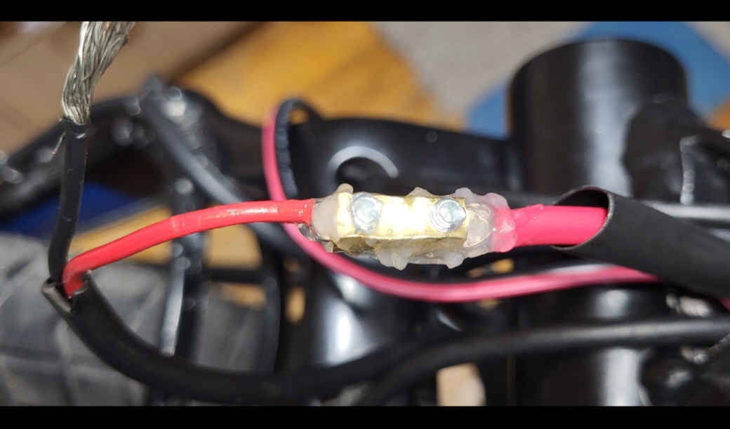

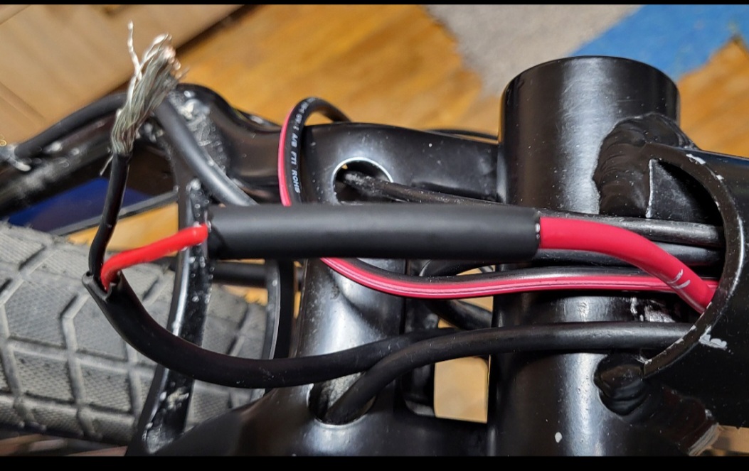

Waterproof Double Butted Power Cables for the New Motor,..
Each wire under two screws in a Butt Connector,..
Double walled heat shrink tube, over top of Silicone Dielectric Grease
No air in the Joint.
No oxidation.
