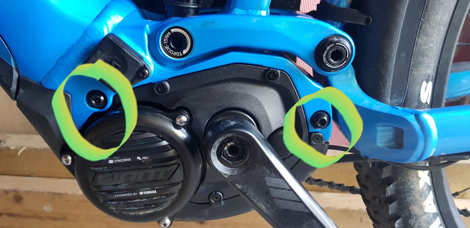

Just a question on how to do this - seems counter intuitive to grease and loctite, can anybody advise how to go about doing this?
The creaking caused by engine mount bolts appear to be a common problem with a range of Giant e-bikes. The fix is to remove each (3) engine mount bolts individually lubricate them with either a lithium or molybdenum based grease, refit and retorque to 22 Nm. You will need a T30 TorX bit, the nylock nut on the opposite side of the motor is captured in the engine casing and if you are careful will remain in place. I am an Aircraft Engineer and I am not sure why you would use loctite with a nylock nut as a nylock nut is a self-locking nut by design and will not loosen unless worn out.
1. The process is pretty simple, locate your engine mount bolts, using a T30 TorX bit undo & remove the first bolt.
2. Smear with grease, refit the bolt, the nylock nut & washer on the opposite side of the motor will hopefully remain in it's hexagonal cut-out (if not relocate it and support it whilst inserting the bolt).
3. Tighten the bolt to 22 Nm and move on to the next bolt.

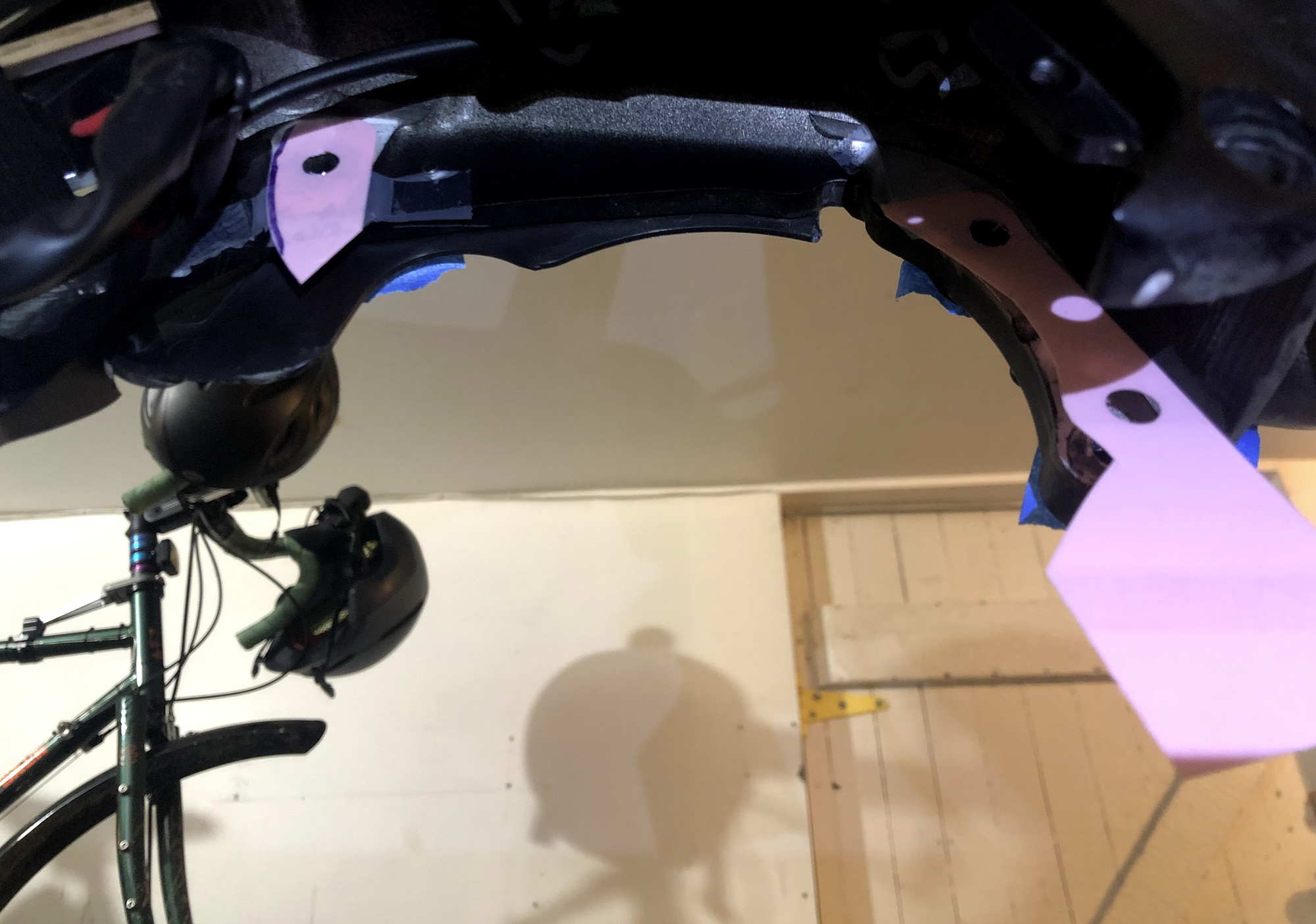

I just bought a used 2018 Thoughroad GX E+. The motor was see-sawing. I took it off and measured it and the cavity in the frame in which it sits is simply too big. In my case, the holes in the motor casing had become egg shaped and there was nearly 0.5mm clearance between the motor mount bosses and the cavity on the frame.
I made plastic shims and stuck them in there, then cranked the living hell out of the bolts. With my shims, I only had to close a gap of 0.1mm. If you remove the chain ring(s), you can trim the shims afterward with a knife (though you may scratch the finish on the motor). I didn't have it, but if you use the thin Scotch double-sided tape to hold the shims in place, you're going to be just fine. As it was, the "tails" let me move them around to align the holes as well as check that they no longer moved once I tightened the bolts.
The picture may not make any sense if you've never taken the motor out - you're looking at the frame cavity from below. My shims are pink plastic.

Nice, I love the ingenuity!
