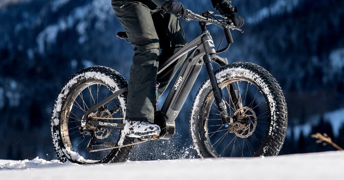

Here is a little more detail on the new Jeep bike with a QuietKat frame... ;)
