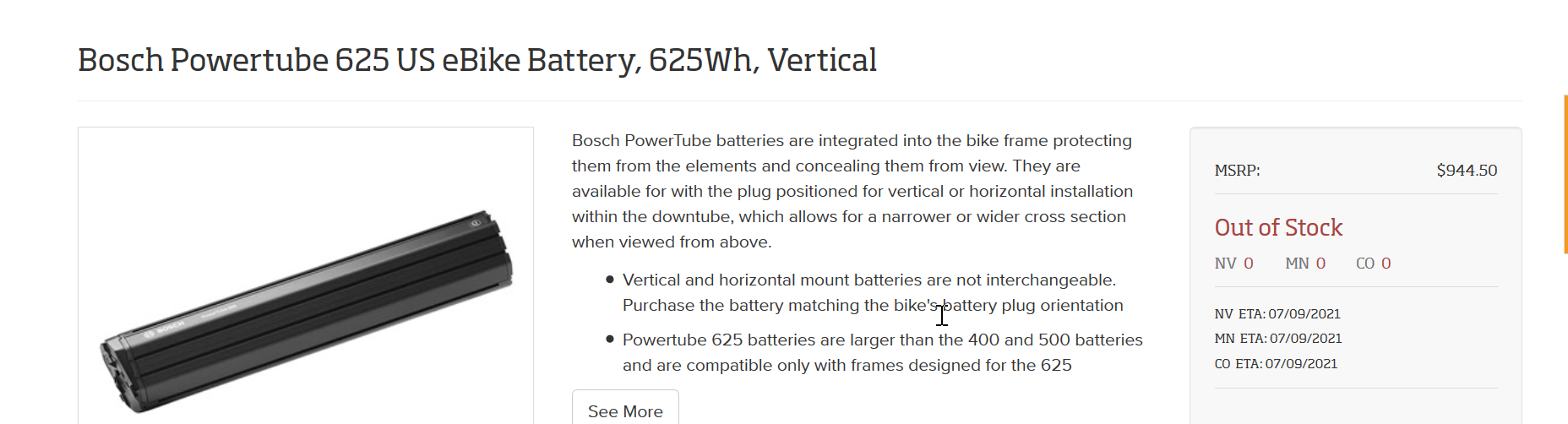

When the hell are Bosch’s 625wh batteries going to be available?

Hoping my back-ordered 625W PowerTube comes in soon, I want to better understand how to charge different capacity batteries on the same charger.

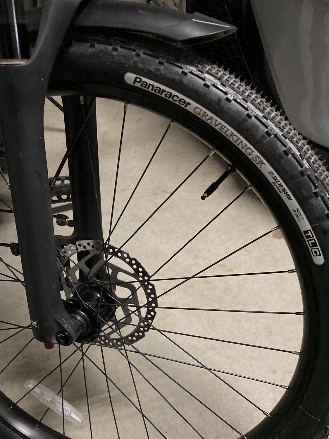

Would you have considered going tubeless if the rim was/is tubeless ready?

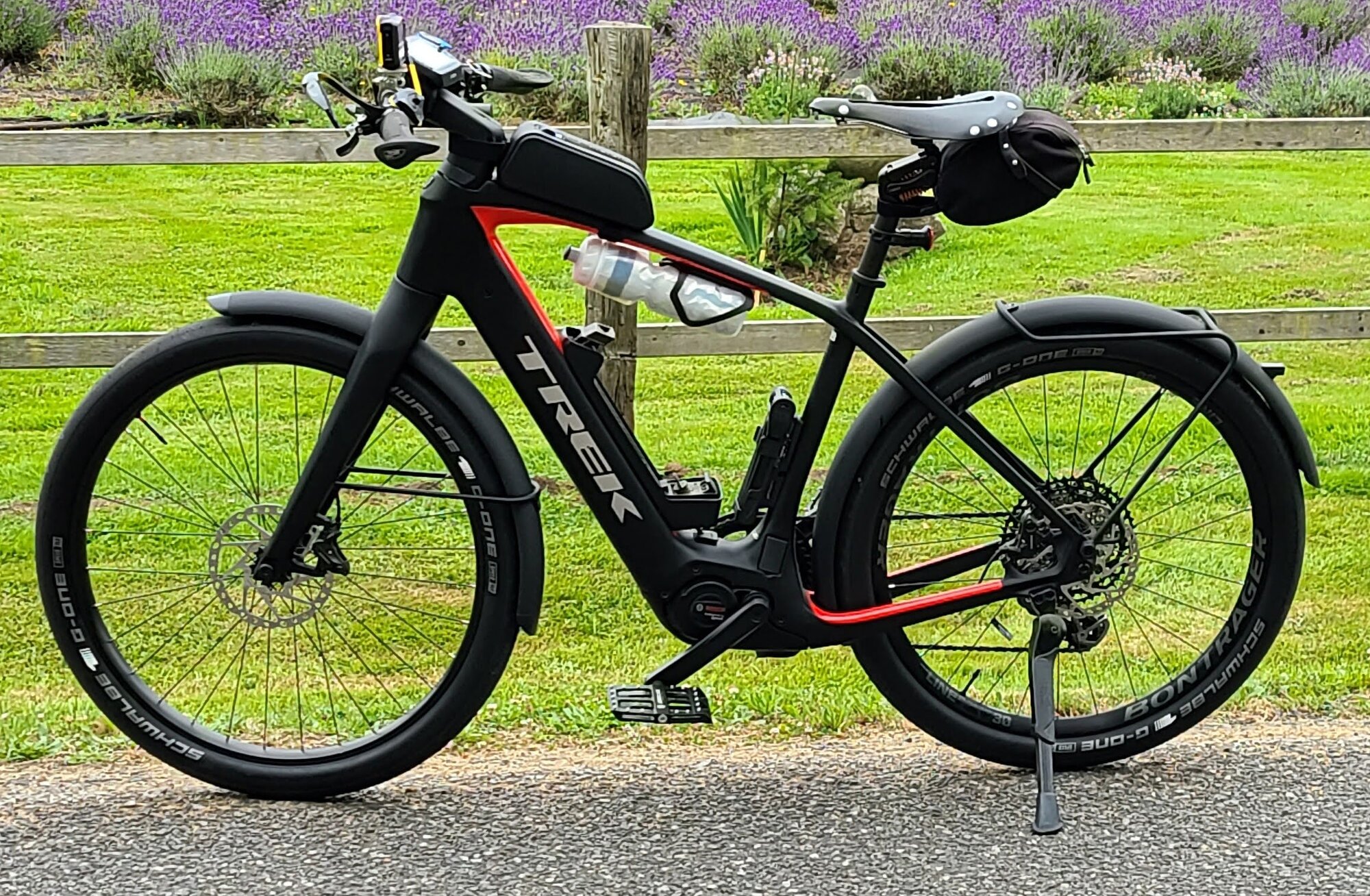

took awhile to get all the the parts seperatly to get the exended battery on my trek. they dont sell the kit without the battery and all the parts had to be ordered seperatly. the battery Y was the hard part. so today I take my nyon in and get my old bike with the new motor updated and ride it home while they install the second battery on my trek. but now that my wife can ride the tandem I wont need the extra very often.
The rims on my Allant+ 7s are tubeless ready. I just had tubeless tires mounted last week. Cost with tires, parts and labor = $270. Peace of mind is worth it. Without tubeless rims I definitely would have gone with the same tire (Panaracer Gravelking SK) for puncture resistance. Too many flats. Even with slime I could not keep up with the punctures.
