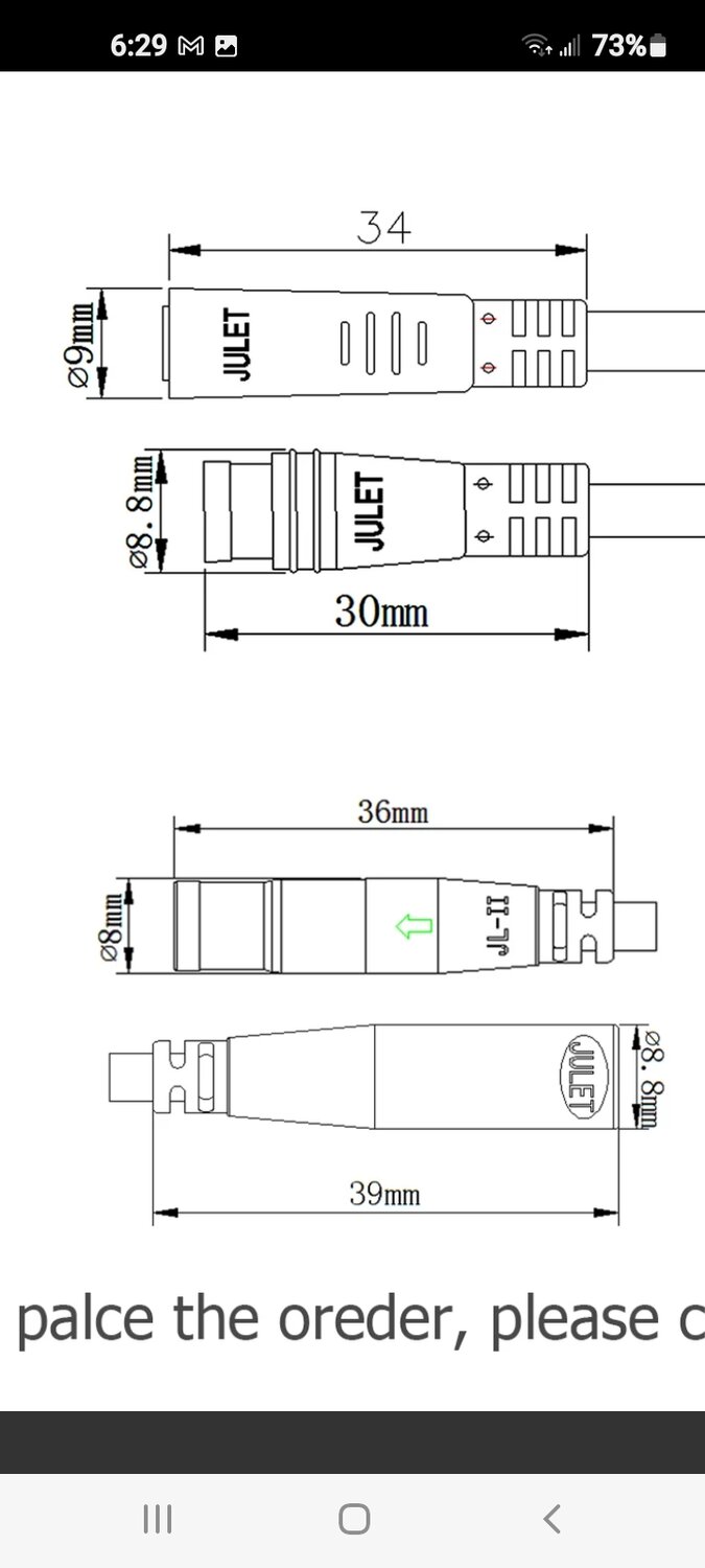

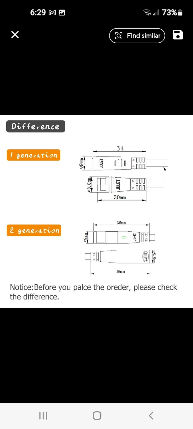

What's the difference between M6 and M8 Julet and Higo connectors

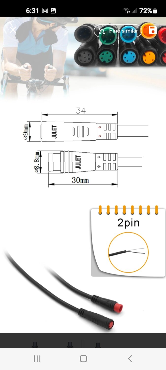

I've got Julet cables on my e-bikes and bought Julet cable extension that fit but were slightly different.
I found some information,..

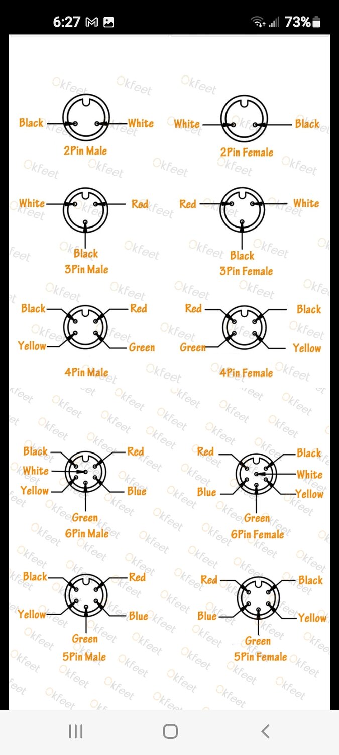

IT's usually 5 wires to an LCD display, or 5 pins on a connector. Carefully probe all possible wire pairs on those pins. You said you already done this, . Gotta be battery voltage on one pair. If not, well then there is something wrong with the controller,
I'm interested in finding out what the 5 wires are and what the voltages are.
I'm thinking that the display itself runs off 5 VDC and it monitors the battery voltage to show the voltage or a bar graph.
I don't think the display itself runs off B+ (36V, 48V, 52V) so I want to find out.

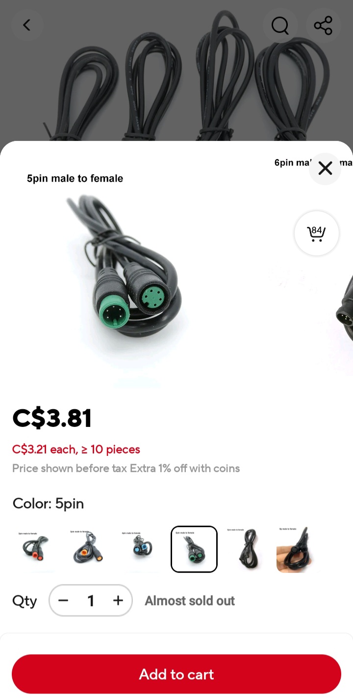

I'm going to buy a Green Julet extension once I figure out exactly what plugs I have?
Both my e-bikes (with different displays and controllers) have a Green 5-pin Julet connector, and I don't want to cut into the cables, so I'm buying an extension to cannibalize to make a Pin-Out board.

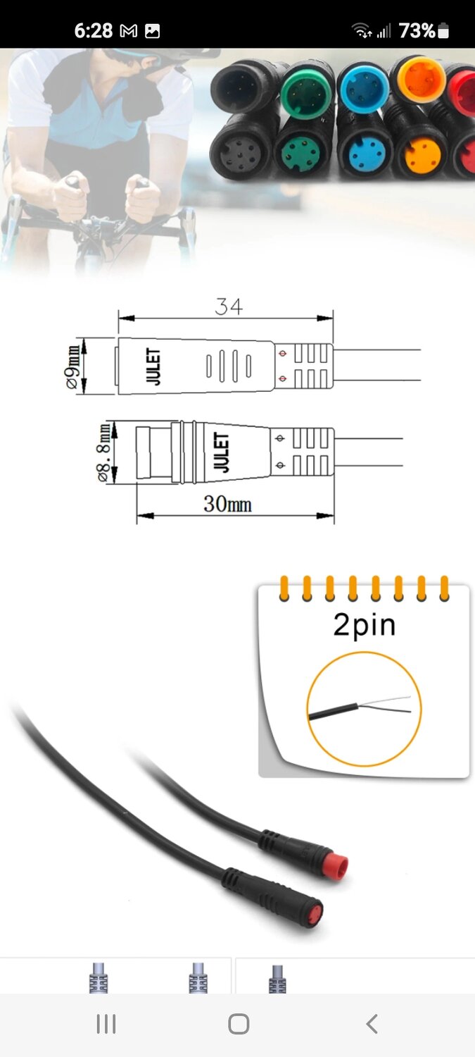

I have bought connectors that didn't fit. They just fell apart and needed to be taped. Must have been Julet vs Higo,

I'm guessing Battery + and -
Data In and Out with a common ground for the Data wires?
Is that right?
I'm still gunna buy a green connector because I like to fix stuff that ain't broke. 😂

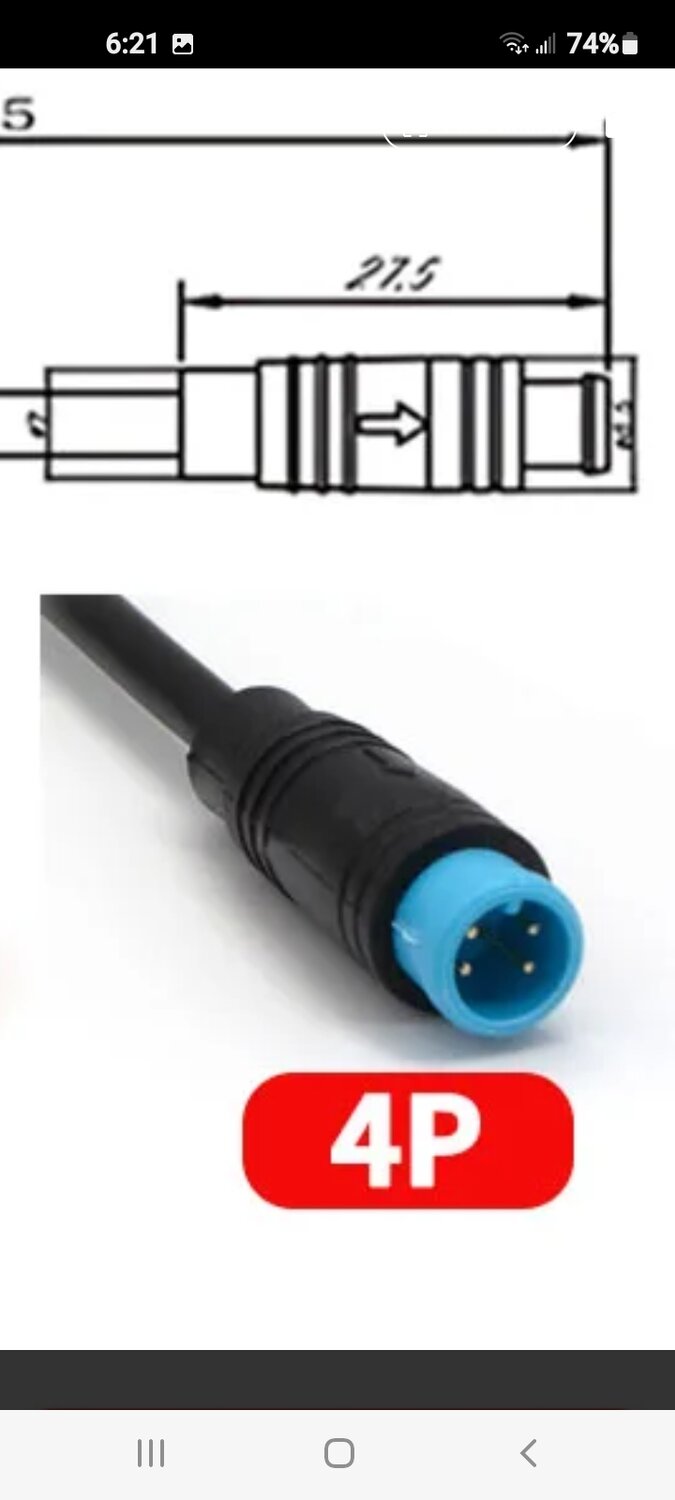

I've got all the other colors except for blue because I have no 4 pin connectors.
I've gotta spend ten bucks to get free shipping and I don't need 5 green connectors, so I need to buy something else that I don't need and may never use. 😂
I ordered some stuff.

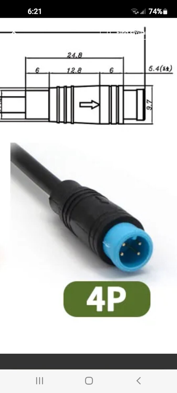

I measured my connectors, and I have M8 size plugs.

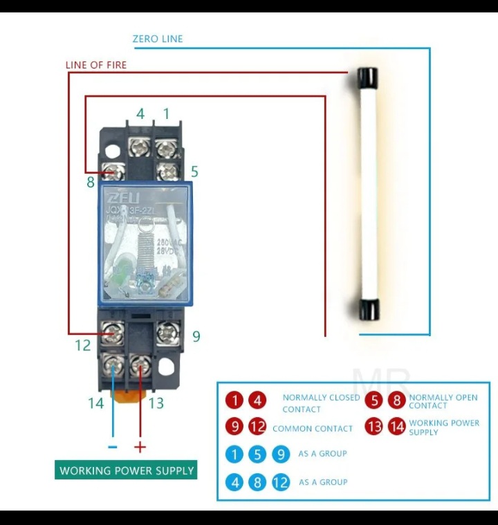

I will have be careful when working with them to stay out of the line of fire. 😂
I don't know if it's safe at the zero line either ??
Perhaps somewhere in between the two ?? 😂
