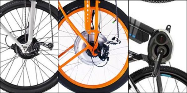

One of the biggest questions about electric bikes is “What’s the difference between motors?” and that’s because there are several different types including geared and gearless hubs, mid-drives and shaft drives. Not to mention brushed and brushless… I’m hoping this post can help to clarify the space a bit so you can focus in on finding the right ebike for your intended use.
What are Hub Motors?
Hub motors were the first type of drive systems for bicycles to be patented and they continue to be popular today. Instead of trying to integrate a motor into the bicycle drivetrain (complimenting the gears and chain that the rider uses) hub motors stay completely separate. Electricity is run through copper wires to create electromagnets which repel traditional rare Earth magnets and create force that rotates the hub forward (and sometimes backwards). In the early days brushed motors were used because they are inexpensive and require less sophisticated control systems but the brushes wear out over time and require replacement. These days, nearly every hub motor (geared or gearless is brushess and uses direct current DC).
Hub motors for bicycles are usually positioned at the middle of a wheel and when the bike is powered off they function much like a traditional hub (connecting the tire, rim and spokes to the axle. Spokes are flexible and light weight, they absorb some shock when riding but can come out of true over time. Regular bicycle maintenance is still required with an electric bike and one downside to hub motor designs is that they add additional weight to the wheel and require extra wires to deliver electricity and communications about operation. This means that truing wheels and repairing flats requires more effort.
So hub motors take the place of regular light weight hubs, connecting the wheel to the bicycle axle. As they receive electricity and spin, the bike is propelled forward and some of this energy is exerted into the frame at the dropouts. Usually the sturdiest place to mount a hub motor is in the rear wheel because these dropouts are reinforced and have four legs connecting them to the rest of the frame instead of just two on the front fork. These four arms consist of two seat stays and two chain stays.

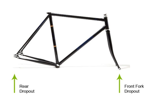

In some cases a front mounted hub motor is preferred because it allows an internally geared hub or continuously variable transmission CVT hub such as the NuVinci to be used in the rear. Some of the newest electric bikes like the Smart ebike combine an internally geared hub (that the cyclist pedals) with a hub motor and are able to put both in the rear wheel.

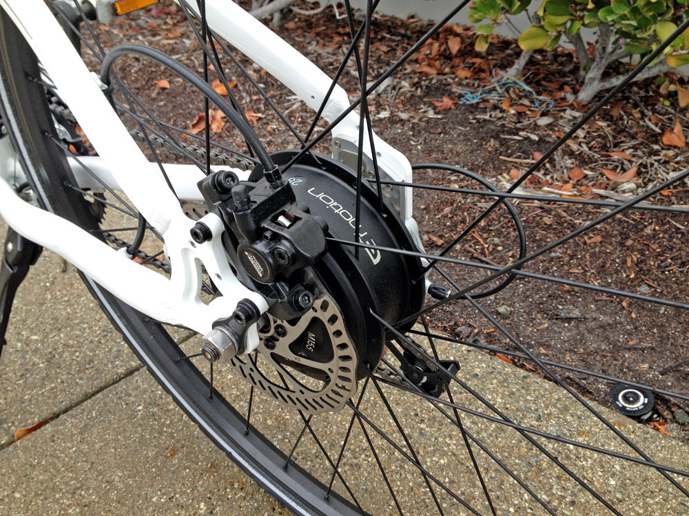

Hub motors come in two different types including geared (usually a planetary design) and direct drive or gearless (relying on larger magnets and no gears). Gears provide leverage, enabling smaller and lighter weight motors to achieve greater output but also produce friction, noise and wear. Most modern geared hub motors are built very well and should last for many years so don’t get too spooked. It may seem counter intuitive but geared hub motors do not add resistance when coasting. This is because they usually contain a freewheel mechanism that can unlatch from the axle and spin with little to no friction.

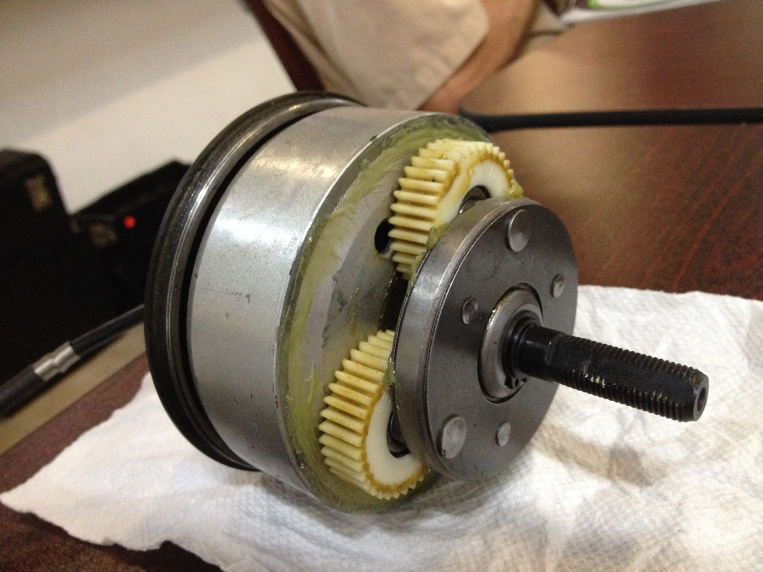

Pictured below is a 350 watt geared hub motor on an Easy Motion ebike:
This is a picture of what one geared hub motor looks like inside, you can see the three planetary gears that step down the speed and help produce torque for starting and climbing:

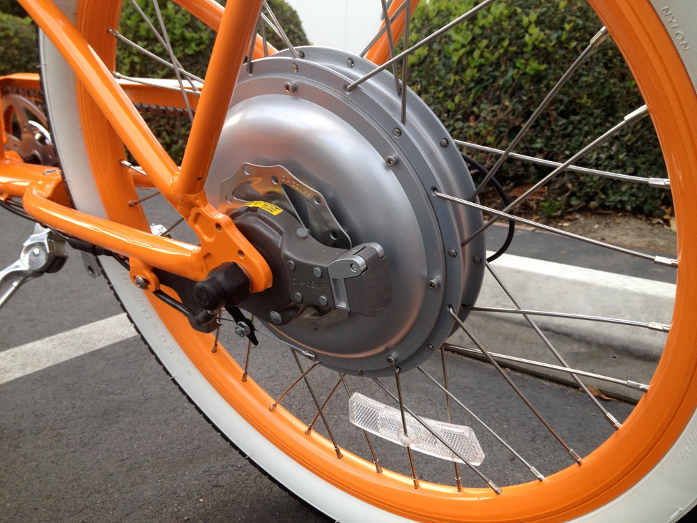

Gearless hub motors may require a larger casing (in order to accommodate the magnets) and ultimately weigh more. This is of course a generalization because the technology has evolved to the point where some direct drive hub motors are quite small and lightweight.
Pictured below is a 500 watt direct drive hub motor on a Pedego ebike which does not offer regen but is still quiet, powerful and durable:

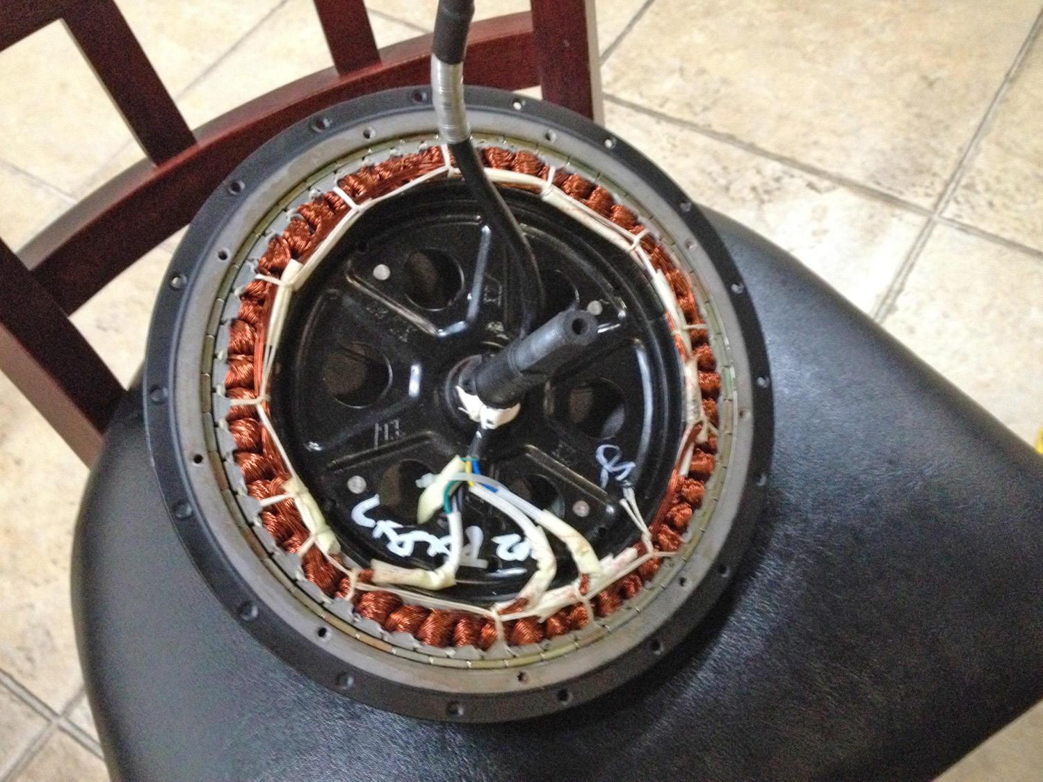

Here is a picture of what the inside of one gearless, direct drive hub motor looks like. You can see the magnets glued around the outside of the cylinder and just inside from them are electromagnets (made from metal and copper wiring) that create repelling force to drive the motor forward without the use of gears:

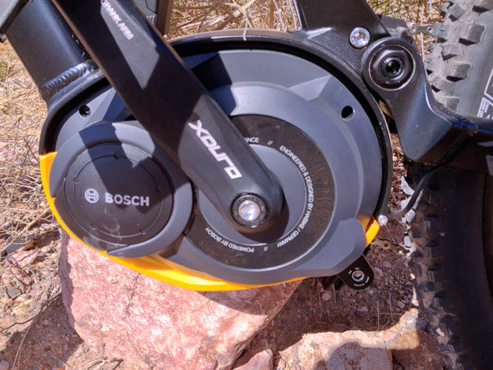

Pictured below is a 350 watt Bosch Centerdrive mid drive motor system on a Haibike ebike:
Climbing is where mid-drive motors really shine. Unlike a hub motor, this design lives at or near the bottom bracket (the point where the crank arms attach through the frame for pedaling) and drives the chain forward instead of the wheel itself. Mid drive systems benefit from many of the same mechanical drivetrain systems as the rider (the use of gears for climbing or going fast) and reduce unsprung weight. This is the optimal setup for efficiency (extending ride distance) and climbing.
