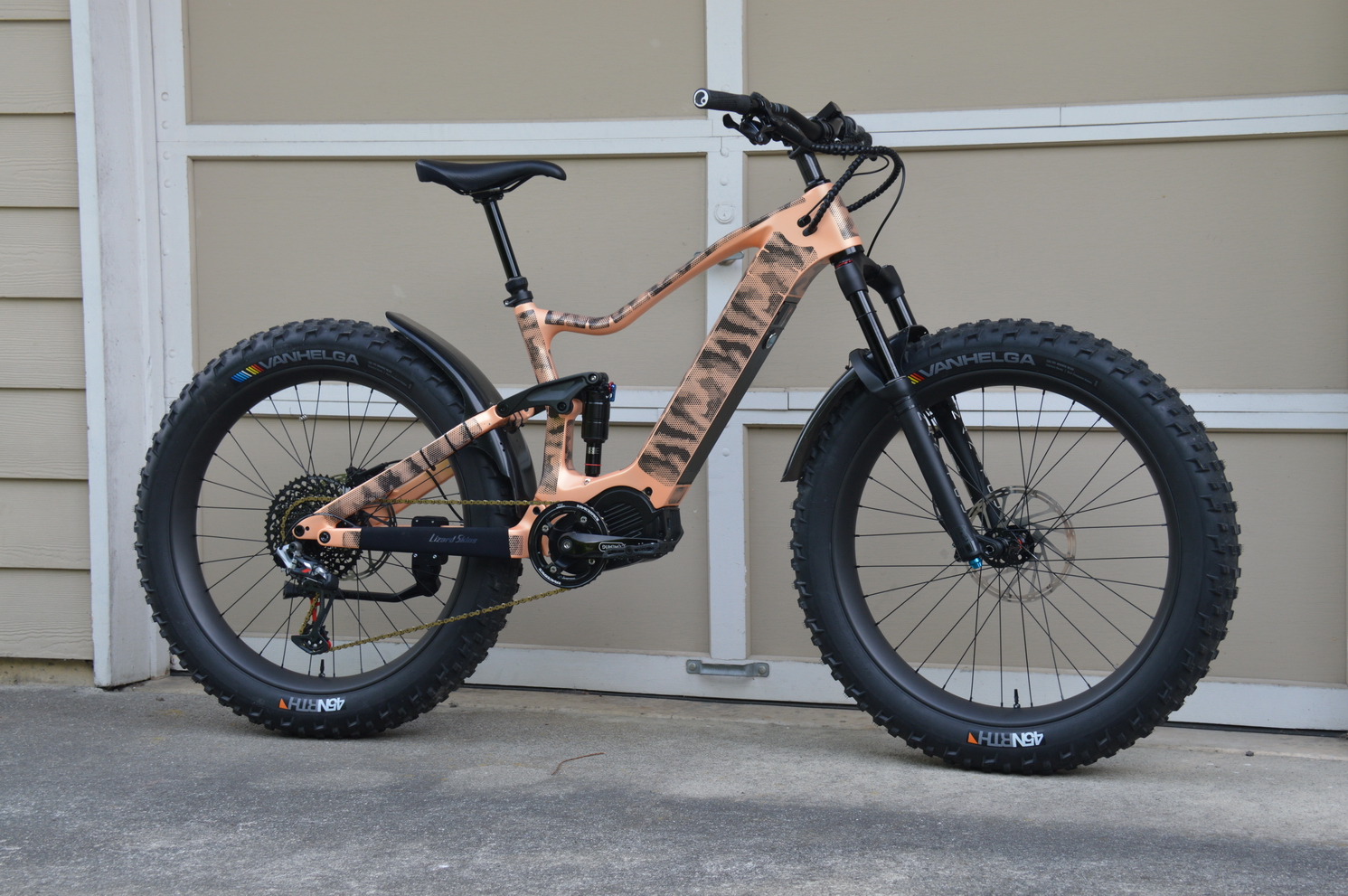

Just went on a 20 mile pavement ride yesterday. I was using these tires for that:
8 psi front, 10 psi rear. Rides and handles beautifully. But yes, those tires are loud on pavement. ;) Feels wonderful all the way up to 38 MPH--I'd actually feel pretty safe at that speed if I didn't have to worry about a car pulling out in front of me. Thankfully I now have a really bright headlight with a blinking mode so people can see me coming!

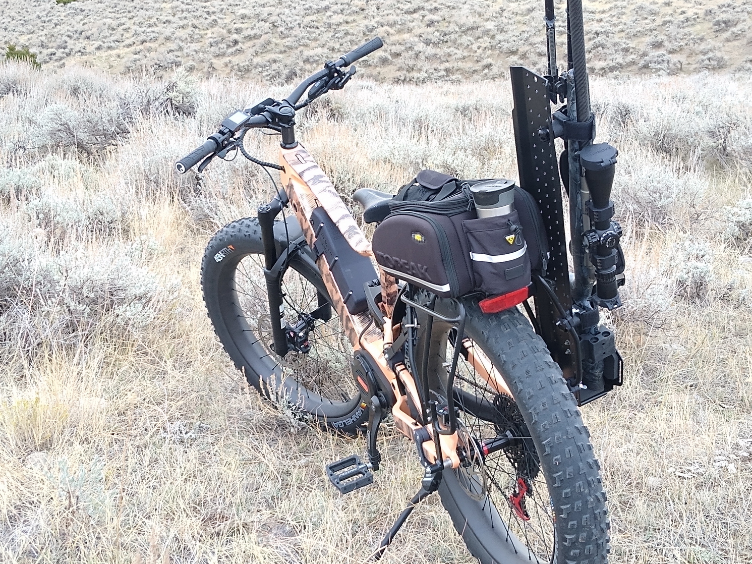

NO self respecting hardcore fat biker has a kickstand on their rig.
And, do you you ever ride that rig? Or just polish it while you watch the afternoon soaps?

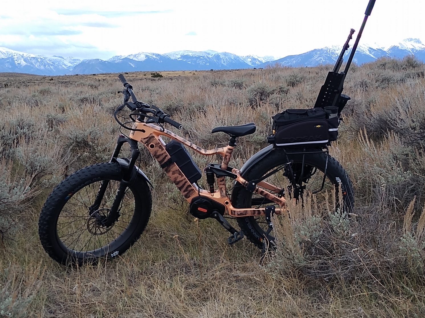

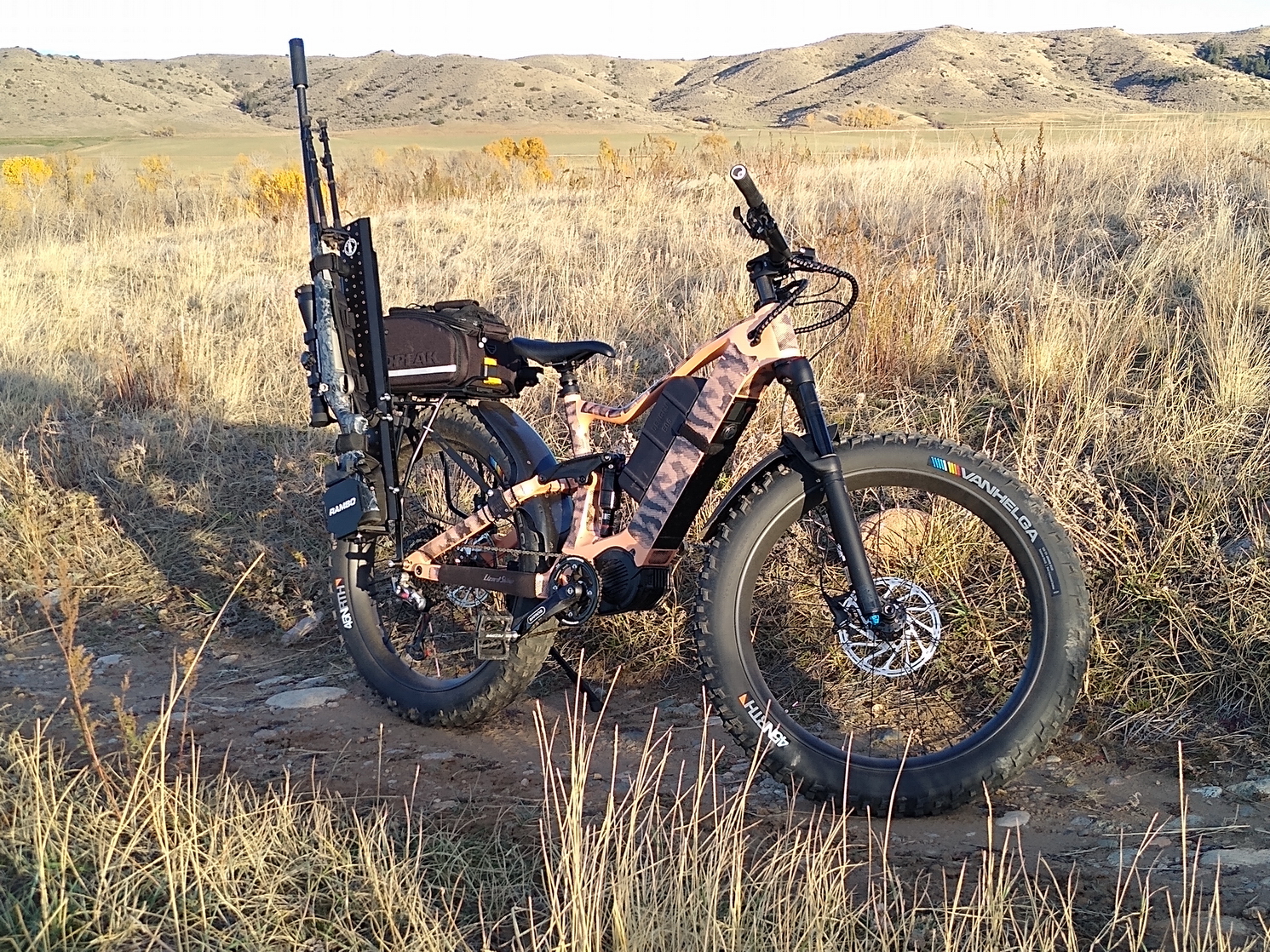

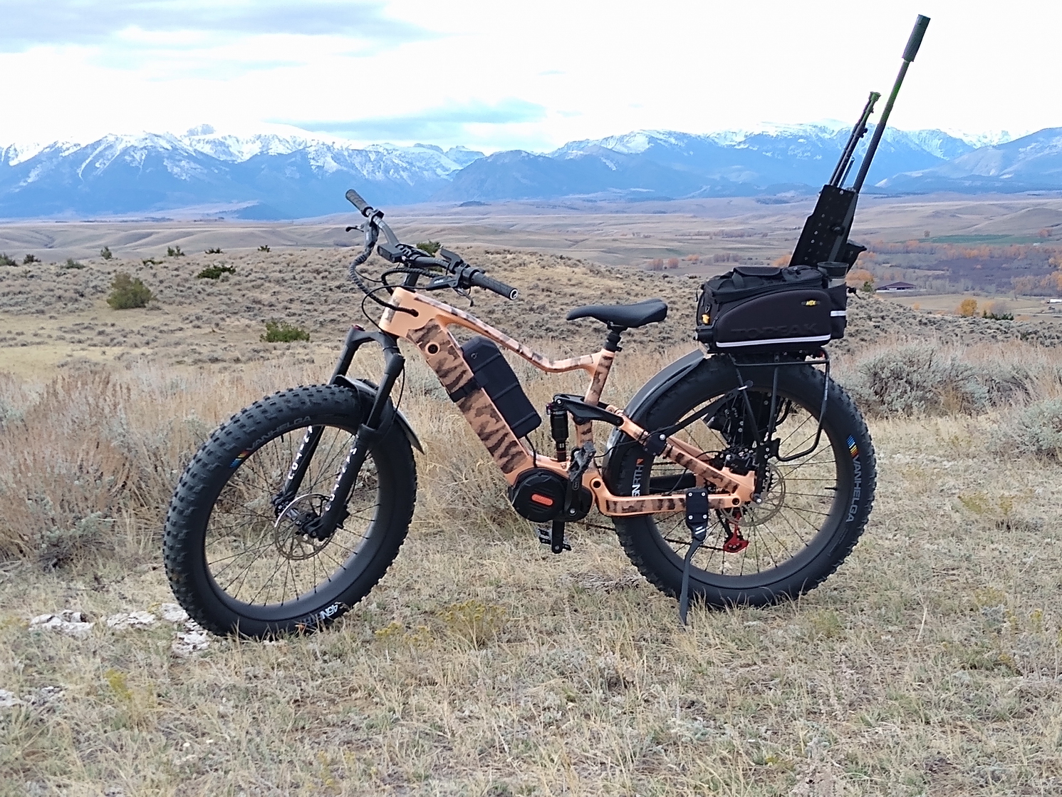

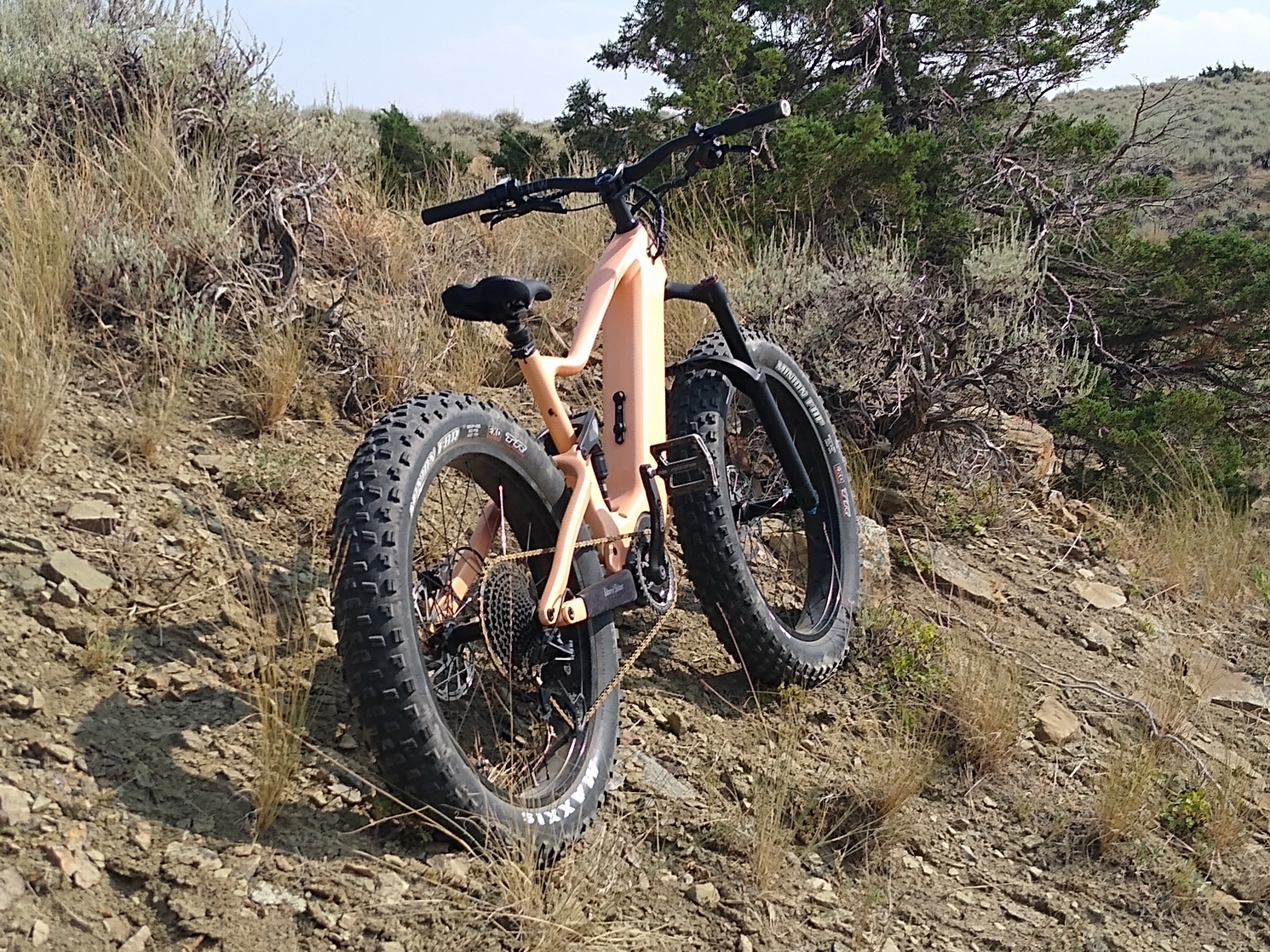

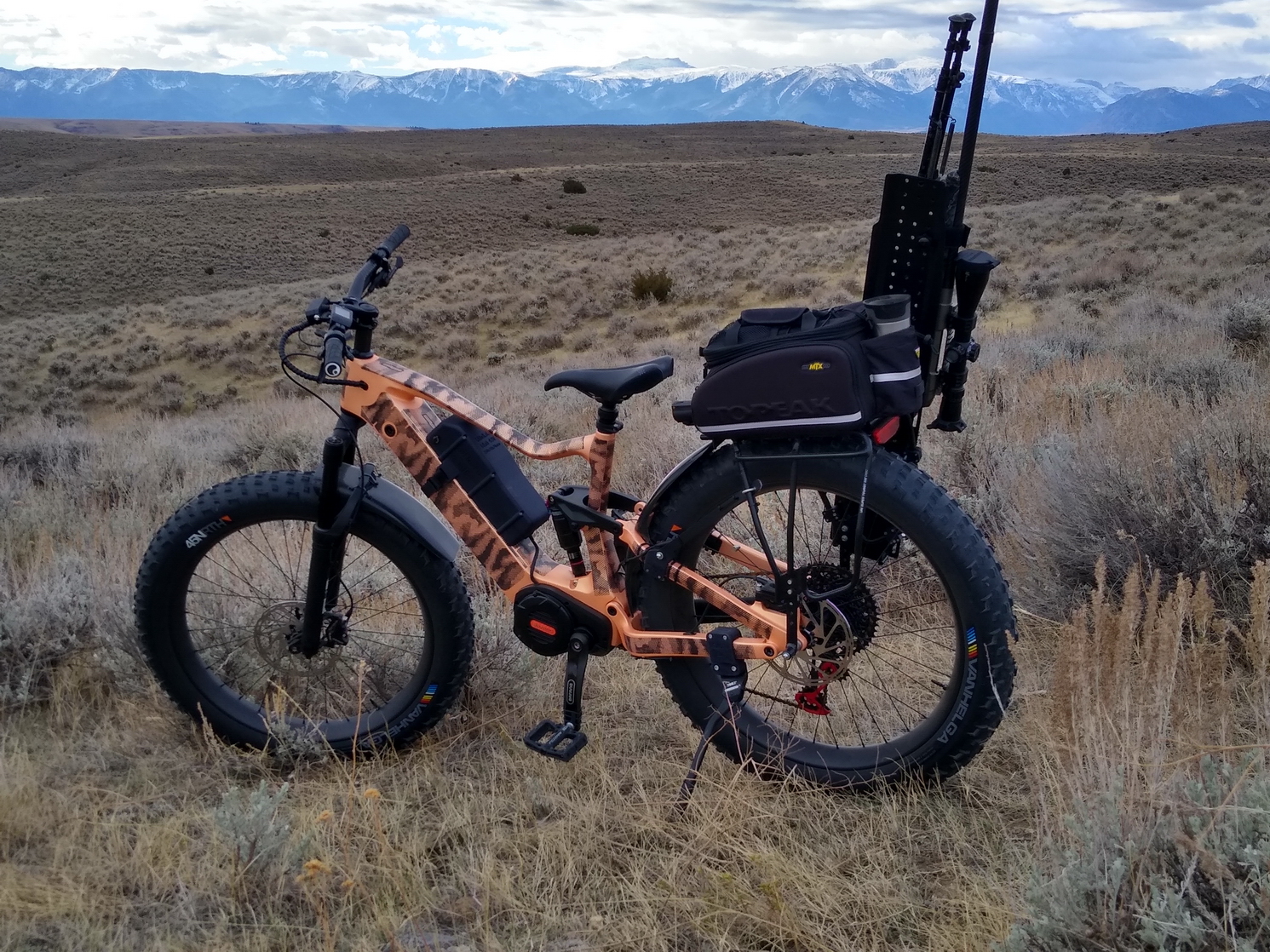

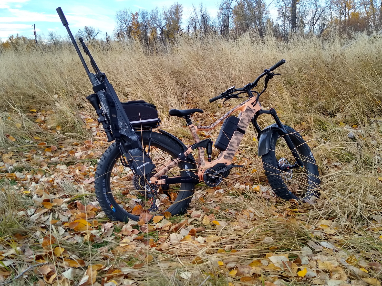

From just the last few days:
The "easy" side of the range to ride (no sagebrush):
The river bottom--posing different challenges:
But of course in the pics above, I was not a "fat biker." I was a hunter. Just one of the many uses for this extremely versatile tool. It took a decent amount of effort to put a kickstand on this bike and I LOVE! it. NO self respecting hardcore person who uses his bike for anything other than a toy will enjoy being without one. I'd just love to have to lay the bike on the ground, pointing the rifle in an unsafe direction every time I get off it (which is often). Even when not hunting, you would not believe how much nicer it is to use every time you need to go through a gate.
For me, this bike is far too useful and versatile a tool to only use as a "toy." And when I want to, I can yank off the kickstand in about 30 seconds, the rack in about 1 minute and the extra battery in about another minute knocking 10 lbs or so off it. Roughly the same amount of time one spends adjusting the tire pressure for different conditions. Can you not turn a wrench?
