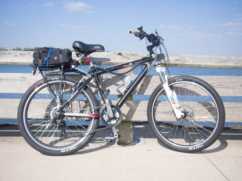

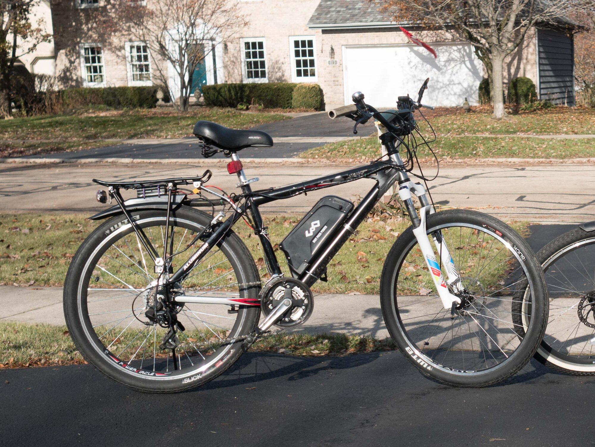

Here's a Schwinn SC2000 that someone threw out. I rescued it and made it electric. The motor is an ebikeling 500W geared rear hub. Back in 2018, I could buy it on ebay with a 3 level PAS controller for $179. I upgraded to a KT controller with a 5 level PAS and LCD3 display for $75. For power, I used two 36V4AH hoverboard packs in parallel ($50). I also installed a $60 suspension fork. The Schwinn had one, but it was steel.
I rode this beater ebike around last summer for errands, I could leave it with a chain lock in front of Walgreens or the library and not obsess over it getting stolen.
Later, I put on a proper 48V ebike battery and gave it to my sister's husband for Xmas, I hear they're riding ebikes 4-5 times a week. Can't visit them because of covid concerns, all of us pushing close to 70.
Upgrades included Shimano M310 trigger shifters, $35. A softer seat $25. Avid BB7 caliper/rotor up front $40. Luggage rack $16. The battery is a 48V13AH with Samsung cells, around $400.
It's still a heavy bike at around 48 pounds (no battery) but fine when the motor is running. About 20 mph on 36V and 24mph on 48V. Brother-in-law rides it at 14 mph and gets over 30 miles.
By the way, front motors and suspension forks don't play well together, The dropouts aren't strong enough for the extra weight and the power. Think about rear wheel. You won't fall on your face if there is a structural failure.
For what I spent on the above, around $800 over 14 months, I could buy an equivalent ebike. That doesn't bother me.

I can't really tell from the picture, but if that is a suspension fork a front hub motor is out.
Rear is not that much trouble, but it limits you to 7 speed with freewheel (cluster). If that is a 6 or 5 speed rear you'll have to change the shifter. 5 speed rear the front sprocket and chain are incompatible with 6,7,8 speed chain.
