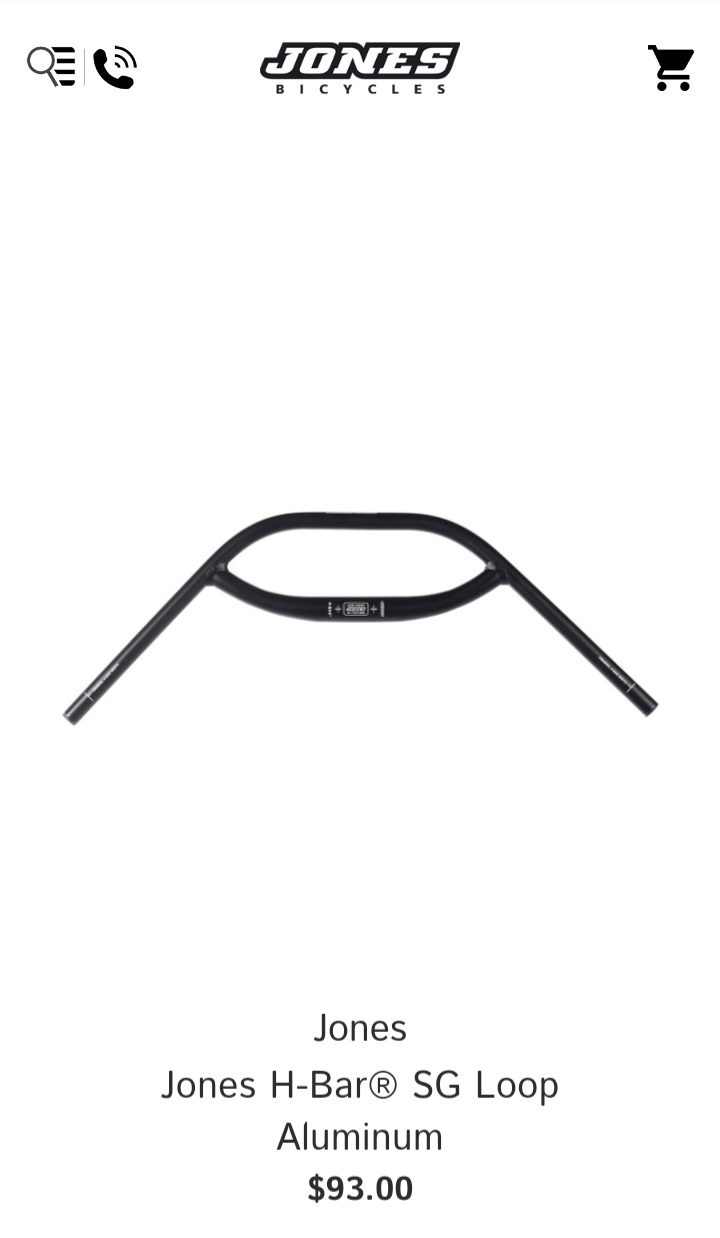

Other people found that Jones Handlebars with a stem riser gets them in an upright riding position.

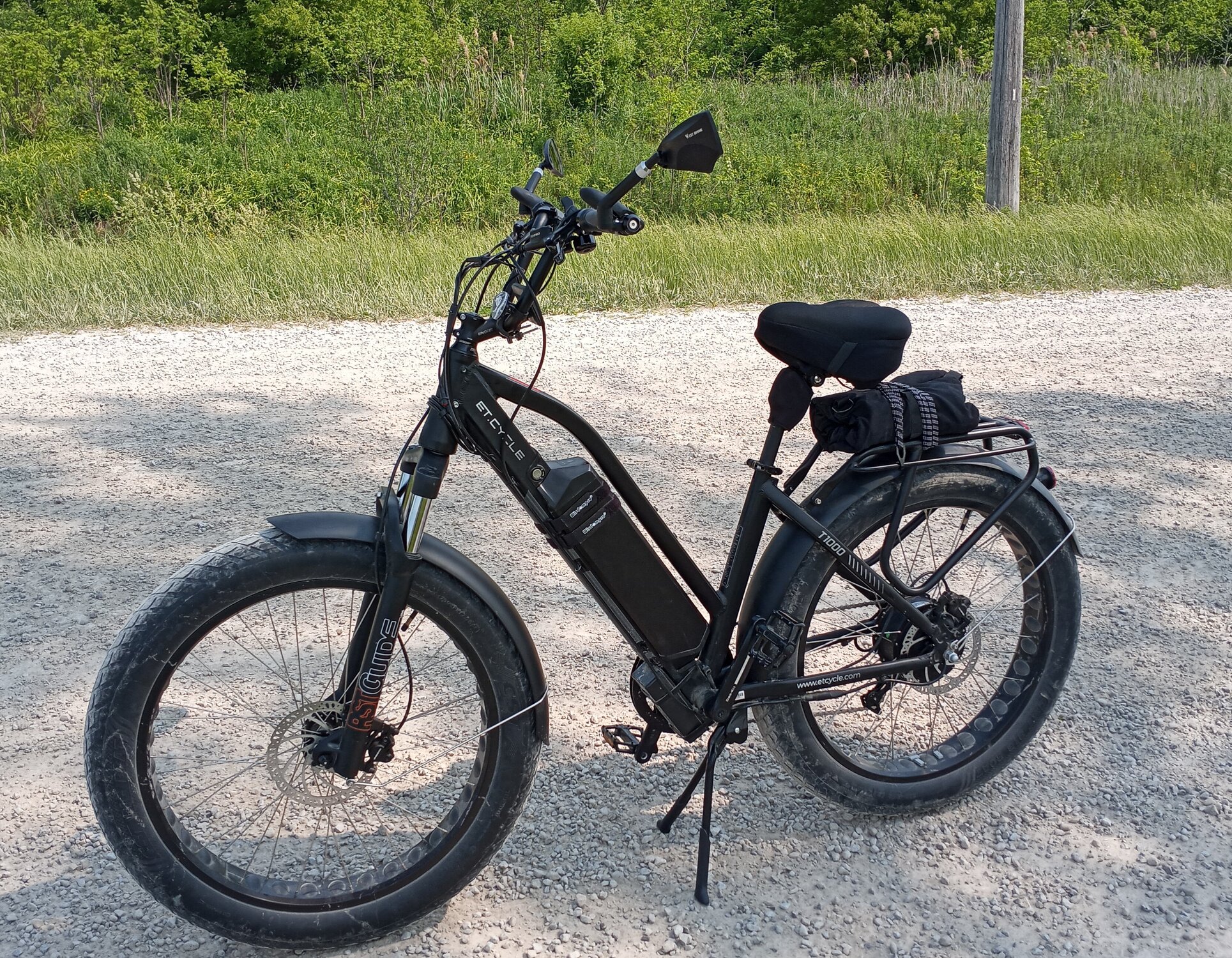

I did my own thing to get sat up straight.
It looks kinda stupid but it works for me.
