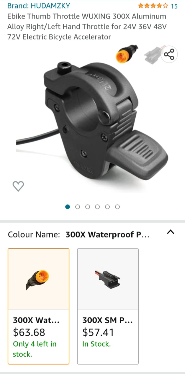

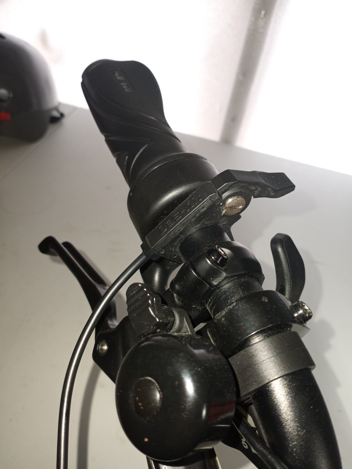

I've got two throttles right now working in tandem.
I added a twist throttle and took apart my thumb throttle to remove the spring and replace it with a rubber washer so it stays where I set it.
I use it as a cruise control.
I'm not liking the twist throttle though because it's hard to hang on to the handlebars when the road is rough, so I want to put my original grips back on.
Maybe I can install the thumb throttle on the left where there's more room?

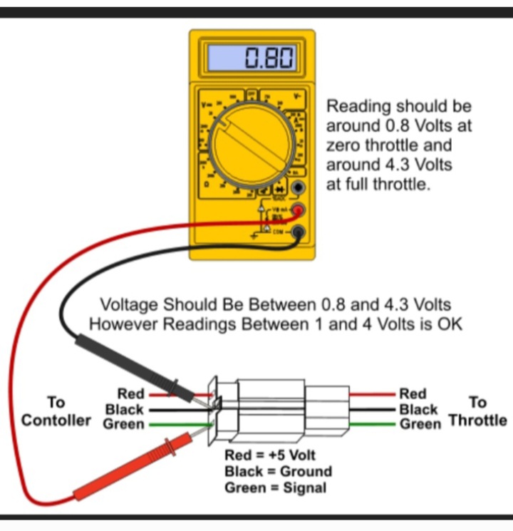

I found this about the hall sensor throttle,..
So the throttle should read 0.8 volts at zero throttle and increase to around 4.3 volts at full throttle.
I was wondering if my 20X twist throttle increases from 0.8 volts to 4.3 volts in 20 increments and the 300X throttle does it in 300 increments? Or if they are both linear and 300X is just a model number or something?
I plugged my throttles into 5 volts and read the signal wire output.
The voltage rose smoothly from 0.8 volts to 4.2 volts.
So they are both completely linear.
