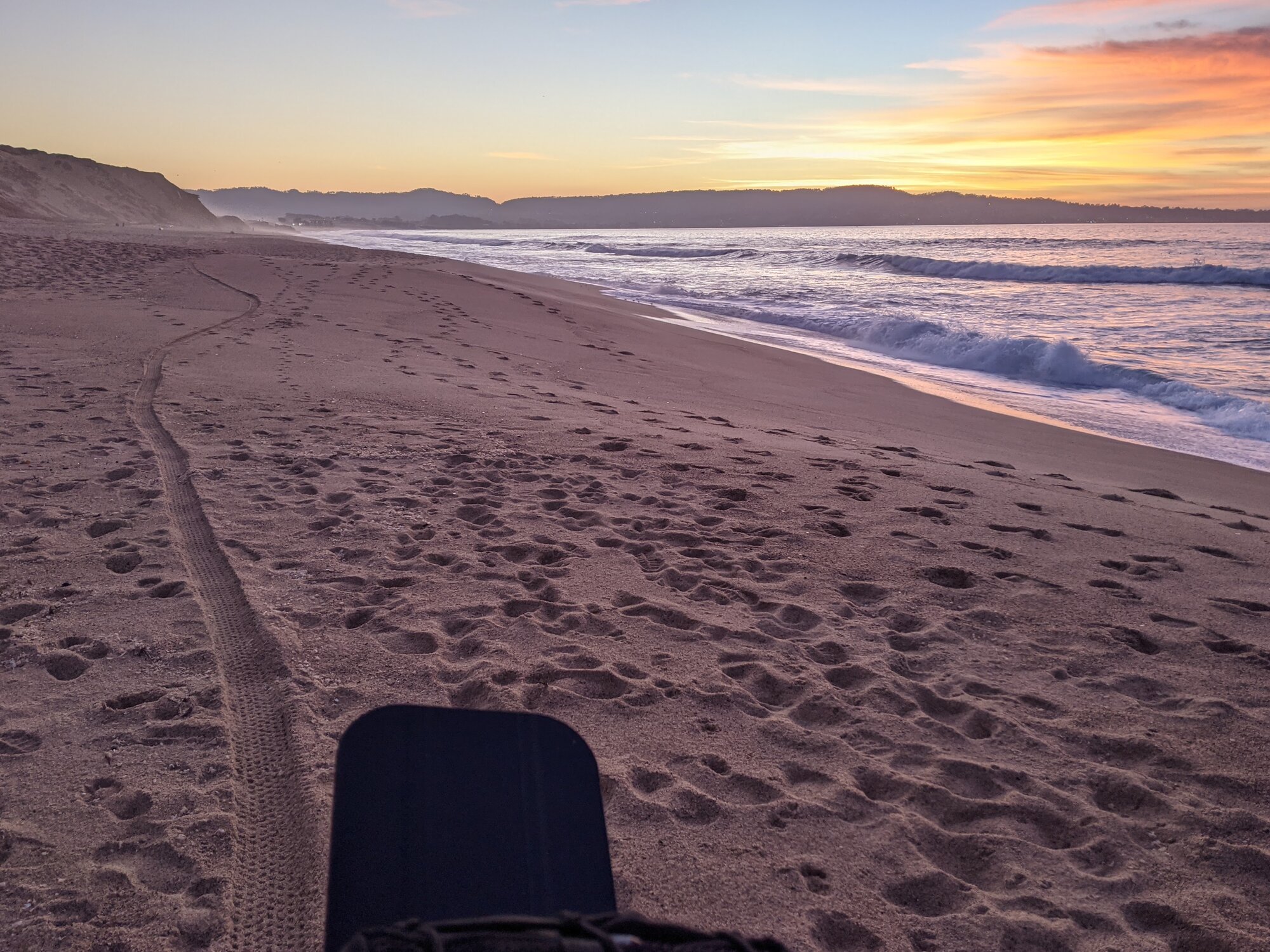

Every time I have had self-steer, it has turned out I had pressure too low. However, sometimes you want low pressure (like riding beach dunes) so if the tire self-steers at lower pressure maybe thats a dealbreaker. I have found no way to predict which tire off the shelf will do this and which won't. My Vee Snowshoe XLs and Snow Avalanches, and Chaoyang/Arisun Bid Daddy/Big Fattys don't have an issue going waaaay down. My Origin8 Supercells in 30 tpi... same story. Origin8 Supercells in 120 tpi reportedly self-steer no matter how high you jack up the air pressure. So... thats the same tire just a different casing.
I've had more successes than failures in dealing with self-steering tires.
I think I was at 5 psi on these. Good luck riding in deep sand on anything sugar-free.

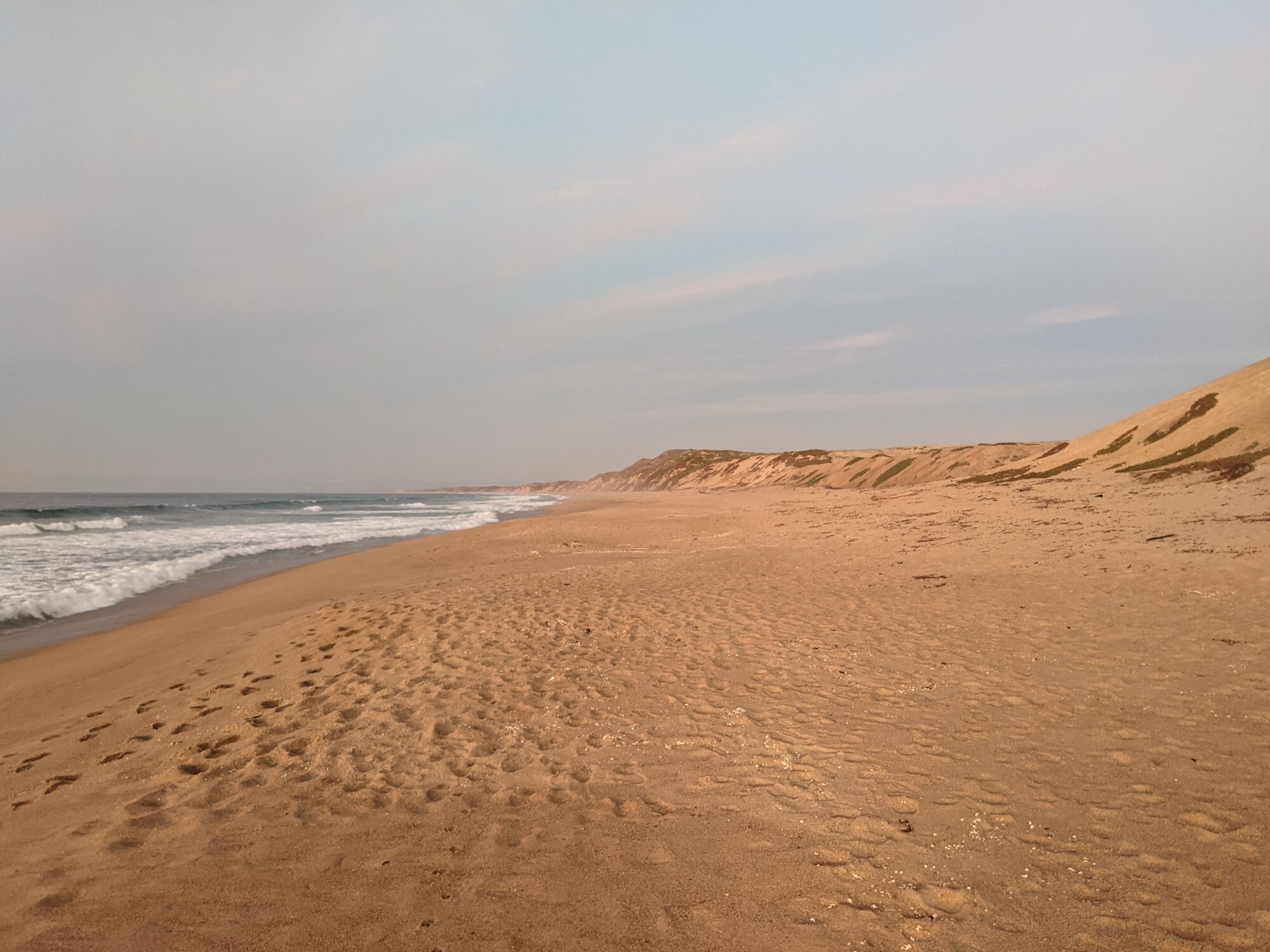

I wouldn't expect any sand/beach riding to be free of self-steering feel - it's sand. :)
oh yeah on deep, sharply sloped stuff like that, even with 2wd keeping the front wheel from submerging, you are one zig away from a faceplant and it has nothing to do with the tires. You are skootching around right and left all over the place. It is by far the most challenging riding I have ever experienced. Although wondering if I will get back before the tide comes in is certainly part of the thrill :D
When I took that pic behind me I posted above, Which was only maybe a mile down from the place I got onto the beach, I turned around and took this one in the direction I was going. You could see the sunset in the pic facing rear. That sunset is illuminating what you see below. My regular destination is almost invisible all the way at the end of this pic and is why I have a 32ah pack on this bike. There is no inland access from my ingress point all the way to the destination at Marina State Beach, where I ride in and there's an electrical plug at the bathrooms.
After a half mile or so the footprints stop. Also that nice flat stuff gives way to a steep, relatively narrow slope (really bad riptides here). I've never taken a pic that far down cuz its really hard to stop and then start back up again.
But on this ride it got dark before I got that far and I had to turn around, hit the headlights and chug back.
Part of what makes it fun though, right? ;)
