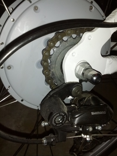

For those of you who have installed the flykly on a bike, did you install it on a single speed bike? When I try to put it on my multi speed bike, the chain does not fit the sprocket. The gear on the flykly sprocket is a little bigger than the chain, and when I asked a local bike shop they said that most multi speed bikes (at least in the US) have smaller chain size than single speed bikes. I'm very surprised to find out about that. Now I just have to find a single speed bike or change the front sprocket and the chain on my current bike. Is this the same experience for other flykly users? Have anyone installed flykly on a multi speed bike?
You'll need to buy one of these (18 T) or similar and watch this video to see how to install it.
