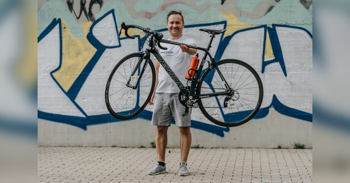

Nice ride, but definitely not the world’s Lightest Ebike... ;)
Wow, that bike weighs less than my carbon fiber Cervelo! Geez, that is amazing. Just think of riding that, you could never use the motor until you hit a hill and only need it then. If the battery dies, so what it's still lighter the vast majority of bikes and the friction drive disengages so no drag.
A pretty interesting project for his Ph.D.
