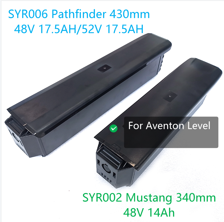

Those of us without Aventon bikes don't know which battery type and case are used. More information may get more responses.
It shall be SYR002 Mustang used on Aventon Level.

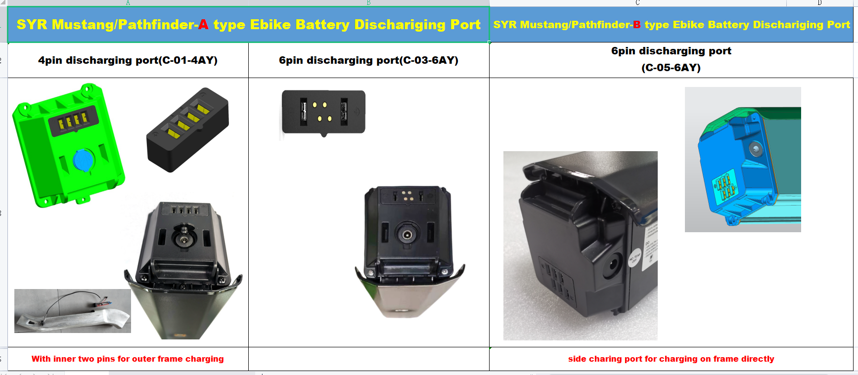

What is the difference between V1 an V2 terminal?
The SYR Mustang A type is available for 4pin (C-01-4AY) and 6pin (C-03-6AY) discharging terminal.
The SYR Mustang B type is only available for 6pin (C-05-6AY) discharging terminal.

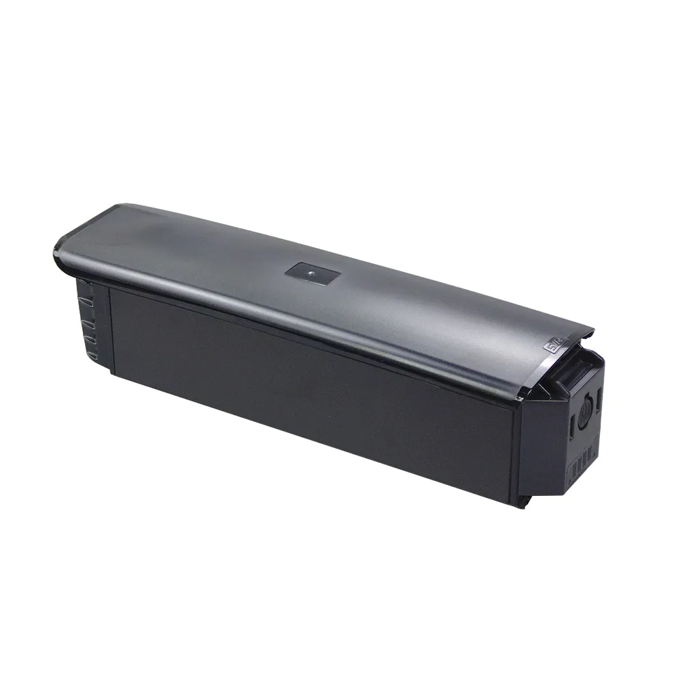

This is the Aventon Level 1 battery listed. 48 volt 14ah, 354 mm length, 4 pin connector.
Jenny Mao
This is NOT a proprietary case. And should be easy to find. There are LOTS of builders making batteries in that case. Unless they have a 3rd wire proprietary battery control, but even that is no mystery. Typically 5V to the third wire allows charging.
@Jenny Mao
Not top tier but a reasonably well built battery.
