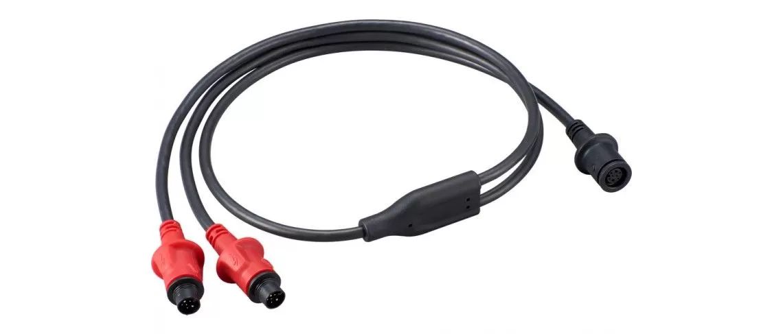

The more interesting situation is that both can be charged at the same time using special Y-cable. But there's obviously "brains" in that Y-cable or somewhere in the system. Since when using the Y-cable BOTH batteries must be attached for charging. The Y-cable will not charge either battery alone. I guess the brains could be in the coupler/divider where the cable splits or in the single end.
Here's a photo

How comes you cannot charge two Range Extenders with the SL Y-Cable at the same time but you can charge the main battery and a single Range Extender together? Is the logic so simple?
I don't have a range extender or a Y-cable so I'm not sure. May be an oversight or a technical limitation, although I can't think of any off the top of my head. In your experience, what's the charging order? Main battery then the range extender, or simultaneously? Do they charge simultaneously even when they're at a different state of charge?
This.
Yes, they do.
Interestingly, charging both batteries from 5 to 100% takes the same time as charging a single RE (3 h 20 min) while charging the main battery alone takes 2 h 30 min.
