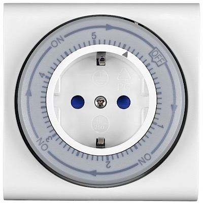

I learned that I could connect a timer between the wall outlet and charger, set it up for 4 hours (max time needed to charge Vado 5 with 4 amp charger), or even turn the timer off manually when I want using my cellphone (this is a WiFi timer).
This way I can ensure there is no electricity current is running through charger.
Please let me know if this approach has a flaw.
Agree. That’s what I do all the time. Found a cheap (about $6-7} timer that plugs right into the outlet. European/ Schuko model in picture but you get the idea. Set it to anything from 5min to 6 hours.No flaw. Others that adhere to the 80% max charge rule report a similar strategy to avoid buying 'smart' programmabe chargers.
I assume no issue with cord staying connected to the bike for a period without electric current?Agree. That’s what I do all the time. Found a cheap (about $6-7} timer that plugs right into the outlet. European/ Schuko model in picture but you get the idea. Set it to anything from 5min to 6 hours.
I can’t think of any.I assume no issue with cord staying connected to the bike for a period without electric current?
