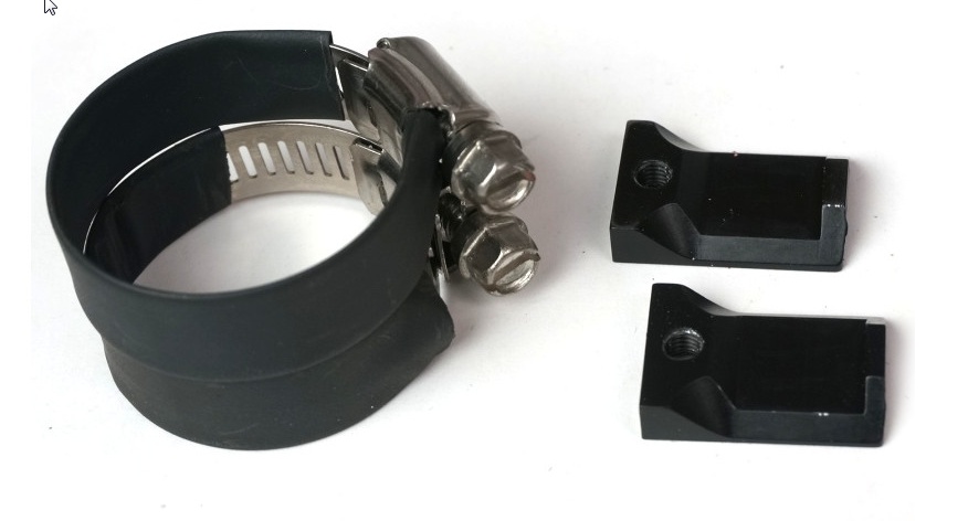

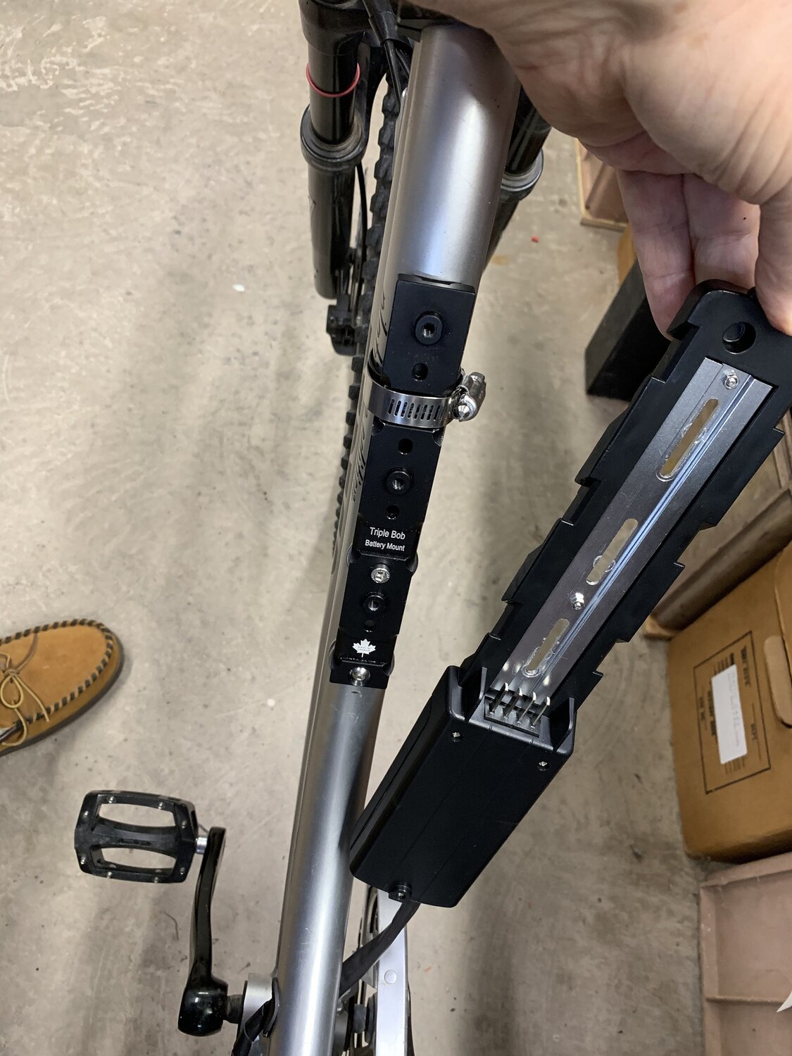

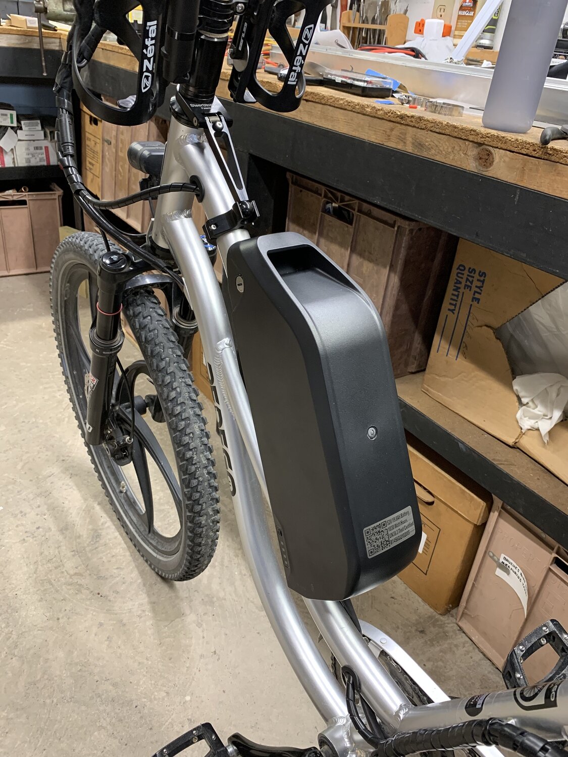

Grin makes several products for mounting batteries. They also have a video with tips on how to do it:
I use their "Bottle Bob" in addition to the 2 cage bosses to mount a 10# DB9C battery:
Very solid. It hasn't shifted at all in 4 seasons of riding some pretty rough trails.

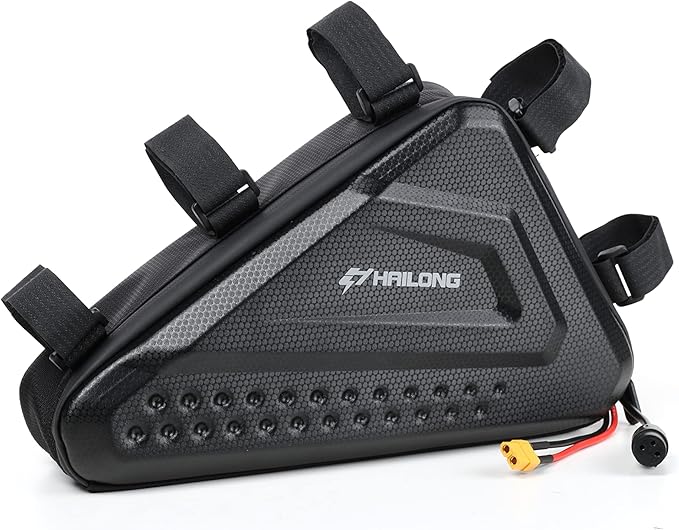

I haven't actually mounted it yet, but the Hailong triangle battery I have seems like it will fit decently in the strangely-shaped front "triangle" of the Aventure.2 with the water cage removed. Due to the curve of the top tube (which I'll attach all 3 straps to), there will be a larger gap between the bottom corner of the battery and the down tube, and the bottom strap may not be close enough to tighten well. I may want to shim that side of the bag? And/or possibly screw something into one of the water cage mount holes to help hold up the opposite corner. Not sure if those straps are ever ideal for holding up the mass of a 20Ah battery over the long term, but I was going to cross that bridge when I come to it. The idea would really be that I'd only need the triangle battery for at most 6 or 8 70+ mile rides a year, and it wouldn't be mounted at all when I'm commuting or taking shorter rides.
