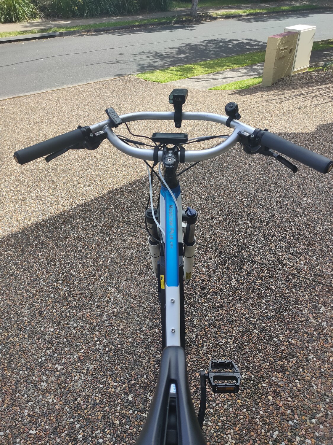

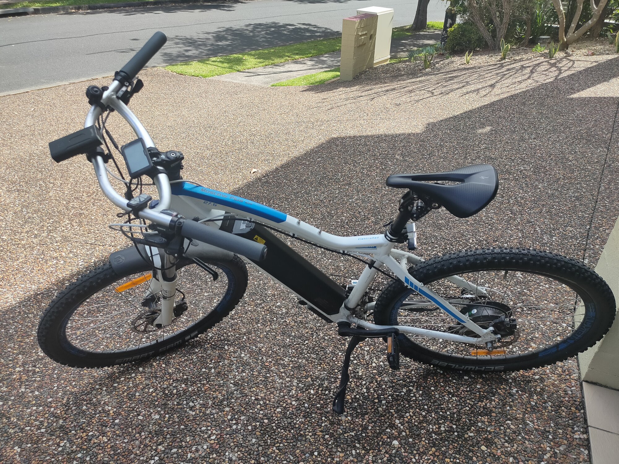

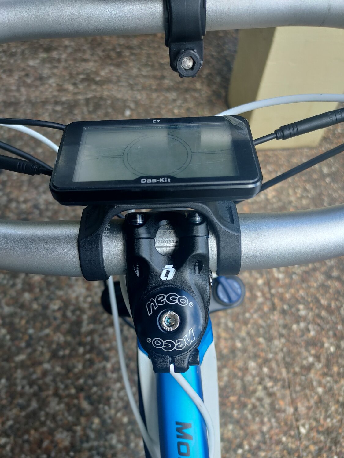

Loving the Jones Bar with shorter stem 45mm. The steering accuracy has improved greatly, a lot more control, better posture, less vibes, more comfy. It doesn't stop the tingling in my hands, however I can move my hands around the Jones bar and instantly my hands stop tingling.
I get tingling hands on all my bikes which includes my premium bikes the 2022 Liv Intrigue E3+, 2022 Specialized Vado 4.0 SL EQ. The Vado was supposed to replace the Moscow but I'm selling on the Vado.
I may put Jones Bar on my Liv Intrigue E3+ - they are that good :)
