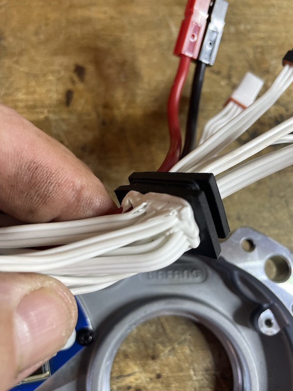

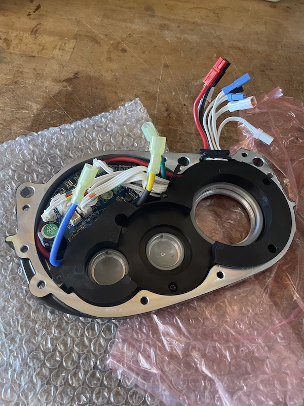

Got my new controller today and it came already mounted inside the removable motor housing so if I ever need to use it all I have to do is unplug/replug the three phase wires and reassemble. Even came with a new gasket, nice.
Make sure to check the wiring for any issues. Mine had a couple of slices in the insulation, easy fix but could of caused a problem if installed and came into contact with the housing.
