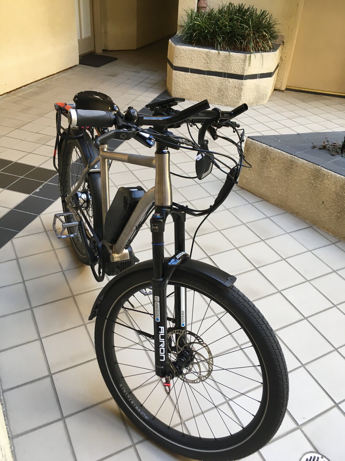

I've been testing some Jones H Bars Explanation. In alloy OR Ti Jones (one of few) 31.8mm in Ti bars - without adapters/ shims.
The thickness of the anodizing finish is unreal. While wrist position may vary, I find the 45 degree sweep angle superior to 34 degree bars I replaced.
Moloko's weight 709gms. Jones Butted Loop H-Bar in 660mm, 515gms.

My take is Jones is missing his REAL market: The required real estate for 'Touring/ Commuter e-bikes', my Phone; GoPro; (wireless) lights; (wireless) turn-signal controls; (wireless) shift controls, the straight runs of bar are ideal

I tested J bars on a fast ride, 17ish miles up hills from 30' elevation to 250', back down valleys to 60' and back up to 330' - top speed 31ish mph. Dodging downed tree limbs, sand from flooding, debris in the bike lanes - when there were such ('lanes', I mean). Paved, rough roads and sometime running alongside 40mph lanes. Airborne a couple times. For me it was '8 - 10' intensity. Few would be much faster than my style. Level 1-3 (my custom controller settings), I was on 2 and used 3 when needed to keep that pace up.
Impression: Much better control. These bars extend from a no-stress position of my hands, through my arms directly through the posterior deltoid into the powerful spread of the Latissimus dorsi major.
In everyday terms: the control of force extends from the hands to big muscles wrapping around the mid back - not pulling from my neck or relying on my wrists. I'm holding on and steering with my back.
Hands; wrists; elbows; rotator cuff - there are no points of concentrated stress. NONE for me.
Verdict: At (shrinking from 5-9") 5-8", I find the 45 degree angle with 660mm bars prefect, and the more 'turn input', the better they get.
Give them a gander.

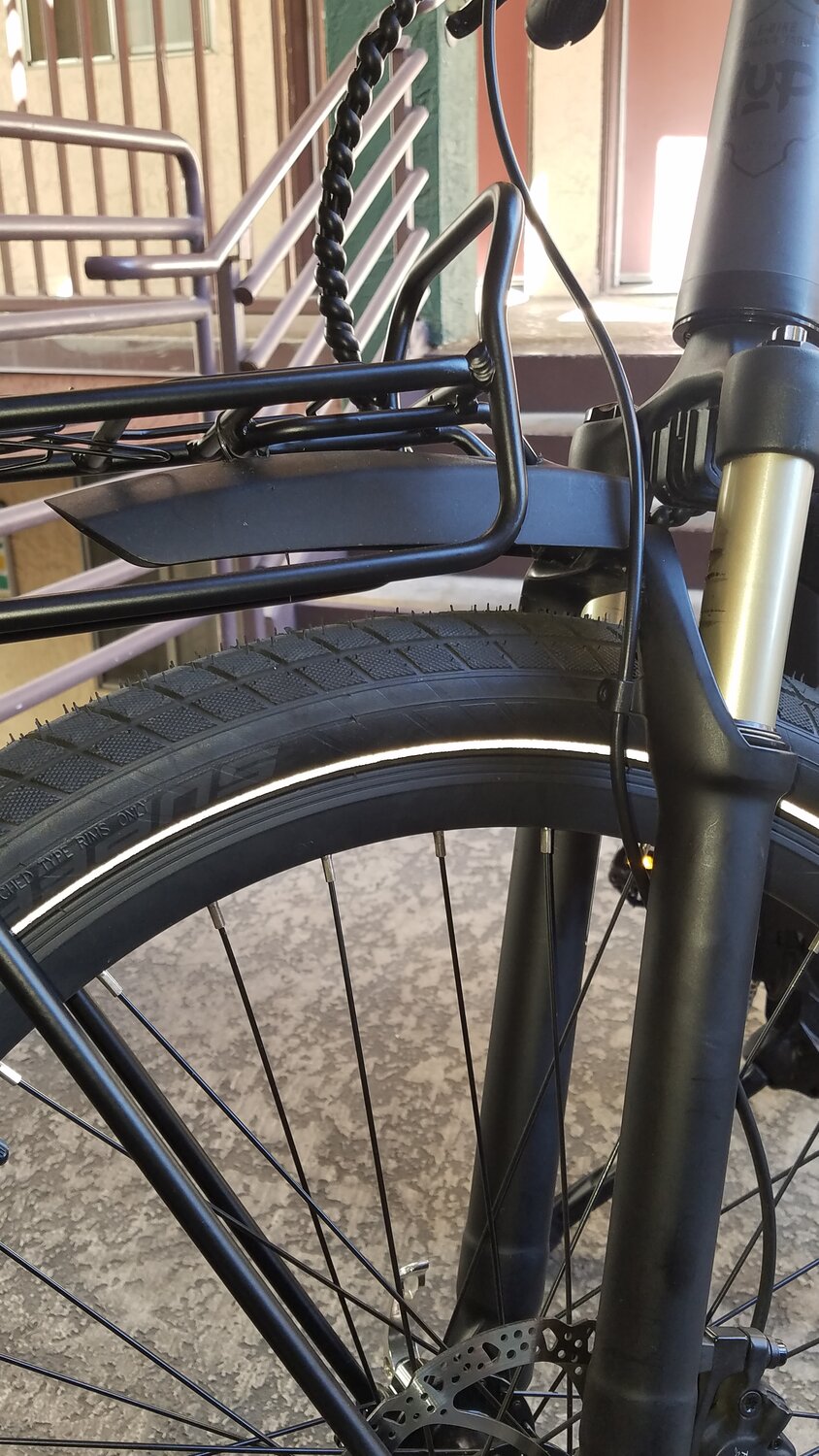

How do you like the shockblade fender?
I had a knock off, mounted in the fork tube and couldn't prevent it from going crooked:mad:
As a 'utility concept' commuter, shopping required multiple cargo carrying options, so a front rack - of little real utility - went with the theme. Mounted by drilling the fork crown and through bolting with an expansion fitting on the backside, it added 1.5 pounds☹️. A great place to attach the front of the front fender tho. lol
I'm seeking a replacement fork, so it'd be nice to find some fenders that worked without my front rack.
