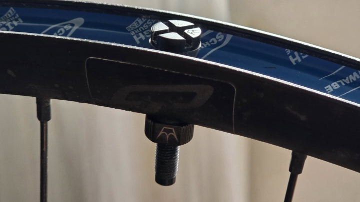

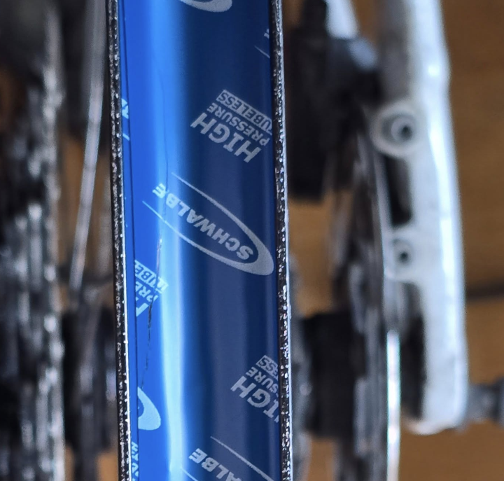

I have been trying for days to do a tubeless set-up on a gravel, adventure, road bike. Normally I can do it with a regular hand/foot pump. I purchased at my personal shop a doughnut pump with 110, psi 8/bar, loud air pump. The rear still wouldn't seal. It has a crack in the AL rim at the joint. What are your tubeless bliss blues? And as a Specialized bonus, you get 5 points whenever you smoke a Vado on your bike, ringing the bell three times and saying 'Overtaking to your left' to a fat guy in spandex and Yellow like he just won the Tour de France,.

Shouldn't any crack be covered in rim tape anyway? Make sure the rim and valves are advertised as tubeless ready and remove the valve core.
I've never had any luck getting a tubeless tire to seat with a normal floor pump.
Also I'd be very skeptical of that cracked rim -- depending on where and how it is cracked that alone may make it impossible to seal. Keep in mind that the reason you use rim tape is that sealant isn't going to plug holes in aluminum or carbon fiber very well.

cracked rim
On that particular rim, opposite the valve is the weld is the seam. That is the leak. And hence my tubeless blues on that bike. I couldn't get to first base with Stan's but a newer product with polymers let me set the bead. Those boost pumps are cool.

When I have time I will take apart that mess and tape at the rim leak with wide flexible rim tape.
