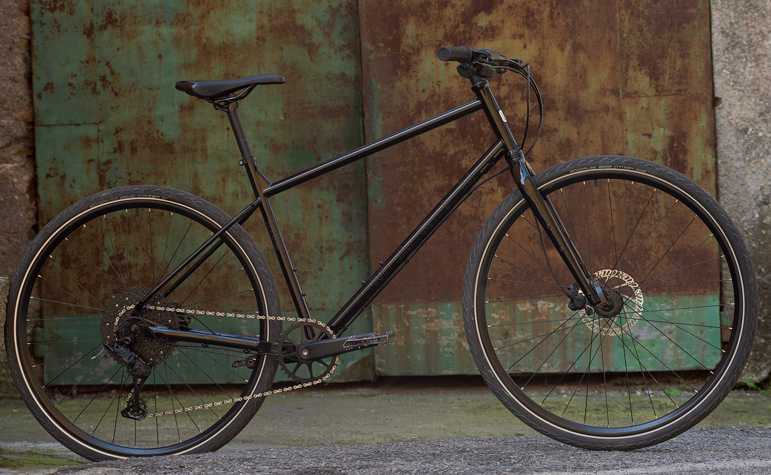

Do any of you commute on a 36v version? I just picked up a Marin Muirwoods recently and I am looking to do a stealth build using a Reention Cuttle battery. I am curious about the Tsdz2 holding up in all weather conditions. My bike will be locked up outside in extreme cold and hot weather. Any incite appreciated

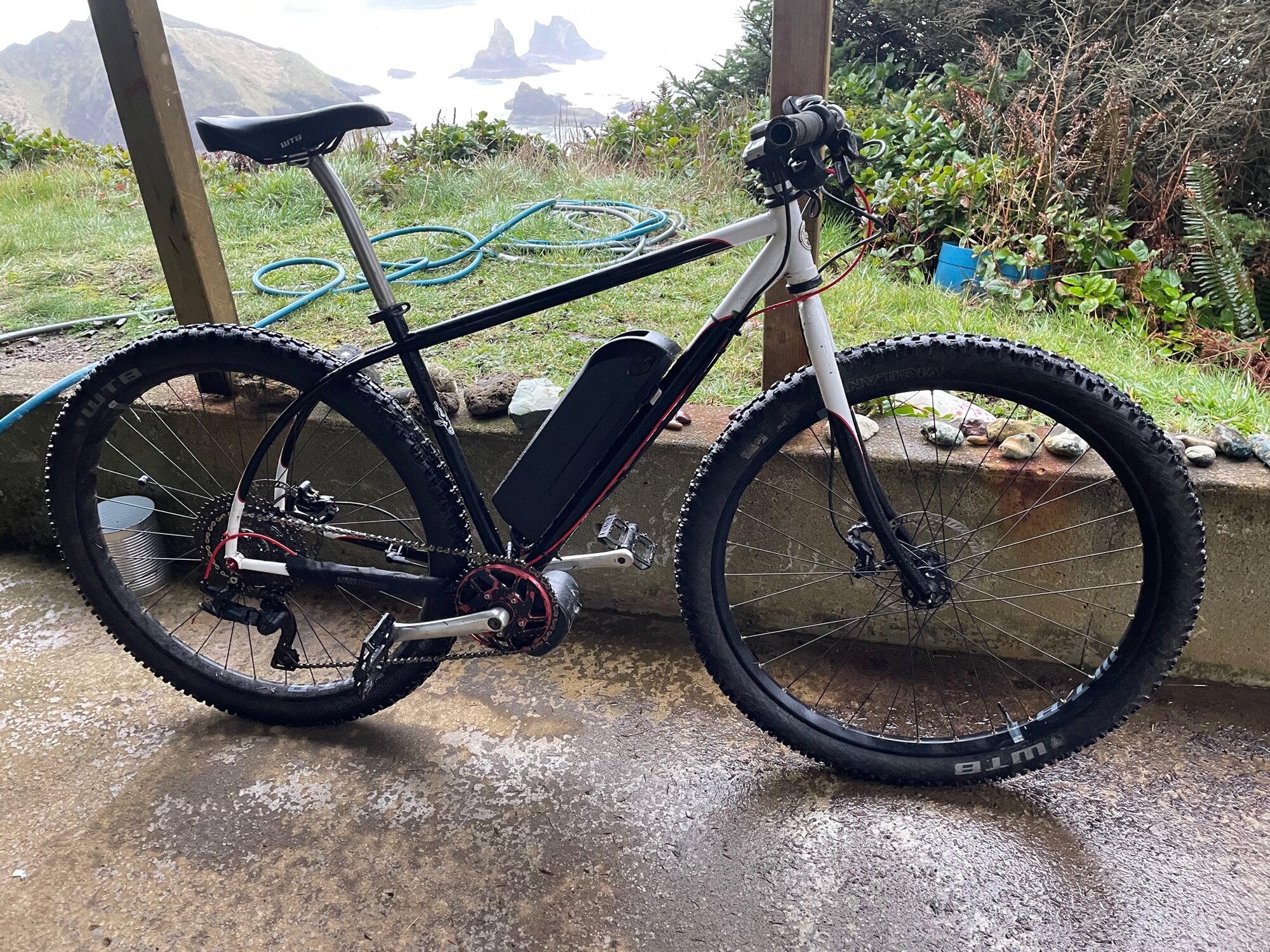

I used TSDZ2 system for like 5 yrs. on mtb's. When I got a more conventional mid drive I still had kit left over as well as a nice frame that had been built up once already.
Although I ran @ 52v/48v I see no reason that a 36v system won't work for your needs. Motors are not totally waterproof but I rode mine numerous times fully submerged in fresh water and when I would look inside there wasn't much moisture evident and some of that could have been condensation.
He has been using it now for 6 months for commuting as well as some forest road forays in search of fish. He is young and hasn't figured out that suspension is beneficial yet and prefers to not have any although it was available and offered. So some plump tires at a lowish psi tubeless is all he gets. Only issue so far was a funky wire connection that occurred where I had spliced the main cable wires to shorten them years ago.
